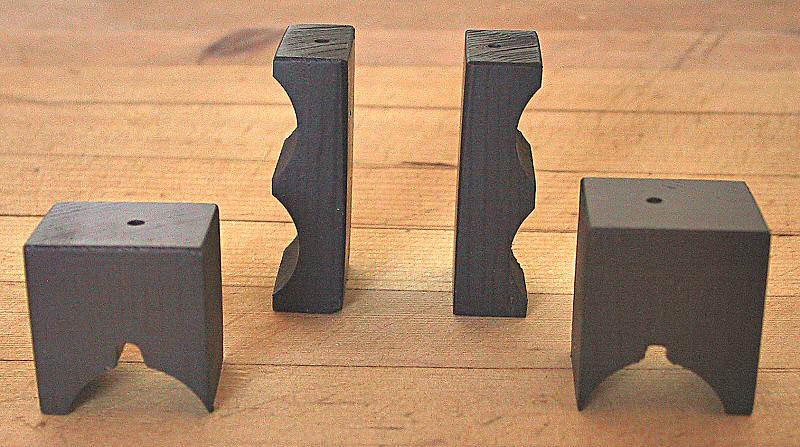

I have the Lansing chassis so adding 6 big Russian teflons was an interesting design challenge. I by-passed C208, C206, and C200, the biggest change was the C208 but following Tubes suggestion I did the B+ supply too.
Not wanting to drill into the circuit board for hold downs, see straps outside the case, or glue everything together, I came up with wood brackets that hold the caps securely when the bottom plate is installed. The bottom has been drilled for new screws that screw into the blocks locking everything in place.
Notice the caps have been shrink wrapped and also the soldered ends have heat shrink tubing so if they shift and touch the case nothing bad happens.
Here are some photos for your amusement.
Wayne

Wayne, the support blocks are nothing less than perfect!
