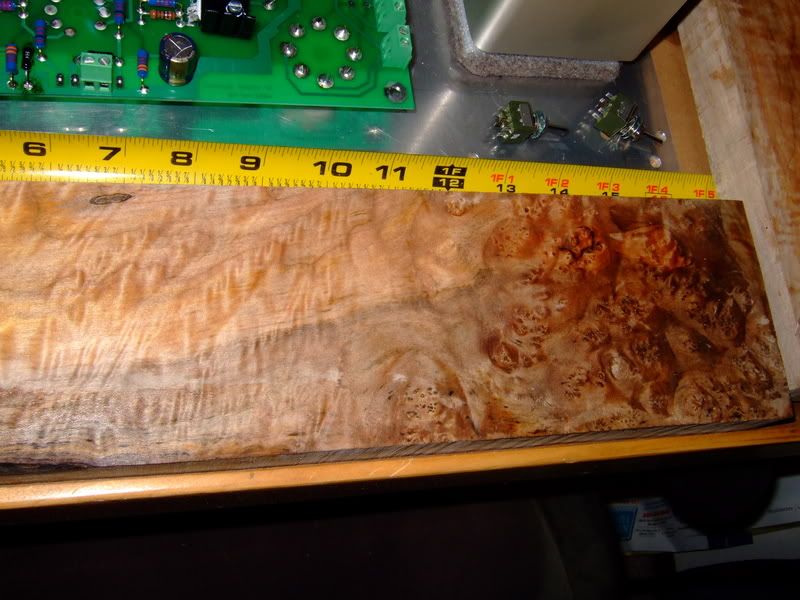

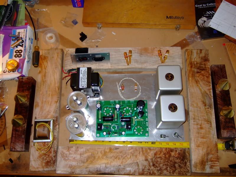

Coming Together...
I'm going to hope the elves put it together for me overnight.  :green:

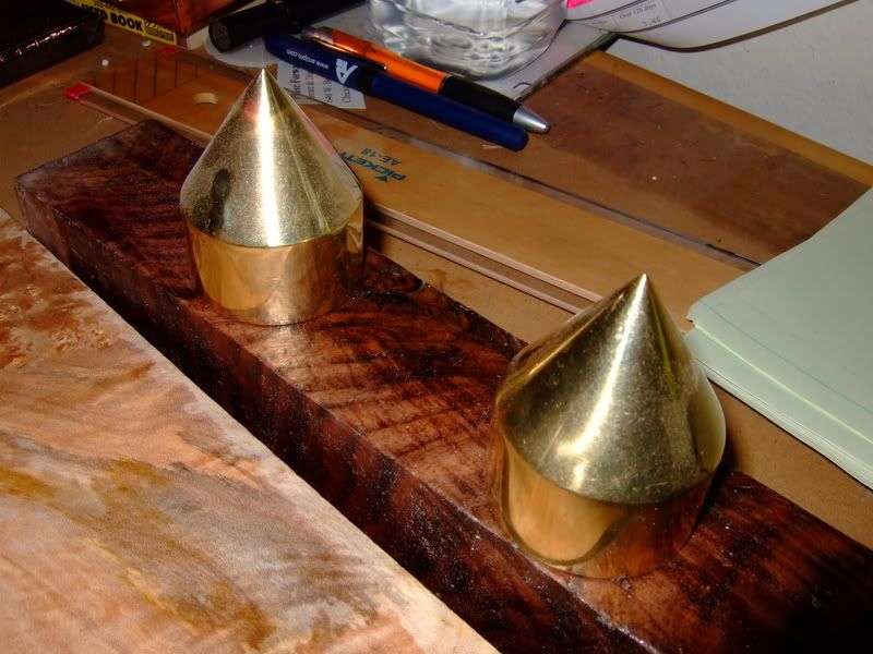

The maple was all one thick board that I resawed on a bandsaw, the walnut will be used in the corners, and I have 4 Harbor Freight 16 Oz plumb bobs for feet. The top sheet is machined, and will be painted. I got the maple wet to get an idea of what it will look like finished. I used terminal strips except for the signal wire, which will be 3 strands of Jupiter silver/cotton wire. Most of the rest of the wiring will be 18 ga silver plated teflon. I made a custom powercord for the amp using 12g silver plated teflon wire. The PT and OPTs will be isolated from vibration using a 3/16" thick pure wool felt gasket. Also, its just a power amp using a JJ ecc99 driver tube, and Tung Sol 6550s.

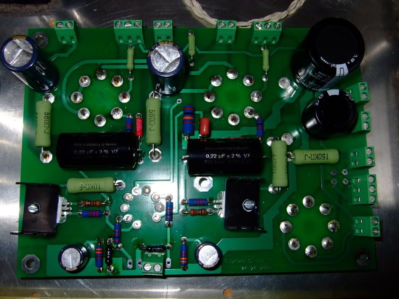

Question: Can I just use motor runs (have 50uF and 100uF) mounted off board instead of the Panasonic electrolytics for C1 and C2? I don't have to use the Pana's and then bypass with mr's right?

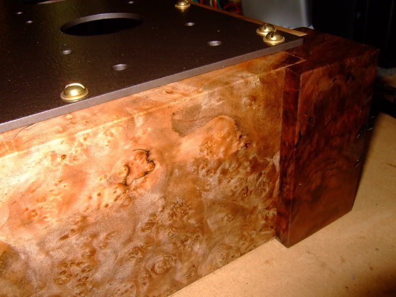

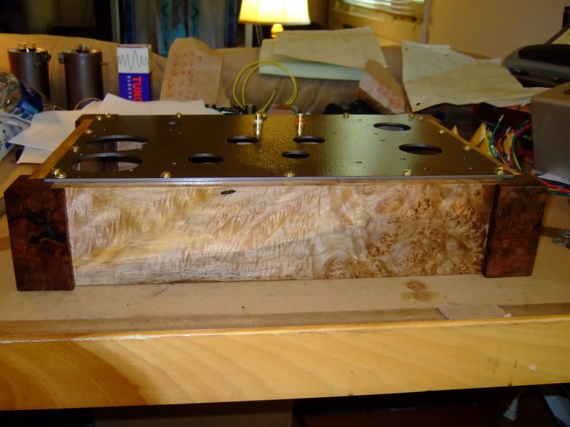

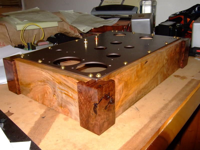

Finally got around to finishing the chassis:
Don, I'm probably not as qualified to answer those questions as others, this is my first DIY tube amp, and its based on a pcb I didn't design.
nodiak
  • Posts: 1083
Re: 6550/KT88 SET amp aka "Uber Beam Machine"
« Reply #248 on: 21 Jun 2008, 10:06 pm »
Good to see your chassis together, looks mighty fine Dave, we have similar wood choices. Interested in your layout, motor runs on top right? Looks like you might be listening soon. No problem, I'll clear up my build questions at diyaudio where George hangs out.

« Reply #250 on: 21 Jun 2008, 10:38 pm »
Don, yep... the motor runs are on the right, opts on the left. I'm mounting the motor run caps with the clamps under the top plate for a little bit of a cleaner look. I'd be interested to see what the options are for replacing the electrolytic caps, and if its worth doing... maybe just adding smaller value film bypass caps would help in some places?

Don,
I will be using no electrolytics in my amp at all.  I have two 100 uF motor run caps to replace the 120 uF electrolytic, 1 40 uF to replace the 47 uF electrolytic, and 4 film caps for cathode bypasses -- 75 uF 250 v for the driver tube and 39 uF for the output tubes.  Amp will be hardwired in UL with no CFB, standby  or Rectifier switches, and I may put in a dpdt switch for switching the gain stage cathode bypass caps in or out of the circuit.
I am also building a slightly different type of chassis starting with a steel hammond chassis and bolting that to a slab of maple butcher block countertop or some such thing.
Our other local guy got his amp working yesterday after a little issue with a bad rectifier tube shorteed out and took out the diodes (better that than the PT).  I haven't heard it in person yet, but he's a happy camper.

Jim, So the values of C1 and C2 don't need to be 120uF and 47uF? Maybe I should make C1 more than 100uF? C2 at 50uF should be fine I'm guessing.

Don,
Nope, 200 uF for C1 would not be too much (as George describes an amp with a 120 uF electrolytic and an 80 uF motor run, which is in parallel with the 120 uF cap).  You won't want to go over 50 uF on C2 as this is the load capacitor that the rectifier sees and 50 uF is getting near the top of it's range.  The 50 uF will also probably give you a slightly higher B+, but probably not enough to worry about it.
The Axon film caps are available in 250 volt, which most film caps of this size are not -- they're usually at least 400 v and much larger physically.  With this low-profile chassis (less than 2" to work with inside the amp) I might have to go with something like blackgate NXs for the output tubes., and 100 uF will give you a cutoff frequency of about 5 Hz.  The 100 volt rating you have for the output tube cathode bypass caps is fine, and you only need 6.3 v rating for the gain/driver tube
So, in short, more capacitance for C1 is fine (within reason) but don't go over 50 uF for C2.

I'd model the choices for C1 and C2 in PSUDII.  You don't want ringing on a step change in current but you also want low ripple and no overshoot on power up.  Quite often ideal capacitance is a bit less than many like to use.  Small changes of +-5uf usually don't make much of any difference depending on which position the cap is in (after the first choke usually is less sensitive).   You do have to be careful to not oversize the first cap because of your recitifer.
I have generally found that waveform of the ripple looks much nicer (in PSUD) with only a very small cap on the input (<1uf), then the choke, then the big cap after the choke.   This also will produce less EMI generation and puts less stress on the rectifiers.   I think that is why many tube amp builders swear by choke input.
