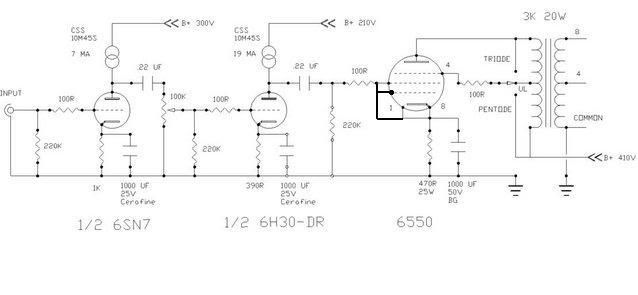

Need a bit o help with the circuit.... Have I done my homework? It makes sounds but not music.
Need constructive critisism, corrections etc....
Thanks..
JD

jeffdavison
Re: 6550/KT88 SET amp aka "Uber Beam Machine"
« Reply #305 on: 27 Jul 2008, 08:38 pm »
Bill,
Not quite sure you put all my numbers in .
Tranny is different as well as cap and resistor values, so I really don't know how to interperet or apply your model.
Also there is nothing showing the input and driver stages, which are also a very big concern at the moment also.
Thanks
Jeff

I'm guessing you're using resistors at the base and emitter of the ccs that are not shown on the diagram?
jeffdavison
« Reply #308 on: 27 Jul 2008, 09:00 pm »
the CCS for the 6SN7 uses a 470R to set the 7ma. (and a 1K off the G terminal) , the CCS for the 6H30 uses a 100R to set the 19ma. (and a 1K off the G terminal)
JD

ok, but it looks like 100r will give more like 25 mA (looking at the chart on the ixys datasheet)... minor issue though. I can't see anything obvious... maybe check the signal between stages to try to narrow down where the issue is?
also, isn't the 3rd screen usually connected like this?:
Dave

« Reply #310 on: 27 Jul 2008, 09:48 pm »
Can you be a bit more specific about the sonics?
Without being able to see the schematics, I'm guessing that the problem lies somewhere between the 6sn7 and the 6h30. Possibly the wrong type of attenuator?
First things I myself would try would be to lose the CCS on the 6sn7 and wire a pot as in the kit2 schematic.
If you're using CFB, take that out as well -- you will not need it with the Silk transformers.
FWIW
-- Jim

Dave,
the 100R inputs the 6550 at pin 5,
the 100R drid resistor is from pin 4 to the mode select switch.
Drawing is a bit misleading, but the pins are correct.

Sound is very distorted, perhaps I blew the output transformer? I accidently inhte very early testing put a 720 voltage where I thought it was a 360. ( a big boo boo about center taps and the use of Greatz bridges..)
The CCS on the 6SN7 is like Pimms example, with a little more juice..http://www.pmillett.com/current_source.htm
It already is except the 220K aftwards instead of the 470K
Jeff
FWIW
-- Jim

« Reply #313 on: 27 Jul 2008, 10:29 pm »
Well, that certainly can't help anything, but if it were only a brief exposure to the higher voltage, most transformers can usually withstand 2kv between windings, so it is unlikely that you have a short between windings -- but I suppose anything could happen.  Did you make any basic resistance measurements on the transformers to see if there was anything obvious?  This won't always eliminate a problem if they check out, but it's a place to start.
My wild and wooly guess is that perhaps you are overdriving the grid of the 6h30 and making it behave like a diode and clamping part of the waveform.  Again, only one possible explanation.
If you've got a scope, I'd get in there *carefully* and start looking at various points along the signal path.
That's about all I can really offer without being able to see the schematic, so I'll have to let the more experienced guys chime in here.
Good luck -- at least there were no pyrotechnics :-).
-- Jim

Sent you the full shems via email.
I'm too novice yet about having or using a scope to check circuitry.
Resistance measurements are about the same across the winding comparing each transformer to the other on the primary and secondary sides. If I had a virgen set I could compare against it. I do have another pair in transit to build another amp. I need to debug this one first before I start that one.
Jeff
-- Jim

full schmatic
JD

Either your diagram or pin numbers are incorrect.
You are feeding your signal into the incorrect screen on the output tube. Your diagram shows the signal being fed to G2. The signal should be fed into G1. G2 is where the UL tap would go.
Connections should be.
pin 1 is connected to the outer metal base (internal)
pin 5 is your G1
pin 4 is G2
pin 3 is plate / anode
pin 8 is your cathode
pins 2 & 7 are your heaters
pin 6 has no connection
The basing of the 6550 is 7AC. You need to double check everything.

Yeah, as Andrew said, you are screen driving the output tube according to that diagram, which requires very different bias points and a different tube.  I am not sure the 6550 can be screen driven nicely.  3K is also pretty low for a 6550 I think.  We are using 5K typically.
Have you checked voltages?  Did you check the PSU voltages?

ok,
don't look at anything inside the 6550 "circle" It's the pins that tell how the circuit is wired.
checked voltages with all tubes being driven.
B+ to the 6550 / OPT Traffo is +400 to + 420 (depending on which rectifier I use....5V4g, 5AR4, GZ32
B+ to the top of the 6SN7 CCS is +300
B+ to the top of the 6H30 CCS is +210
JD

Andrew... here's the corrected 6550 internals. Pins are connected to rest of circuit are the same.
Jeff
pin 5 is your G1
pin 4 is G2
