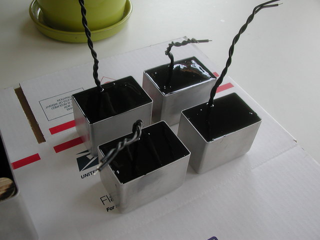

Once the first was done, the next one was a breeze, as all the r&d has been done and the drawings were finished. I use the toner transfer method to make my pcbs, so all I have to do is print them out with my laser printer and iron the drawing to the copper clad. If I get enough demand, I'll get some professional pcb's made up. Many places can make small runs for cheap, but nothing beats the convenience of just printing them up at home... very easy to make changes in the design on the fly if needed.
The top, front and rear plates are from Front Panel express, and since the drawings are done, it's a simple matter to hit the enter key in their program to place an order for them and wait a couple weeks for delivery. Table saw in the basement and gluing jigs I made for the first amp and router jigs I made as well make the going real easy once I have a nice piece of Rosewood in hand.
When I potted the chokes, I inserted some rectangles of wood between the choke ends and the wall of the case. You can see this in the pics. Just a fair warning... potting compund is not cheap!. About $40 for the toroid and two choke cases worth.  After potting, I simply drilled some hole and they are mounted to the top plate with wood screws. For the big potted toroid, I used cut down maple dowel rods in the corners before potting as the round toroid in the square case left the room needed. Wood screws worked very well also.

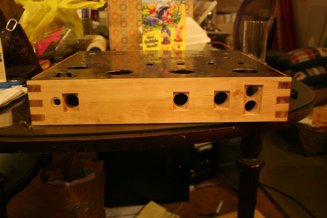

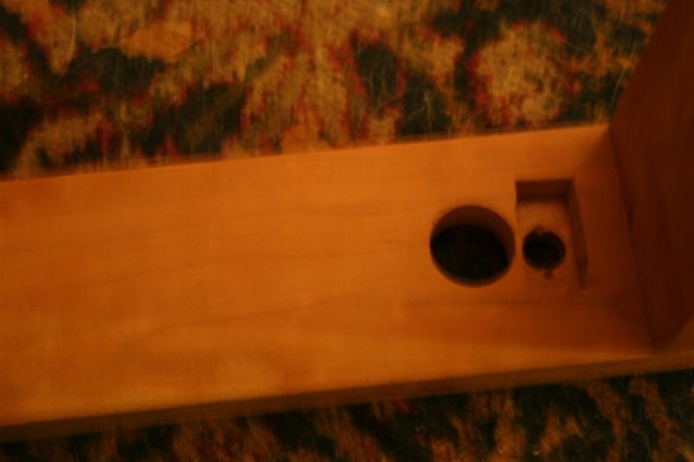

« Reply #346 on: 9 Sep 2008, 02:34 am »
baby steps...
rough sanding done.
the back side with connector sockets drilled out.
I did a bit of chiseling so that the neutrix connectors are flushed into the back.  I had to take quite a bit wood out in order to fit the breaker switch so that I can actually screw on the fastening nut, but it worked.
JoshK
Re: 6550/KT88 SET amp aka "Uber Beam Machine"
« Reply #347 on: 9 Sep 2008, 02:37 am »
Now I gots to do some fine sanding and then learn how I want to finish this chassis.  Thinking shellac.  Not decided yet.

JoshK
« Reply #349 on: 9 Sep 2008, 03:33 pm »
Thanks Jeff.  I'll keep that in consideration.  I wonder if it is anything like Crystallac which a lot of guys like to use on guitars for similar reasons.

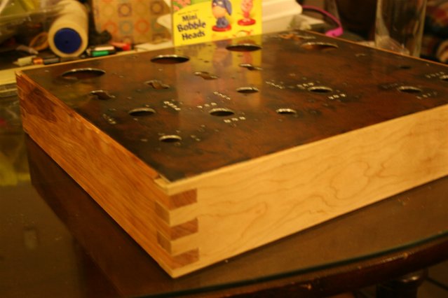

JoshK
« Reply #359 on: 18 Oct 2008, 03:21 am »
Cool Steve,
Are you going to give us any details?  Like what kind of amp is it, other than tube?
I started the shellacing of my chassis.  Here's hoping it turns out.
