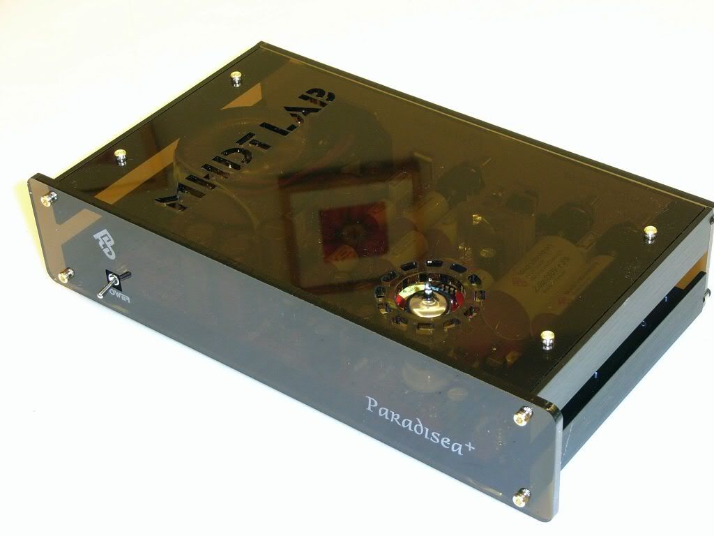

My Paradisea had an on/off switch on the front like the one in this photo.
Maybe i've missed this amongst the 28+ pages here ... but whats the diff between the regular paradisea
and paradisea+? I bought the non '+' version a couple of months back direct from MHDT.
