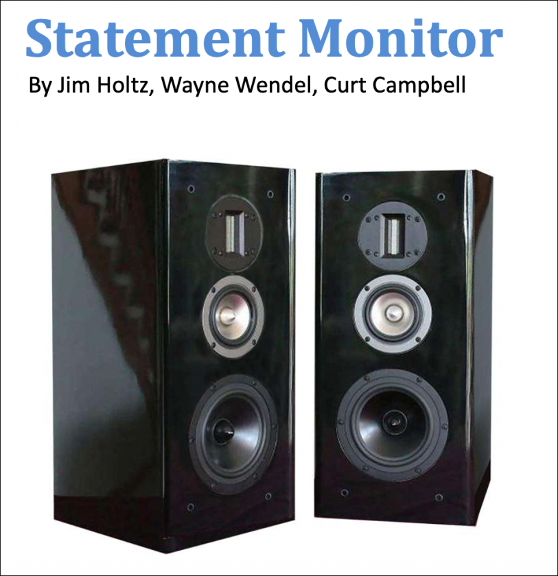

I came across some DIY speaker design plans at the place called Speaker design works.
Here it is a 3 way monitor with a Tang Band 4" as an open back that crossover from 500Hz - 4kHz.
This looks like an interesting build.
Any have some experience with this?
https://www.speakerdesignworks.com/statement-monitor

I have built almost every speaker in the statement family.  What specific questions do you have?

I have in the past built the statements, the statement 2, the statement center, the statement 2 center, the statement monitors, the mini statements, and the micro statements.  These are all older designs so make sure you check driver availability before building them.  My speaker progression has been away from box enclosures and now into open baffle.  The pass through with the midrange drivers on the statement line does make a noticeable difference in depth (sound stage).  If you can get them out into the room it helps.  I thought the entire statement line offered a solid home theater performance at a good value.  For music they sound ok.  There are better sounding designs out there.  Depends on your budget and what you plan to use them for.  I used upgraded crossover parts.  I had to beef up the crossover significantly as I had a few failures.  The main inline resistor on the mid circuit in the statement got really hot and burned open.  I ended up using 4 wire wound resistors in parallel to give it more power handling.  If you are going to music and want “open” sounding stage take a look at the NX line on GR research diy kits.  They sound great.

All speakers have some limitations. For the statement lineup I thought they sounded pretty good as an all-around speaker for both home theater and for music. The limitations I encountered were tweeter dispersion and midrange performance.  They have excellent horizontal dispersion virtually no vertical dispersion. Unless you’re sitting down in the butter zone, they don’t sound their best. I thought that the mid range drivers were a little bit small. They lacked the visceral impact of dynamic instruments like snare drums. I felt they just didn’t give me that visceral pop that I really was looking for in a live performance. They excelled in bass response and overall versatility with home theater.  I feel they were a good value. I used them primarily for home theater. Once I started getting more into stereo music, I thought I needed to move to something that offered something more.  Thats when I started building open baffle speakers.

Its beyond my understanding why.this speaker is a 3-way design even using a very small woofer that could easily run up to 4000Hz what could be a cheaper and simpler 2-way design with less parts in the x-over and less the midrange driver.  :duh:

Need some speakers that can be standmount and give great hifi experience. i was also thinking about NX studio + a sub as this dont really have much down in the low octave.
The stetement monitor looked to be some that could handle the base also.
