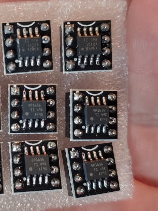

OPA1656
A lot of ink has been spilt over the FET-input OPA1656 as one of the top-tier modern monolithic opamps.  Its specs are impressive and many positive comments can be found, some saying some of the Virtual Hifi hi-end opamps are paralleled OPA1656.  My own testing has been a bit underwhelming possibly due to high expectations.  My main issue was that the midrange and vocals just didn't sound rich and dense enough for my tastes.  Combine that with the typical opamp characteristic of well-lit upper frequencies, we have a mild V-shaped tonality, which may fit better with certain other tastes and systems.  This evaluation may be somewhat unfair since I have been listening to some of the finest discrete opamps of late, so If I can figure out a good way to parallel these SOIC opamps, I may try that in the future.
OPA1612
Another top-tier monolithic opamp often mentioned in the same breath is OPA1612, and surprisingly, OPA1612 sounded quite different from OPA1656.  OPA1612 is a bipolar-input opamp with noise figures better than OPA1612 and even OPA828.  Whatever the reason, it sounded a bit more filled out tonally in the midrange with slightly less lit-up upper frequencies compared to OPA1656, sounding more balanced and involving to my ears.  As far as monolithics go, this is a good one and worth having in one's toolbox.

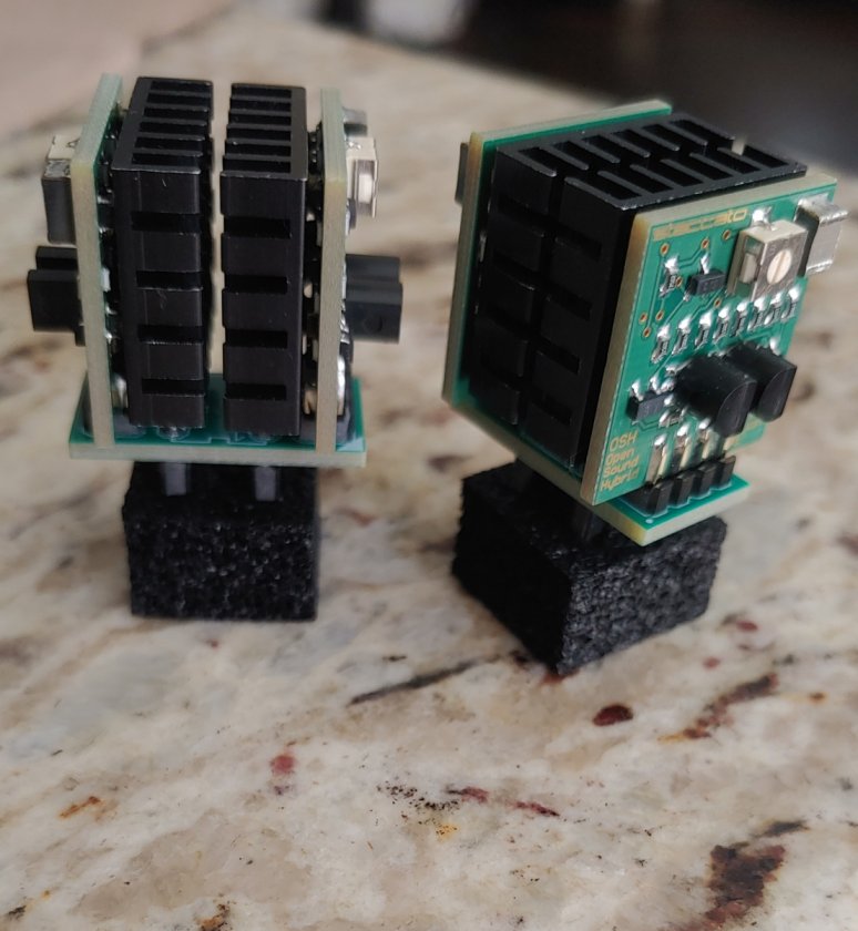

Staccato OSH-DHb discrete Opamp
Sometimes the manufacturer literally tells you exactly how their opamps sounds.  From Staccato:  "J-FET, in both input and output stage, in combination with high bias current, had result in low Open loop distortion with dominating of [second] harmonic."  Yup, this opamp does sound like there is a helping of second order harmonics, lending a bit "wetter" sound and a feeling the room temperature is a bit warmer.  I can see many tastes and systems would love this sound, as people spend big bucks chasing this signature via things like high-end tube gear.  The fact there is still great amount of detail available, albeit in richly velvety and smooth sonic fabric is a great plus.  Staccato reminds me a lot of the super musical NewclassD Ultimate MkII discrete opamp, both of which would synergize especially well in systems that lean a bit much into the "neutral, straight-wire" camp!
