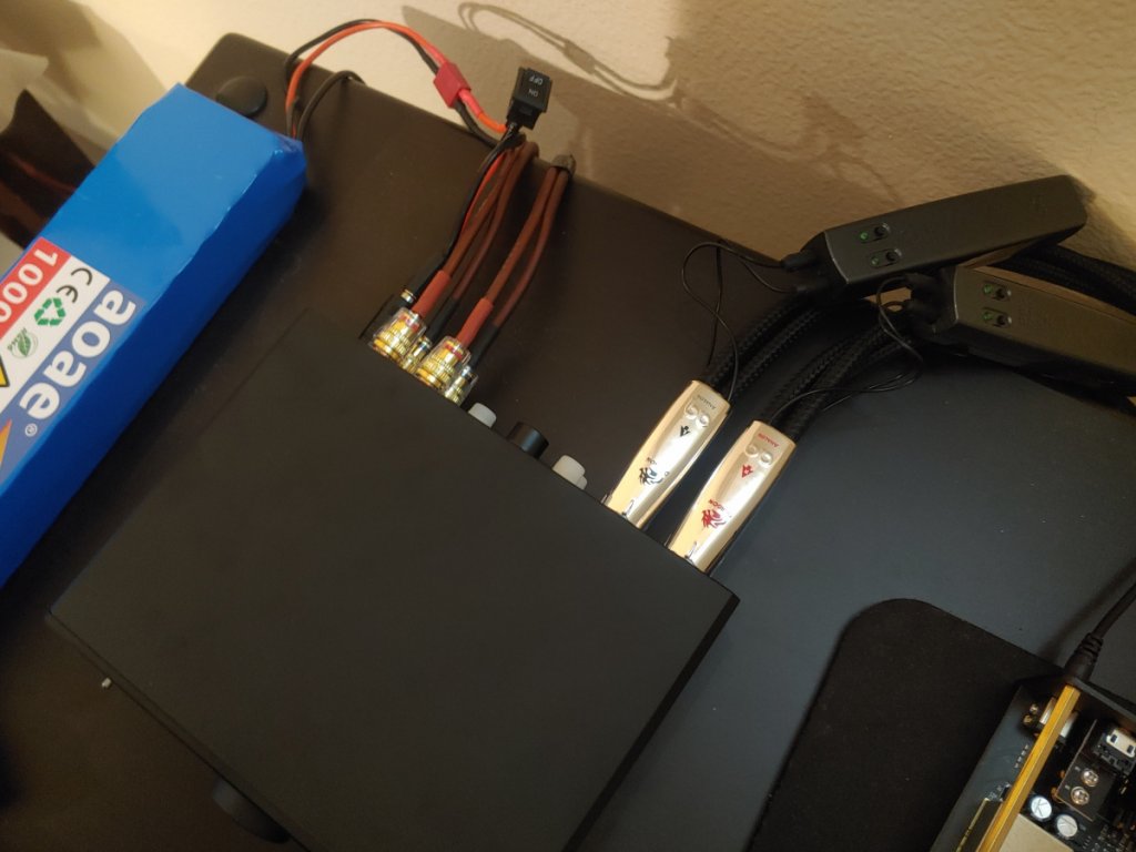

Bone stock, the Aiyima does sound a bit better to my ears, a smidge smoother with finer textures.  Still, neither will make it into one of my permanent systems without some additional help.
More specifically, the main thing that elevates these amps from "good for class D" to "does music justice" seems to be a better power supply.  The stock 48V/5A GaN smps power supply is the same for Aiyima and Douk and does a good job really, but the last 5-10% that keeps you involved and engaged in music is not quite there.
Both amps benefit significantly from being powered by 36V Lithium battery, which reveals more detail and clarity while paradoxically making the sound warmer and more forgiving.  There is just more musically relevant vividness to timbre and tone that pushes the amps across the threshold of daily usability.

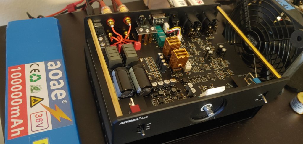

Another reason may seem like an odd one, but it's the "Bypass" button present on A20.  It's not clear to me what exactly is bypassed, but in non-bypass mode even with the volume knob at max, the sound is significantly different from bypass mode.  I wonder if this is the effect of the physical volume pot just in signal path or something else is involved, but the difference is at least as large as changing cables or opamps IME.  This is a plus in my mind because one essentially gets two different amps in one.  I can press the bypass button (3 sec) while music is playing without any ticks or pops, enabling instant A-B comparisons.  Bypass mode does give you more detail, especially in treble and upper midrange, but this is a double-edged sword when it comes to poorly-recorded music from early days, which sound "better" in non-bypass mode.  As expected, shaving off a bit of treble energy results in midrange sounding richer and more forgiving.  I wish Douk had this bypass button.
In addition, Aiyima comes stock with nicer replaceable opamps (LME49720), and one need not replace them to get good sound out of box.  The fact it also has seven (!) non-replaceable opamps (NE5532) is both a blessing (money-wise) and curse (inflexibility).

Another plus is the glass lid on top for easy opamp rolling.  I really wish Aiyima had this feature because it is a pain opening the case to roll opamps, and the tight space inside Aiyima does not allow many of my expensive discrete opamps.  For Douk, I can install huge opamps without opening the case by leaving the glass lid off.  This is quite necessary because Douk A5 does not sound excellent with stock NE5532 amps in sockets (with stock power supply).

SPARKOS SS2590 PRO
I installed Sparkos SS2590 Pro opamps in Aiyima A20 using various trickery including bridges, flexible extenders, and using the chassis as bottom heat sink.  What a pain but it sounds like I added a couple of bass woofers to the system  :thumb:
After more rounds of laborious opamp rolling, my conclusion is that if one does not already have Sparkos SS2590 Pro in the system, using them in Aiyima A20 will simply transform the system to the next level, especially in terms of Niagara Falls level of dynamics, flow, and naturalness.  It's like you are upgrading your garden hose to twice the diameter for music to explode through.
