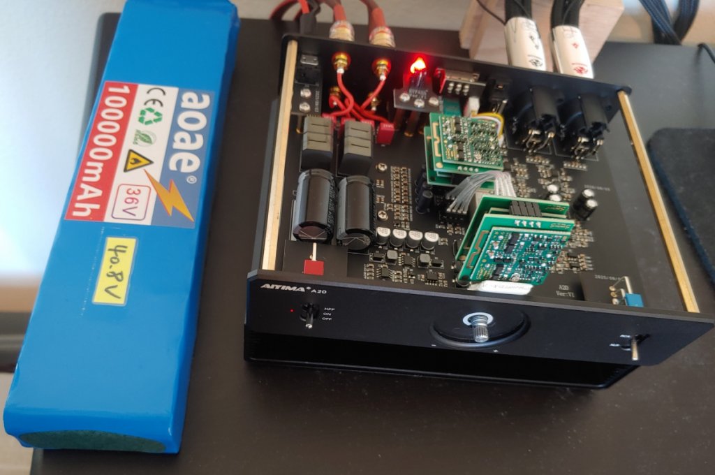

More specifically, the main thing that elevates these amps from "good for class D" to "does music justice" seems to be a better power supply.  The stock 48V/5A GaN smps power supply is the same for Aiyima and Douk and does a good job really, but the last 5-10% that keeps you involved and engaged in music is not quite there.
Both amps benefit significantly from being powered by 36V Lithium battery, which reveals more detail and clarity while paradoxically making the sound warmer and more forgiving.  There is just more musically relevant vividness to timbre and tone that pushes the amps across the threshold of daily usability.

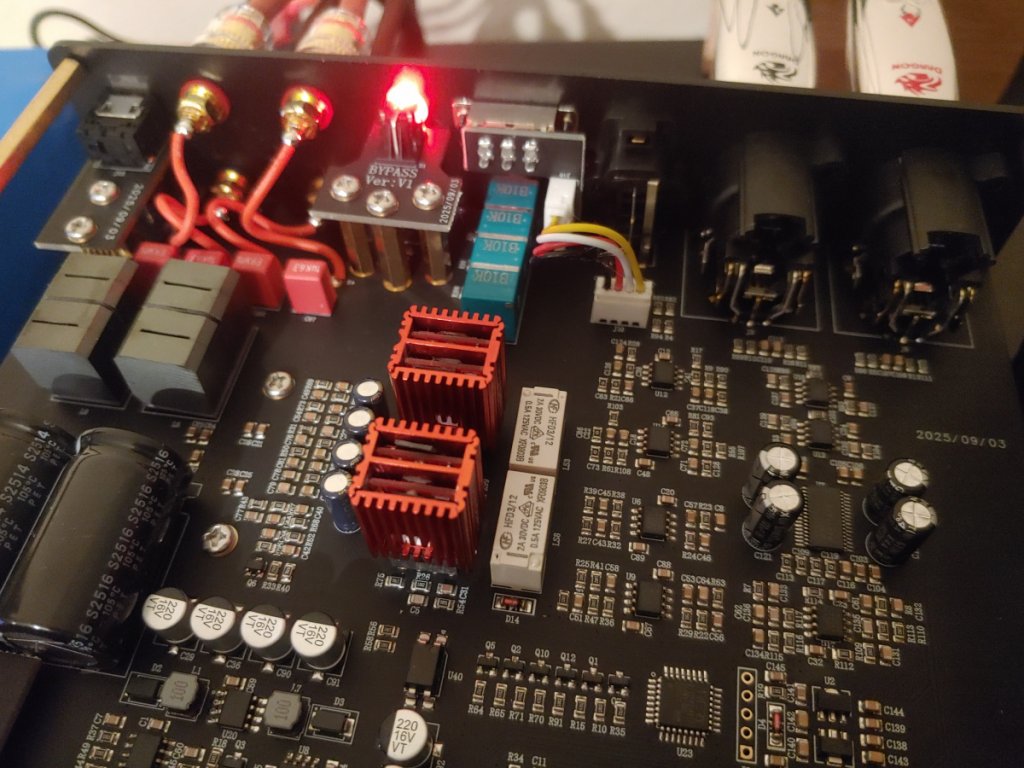

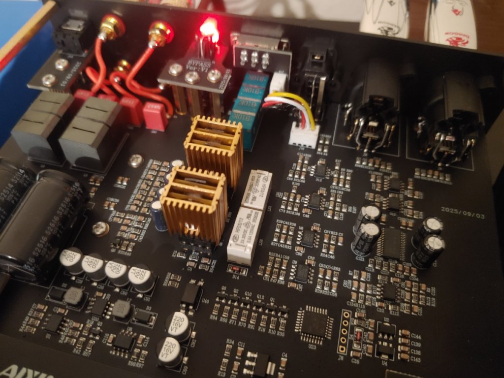

Another reason may seem like an odd one, but it's the "Bypass" button present on A20.  It's not clear to me what exactly is bypassed, but in non-bypass mode even with the volume knob at max, the sound is significantly different from bypass mode.  I wonder if this is the effect of the physical volume pot just in signal path or something else is involved, but the difference is at least as large as changing cables or opamps IME.  This is a plus in my mind because one essentially gets two different amps in one.  I can press the bypass button (3 sec) while music is playing without any ticks or pops, enabling instant A-B comparisons.  Bypass mode does give you more detail, especially in treble and upper midrange, but this is a double-edged sword when it comes to poorly-recorded music from early days, which sound "better" in non-bypass mode.  As expected, shaving off a bit of treble energy results in midrange sounding richer and more forgiving.  I wish Douk had this bypass button.
In addition, Aiyima comes stock with nicer replaceable opamps (LME49720), and one need not replace them to get good sound out of box.  The fact it also has seven (!) non-replaceable opamps (NE5532) is both a blessing (money-wise) and curse (inflexibility).

Another plus is the glass lid on top for easy opamp rolling.  I really wish Aiyima had this feature because it is a pain opening the case to roll opamps, and the tight space inside Aiyima does not allow many of my expensive discrete opamps.  For Douk, I can install huge opamps without opening the case by leaving the glass lid off.  This is quite necessary because Douk A5 does not sound excellent with stock NE5532 amps in sockets (with stock power supply).

I currently have stacked LME49720 running inside Aiyima A20, which is not THE top opamp but works great as second opamp after getting signal from the source's Sparkos SS2590 Pro.  If I use SS2590 in both source and amp, its "flavor" getting doubled may be too much of a good thing for certain systems.  Same goes for many/all(?) opamps IME.

Darn it.  I ended up ordering some OPA1656's to try paralleling.  We'll see if it's got any useful advantages over paralleled LME47920 or 5532.  In the meanwhile, installing Decoupling capacitor boards on Burson V7 is making that *small* but meaninful difference in presentation, mainly turning Burson's extra "presence" into more natural resolution and calmness.
Sparkos SS2590 pro in the source/DAC followed by Burson V7 Classics on Decoupling capacitor boards in aiyima A20 amp is an excellent combo  :thumb:

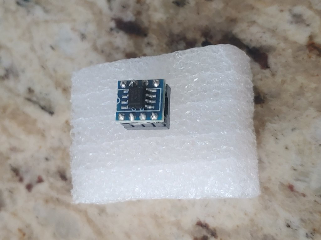

OPA1656
A lot of ink has been spilt over the FET-input OPA1656 as one of the top-tier modern monolithic opamps.  Its specs are impressive and many positive comments can be found, some saying some of the Virtual Hifi hi-end opamps are paralleled OPA1656.  My own testing has been a bit underwhelming possibly due to high expectations.  My main issue was that the midrange and vocals just didn't sound rich and dense enough for my tastes.  Combine that with the typical opamp characteristic of well-lit upper frequencies, we have a mild V-shaped tonality, which may fit better with certain other tastes and systems.  This evaluation may be somewhat unfair since I have been listening to some of the finest discrete opamps of late, so If I can figure out a good way to parallel these SOIC opamps, I may try that in the future.
