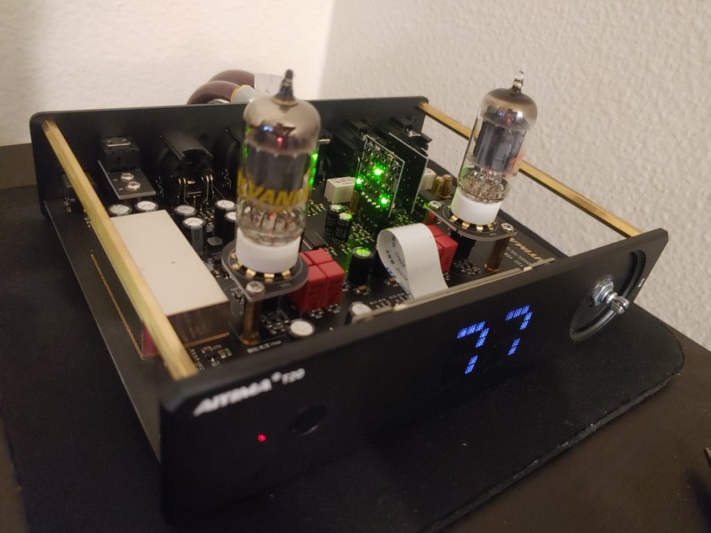

3 opamps are located right next to respective XLR and RCA outputs.  If you use XLR outputs, you would swap 2 opamps next to XLR connections.  If you use RCA, only need to swap one opamp next to RCA connection.

Just received it.
First thing I did is unsleeve it so it's ready for op amp swap.
Didn't bother with the PSVANE and went straight to a pair of RCA 12AT7.  And, using HDPlex 300's 12v fixed output.  I think it's 10amp.
It's only been plugged in for 15 minutes.  It's pretty transparent.  Doesn't change the sound TOO much.  It does add a layer of thickness same way the Douk preamp did but doesn't come close to overdoing it like the Douk did.  I think I am losing a tinge of air and sparkle.  Still getting used to the sound.
Can't wait to start op amp swapping.  The LME is sounding OK at the moment.
I bought this mainly to have a second output for the sub.  Less need for it now as lows are now a bit meatier too.

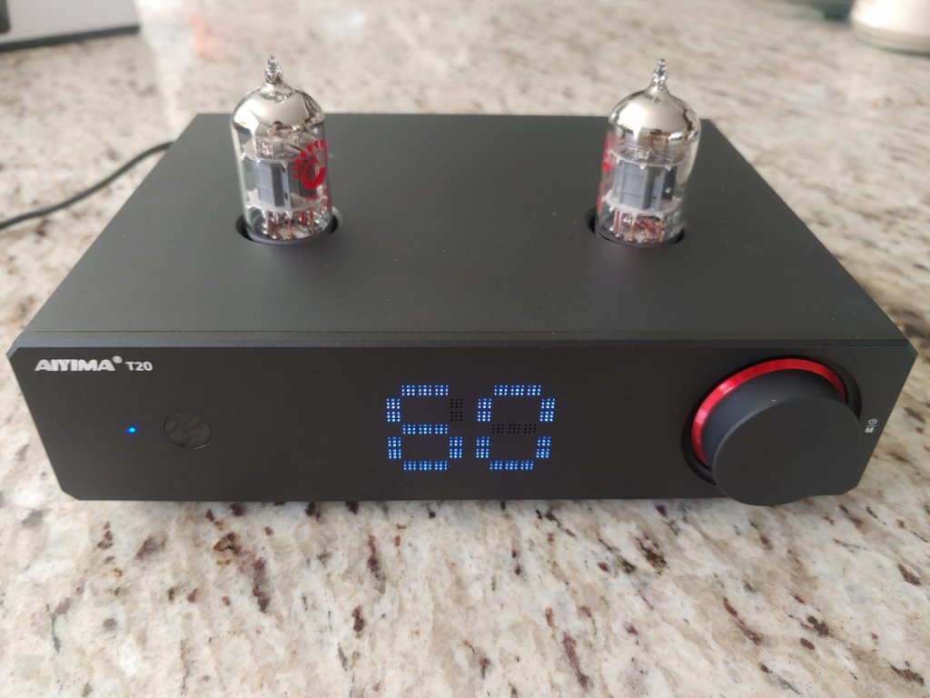

viggen
That "LME is sounding OK" opinion didn't last long.  After a few hours, I thought the preamp sounded a bit closed in and artificial.
Swapped in MUSES02.  Instantly, sound is relaxed, opened up and a touch more mellow.
A few hours after that, I thought the sound is a bit dark.  So, swapped out the RCA for GE 6829.
I had always preferred the RCA over GE in other aplications.
The GE is more balanced sounding in this application.  Before swapping over to GE, I didn't think the sound with preamp in loop is better than without it.  Now it seems on par.

quickly swapped in Sylvania 12AT7WA and RCA 12AT7WA.  Still prefer to GE.  Sylvania was particularly bad.  No tone at all.
