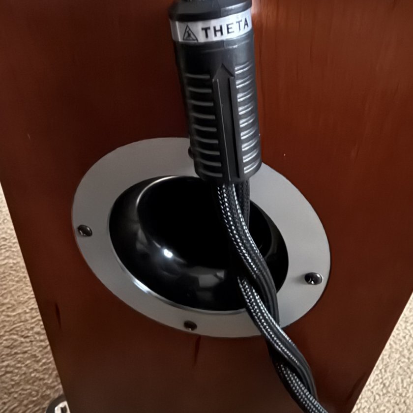

Frederick had the idea to "reverse the port" to see what happens... well, it got better.
Then I remembered I have large 4" ports that will be used in the Duelund Coherent Audio Monitors we are building... how about those?
Well, it got even better - Deeper Bass / less mid-bass HUMP.
Hey, how about putting a little fiber fill in the port?
Yep, even better.

However, when testing the longer ports I was about to make it much better without using sub phase to "fix" anything.  By playing with the port and "making the enclosure larger", it helped with the HUMP, all by itself.
Just eyeballing it, the volume of that 4" OD port is a significant % of the volume of the cabinet for that Scan-Speak woofer driver.
This is a different speaker (better) with that 4" port tube attached over the hole in the cabinet.  It is what it is.
The 8" woofers in my Duette have no trouble playing well and deep in this same room and this speaker shouldn't either given the driver that's in it.

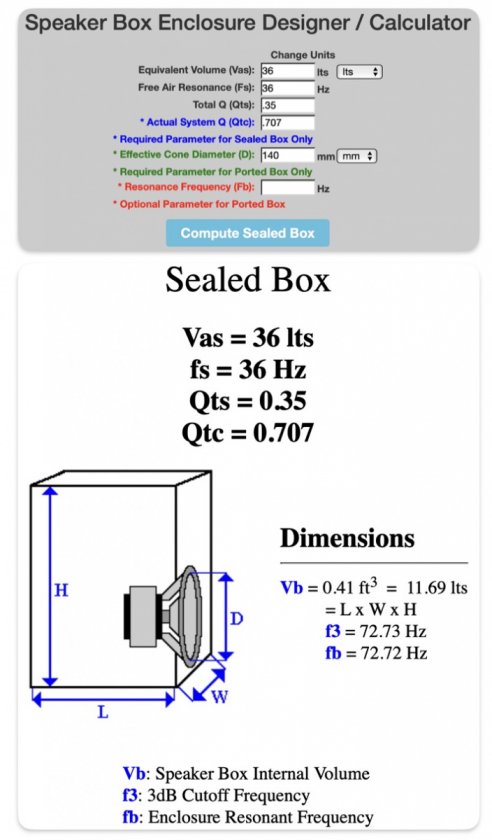

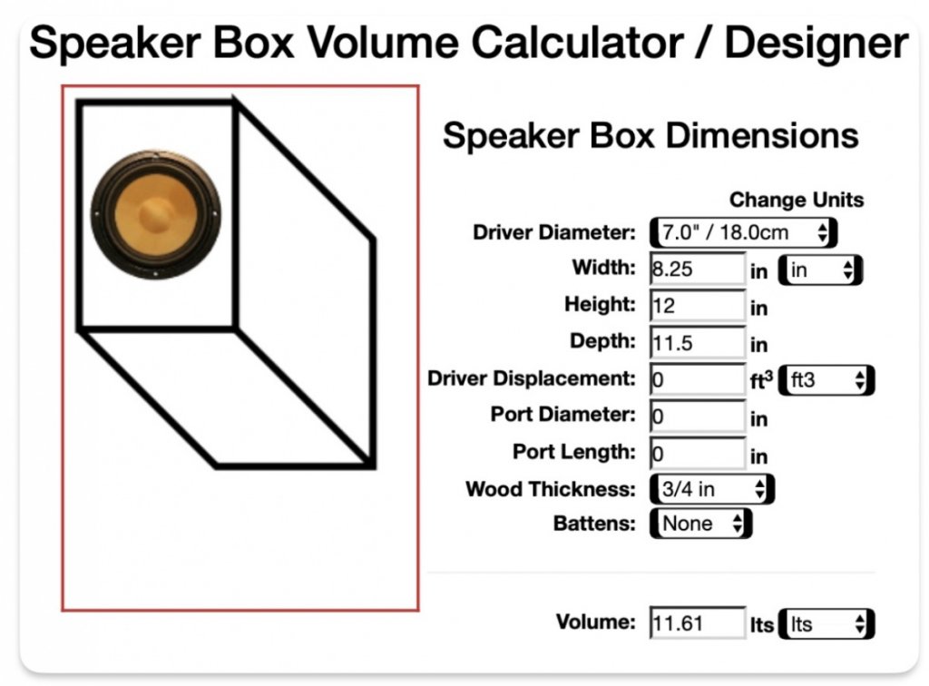

Here are the specs:
This sez .41cu/ft for SEALED alignment, which is what I am going to try, and blend to 2x Rythmik F8 8" sub pairs.
Chamber Size Needed for Illuminator in Sealed alignment?
So, given the current size of the chamber for the Illuminator (about 22" tall), it appears I need to add about 10" of filler inside that chamber, to change the height to 12" - as spec'd above.  Based on these specs, I think I need to take up about half the volume of the current enclosure for the driver to make it "Sealed".
Could be I just don't like this driver in a ported box in here.  I can make it sealed and blend it to a sub to dial in low end, and because these drivers are so robust with XMAX, I don't need to put a high pass filter on them to protect them - they are just playing low end anyway.
I think I may try adding some sand... and just Listen.

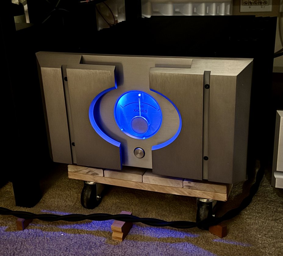

Well, I am happy to report the speakers are "fixed".
I am also happy to report there was nothing wrong with them...
You see, I got this new First Watt SIT-3 amp.  It sounds very, very special on the Wilson Duette 2-ways.  It was so disappointing to hear how bad the Clearwave speakers sounded...
As it happens, I shipped the SIT-3 to Danny and he will have next week. I am heading to GR next Wed / Thurs to play around with a few things.  I thought it would be a great idea to send some of my gear out there... and I really wanted to hear the SIT-3 of 95db, 8ohm speakers, his NX-Treme.  That is exactly the kind of speaker the SIT-3 is designed for.
And that was when things got "fixed"...
With the SIT-3 on a brown truck, I hooked back up the Pass Labs XA30.8 and... BINGO!  PRESTO!  "FIXED".
Although the "specs" for the SIT-3 say 4-8 ohm speakers, it appears this particular pair of 86db, 4ohm Accuton / Illuminator driver speakers want to be TOLD WHAT TO DO.
The speakers just need an amp with a healthy dose of current - and they loved it.
People are cautioned about pairing the FW amps with the proper speakers.  On paper, this should have worked - and it did to a degree, but it just did not have enough control over the low end - and that is by design.
The magic the SIT-3 has, on the right speakers, is really something. That amp is worth building a pair of speakers to hear.
I am really hoping it works well on the NX-Treme, and that that will portend well for a pair of Epiphany 20/21 Line Arrays.
We'll see.
Be careful with the First Watt stuff... Corvettes aren't made for going off-road - well, unless you carry too much speed and turn-in too early.   :thumb:
I learned something.

Well, they asked for it... every 4ohm speaker has a plan until it gets punched in the mouth with 400w Class A!  I think about "I don't really need amps this big" and then I fire them up... glad I have them - they are as cool and pristine as the picture.
I know there are many who peruse this joint at 35,000 feet.  I have original boxes and personally transported these here from my friend in Sarasota, who bought them from the original owner's estate sale.  They were an "industry accommodation" on the East Coast.  They are a 2013 build (late in .5 build cycle), and I cannot find a single nick on them.  I have the original boxes, and a pallet.  I know they are very special, and there were not many of these actually built (ask Kent at Pass).  I know that some prefer the .5 over the .8, and I understand why - these are a bit sweeter than the .8, which can sometimes get a little "steely" in the highs (but are still great in their own way).
If you or know a friend who has interest, I can be talked out of them... but you will have to want them.  I am in Central FL and can personally deliver in the Southeast... no stress / anxiety about "shipping something heavy". Feel free to reach out, but as I said... you will have to WANT them - and we can discuss.  I took a lot of effort to get them here safely, and it is a lot easier to let them sit exactly where they are - and manhandle multi-driver speakers I may not even realize I want in the future.
Many lower wattage .5 Pass are now under $5k - and are bullet proof.  Highly recommended (they are still awesome, even if .8 is out there).
