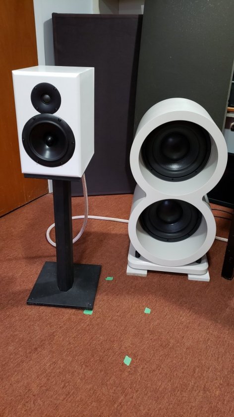

Here's my setup and feedback of my rounded version of the DT sub.
Link to the build: https://www.audiocircle.com/index.php?topic=191642.0
Setup and feedback
First, the feedback.
I’ve been listening to it for over a month now, and I like it. Really like it.
When I was listening to my X-LS Encore as is, without sub, I was questioning myself on why I was building a sub: I really liked the overall balance of the X-LS Encore: the bass is present, very fast, textured and precise. I was a bit afraid of losing that by adding a sub. Where the X-LS Encore was struggling was the extreme bass. That level of bass is present only on a very few pieces of music I listen to. Was it worth the risk? Oh yes it did. The sub enhances the whole presentation of the music, any music.
I added a high pass filter tuned at 70 Hz (68.9 to be precised) on the amp to the X-LS Encore. The sub gives me extreme bass, and the filter gives me more sound level pressure ( I can drive X-LS Encore louder now that it doesn’t handle the extreme bass). And I didn’t lose any precision of the bass. The bass is actually better, more precise, super textured like I never heard before.

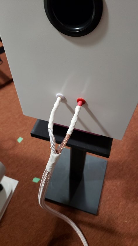

I use GR Research speaker cable (24 strands)

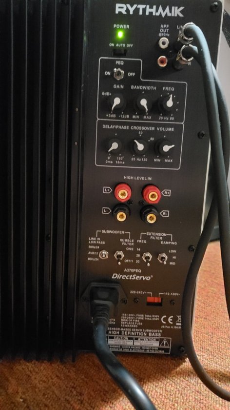

Then I played with the different setting of the sub amp to get as close of a flat response I could get.

The setting of the amp:
