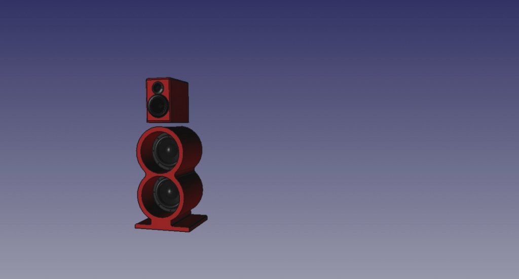

I'm about to start the build of a Double Trouble sub.

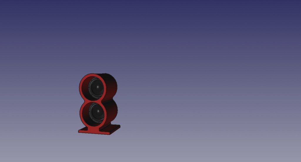

I was thinking of changing the shape a little bit. I would keep the same main measurements. The recommended cabinet is mainly two squares tube of 13 inches (inside). I would make it with two round cylinder of 13 inches (inside) instead. See attached drawing.
Question: will it change its performance?
Here's the sub by itself:
I could also make a bracket to mount a speaker on top of it:
Any feedback are welcome.
Rejean

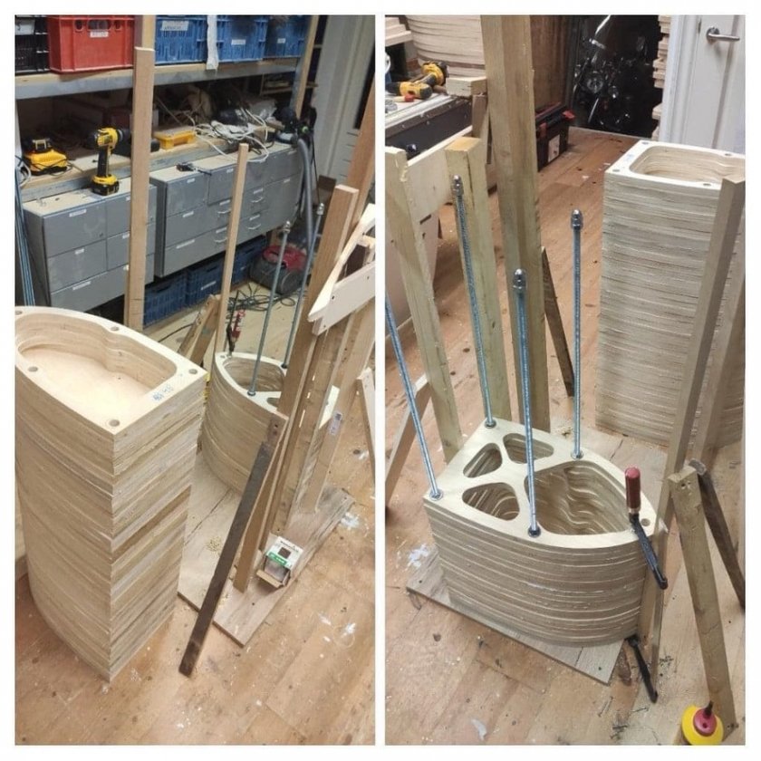

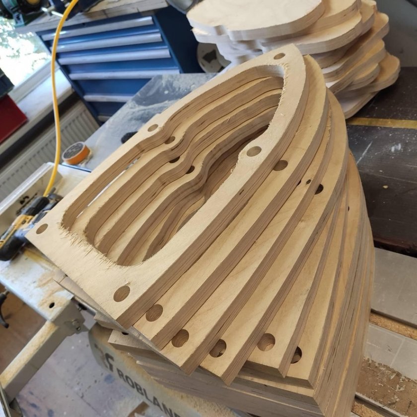

jmimac351
  • Posts: 672
Re: Rounded Double Trouble sub
« Reply #3 on: 16 Mar 2025, 08:54 pm »

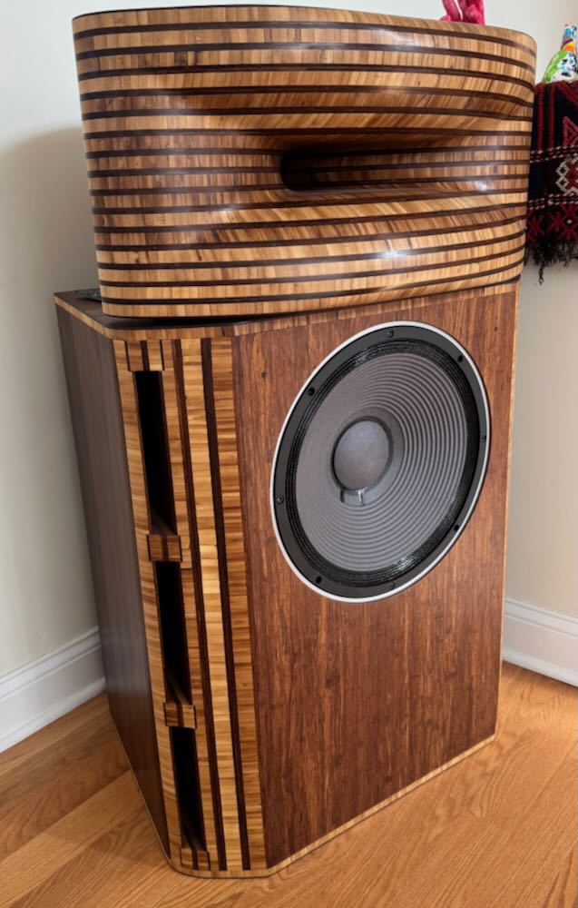

My plan is to stack 18 layers of 3/4 MDF (1" for the center baffle) cutout with a router, ideally I would cut them with a CNC, but I don't have one yet (seriously thinking about building a lowRiderV4). I would make a templates from 1/4 MDF or plywood to go around with the router.
We'll see. The design is still a work in progress... We'll see.
Yup.
tremrej65
« Reply #4 on: 16 Mar 2025, 09:02 pm »

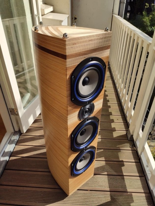

Wow. These speakers are gorgeous. Plywood instead of MDF. I like it.
Do you really need the steel rod? I was thinking of using wood dowel to help with the alignment during the gluing.
jmimac351
  • Posts: 672
« Reply #5 on: 16 Mar 2025, 09:24 pm »
Not mine.
I am a complete woodworking novice, but I would probably glue / screw to the finished layer and use a flush trim bit to match the current layer being worked to the finished layer.  Keep doing that until big enough.  Then the outside layers are just glued on.
Maybe that's a really bad idea.

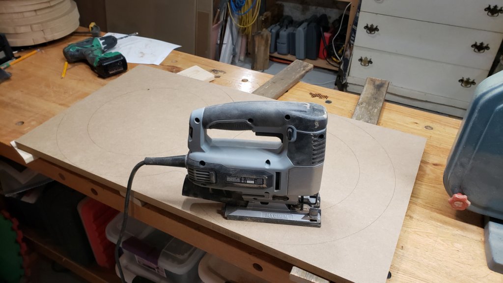

« Reply #11 on: 30 Mar 2025, 02:09 pm »

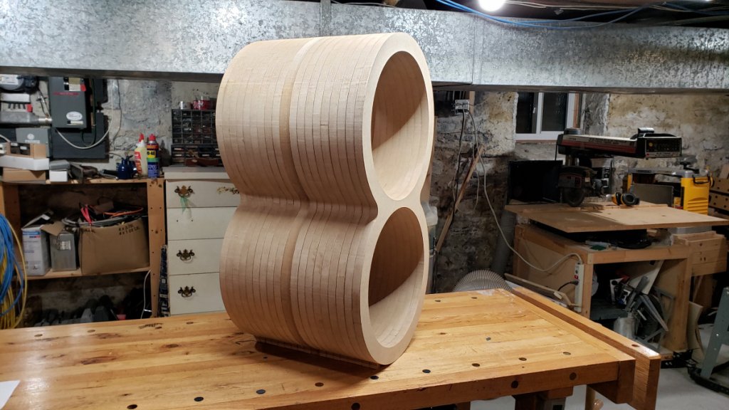

Here's some progress on my rounded version of Double Trouble sub.
First, a question:
Should I round the face (and the back)? Is it important for these frequencies (below 100 Hz)? I would not go more than 1/4". If not necessary I would not to.

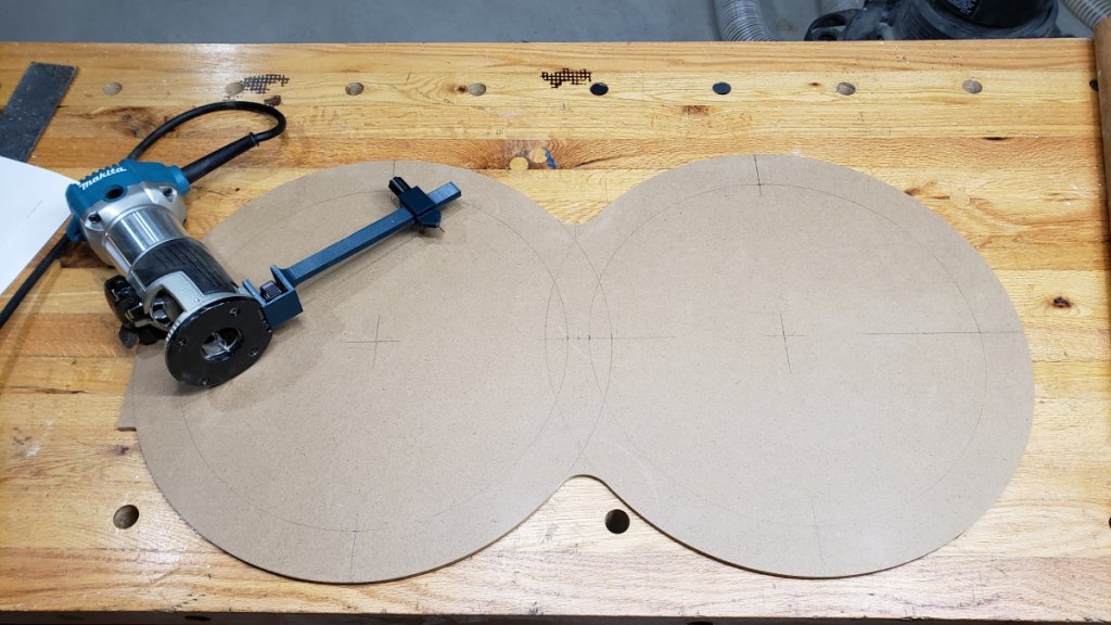

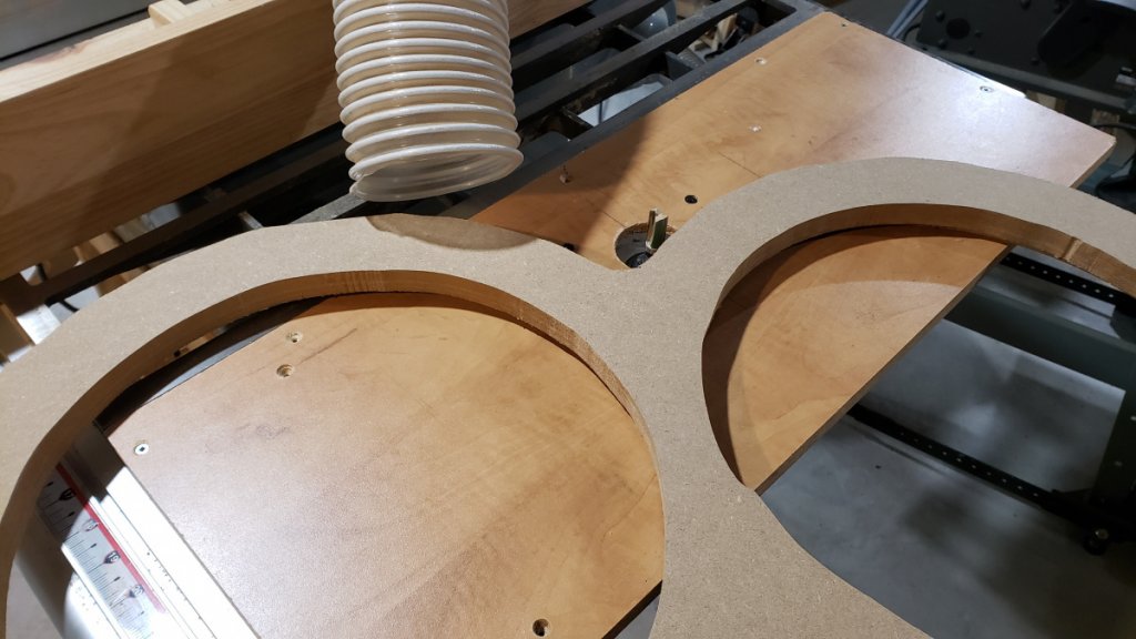

I ended up with 20 layers of MDF: 19 of 3/4", 1 of 1/4" (to make the baffle 1").

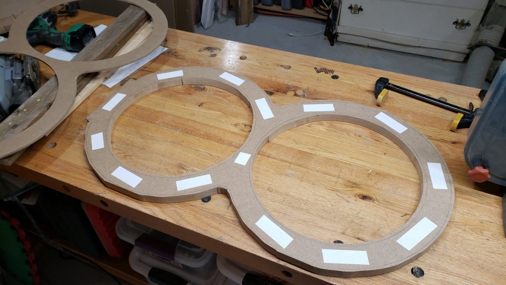

I made a template which I use with a flush bit on the router. It worked pretty well. About 10 hours to cut all the ribs.

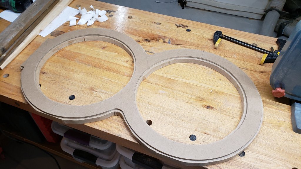

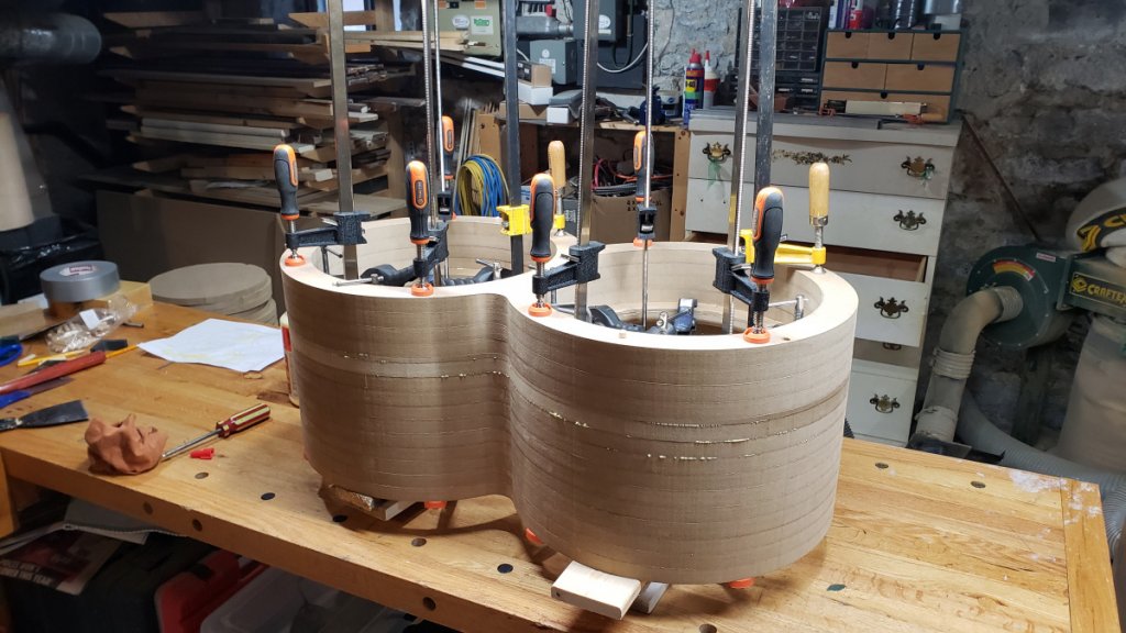

I glued the ribs 4 at a time:

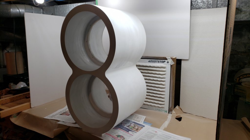

Then lots of sanding (100 grid):
That's where I am: two coat of primer (Bulleyes 1-2-3):
Next step: more primer, paint and make a base.
That's it for now.
