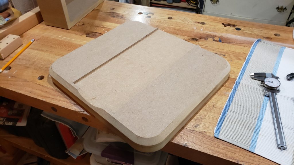

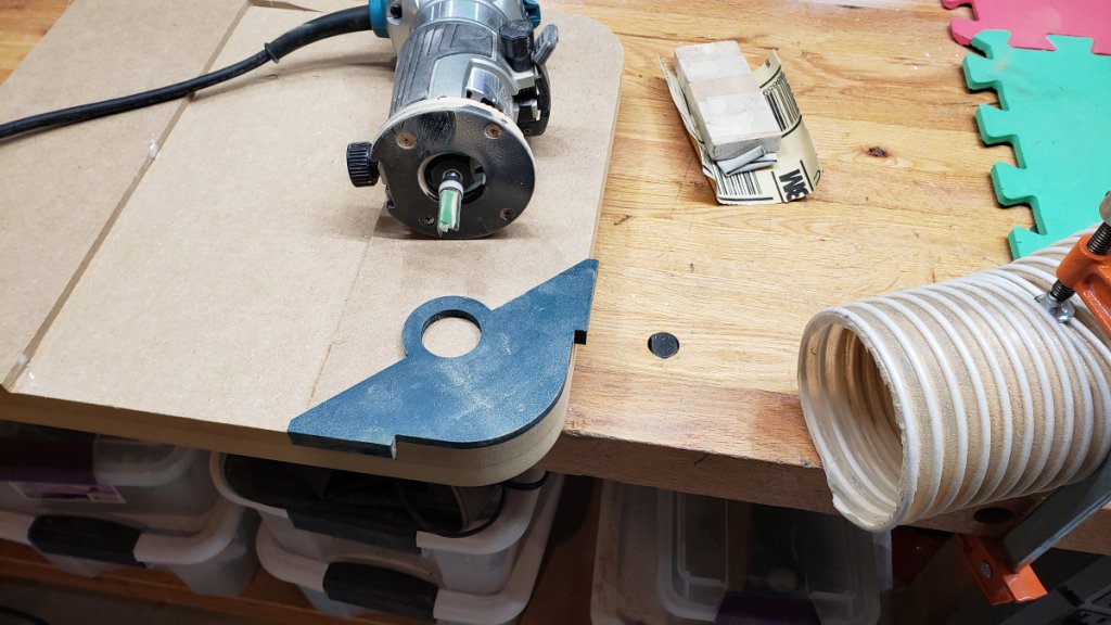

I made the base out of two layers of MFD.
I printed a template to make a 2 inches radius on the corners with a router:

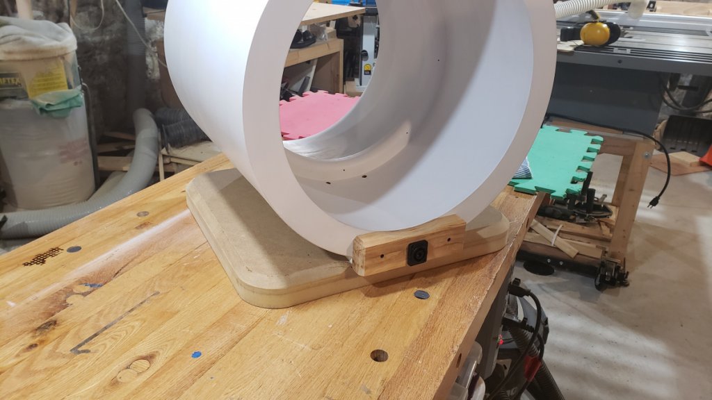

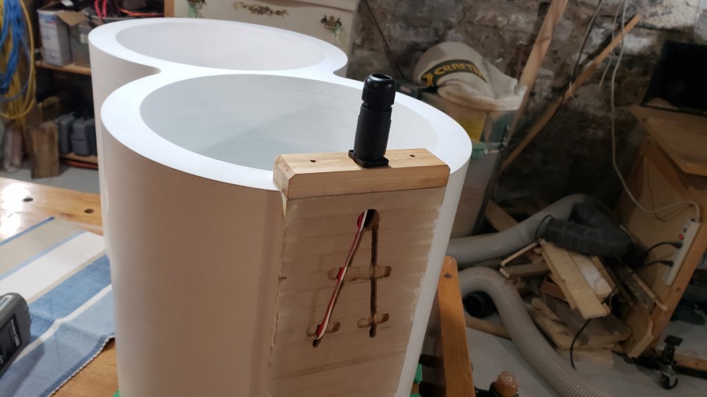

The wiring will go through the base:

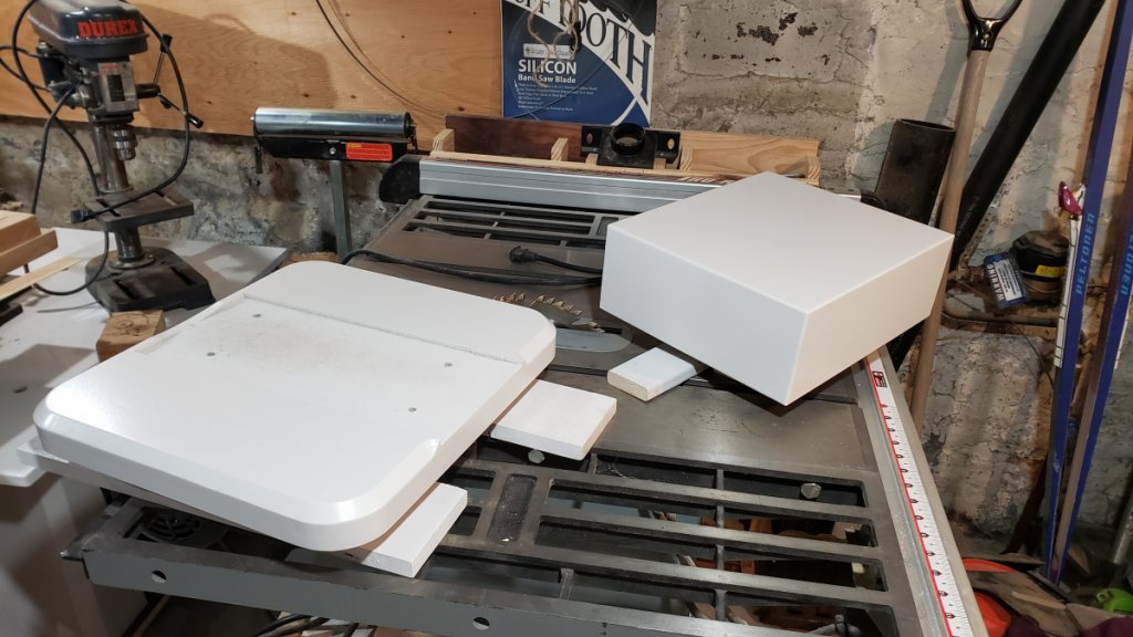

Paint is done:
Next step: few coats of clear varnish.

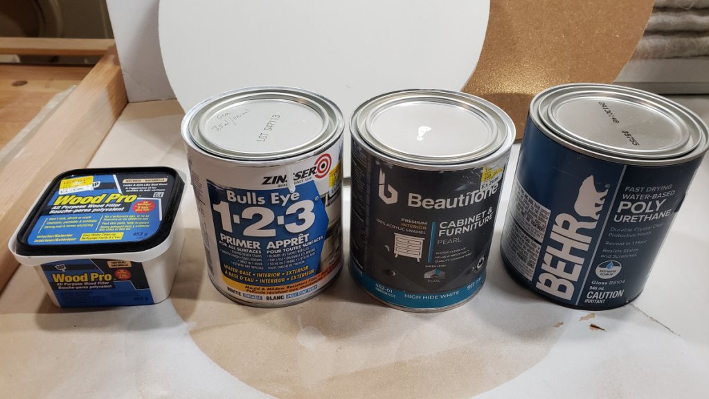

Actually not. A little bit but not much. I'm using a water base varnish on top of a water base enamel. I decided to apply a varnish to make the finish more durable: the paint on MDF is fairly "fragile". I hope the varnish will make it more scratch resistant. We'll see.
Here's every product I used:

FWIW, Duratex comes in black AND white.

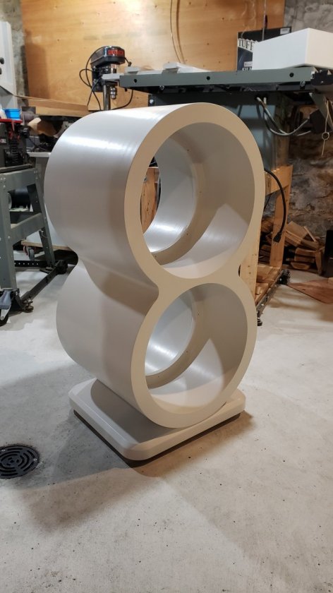

At last, here's the final product.
I'll provide my feedback about setting it up in a separate thread.
For now, here's some pictures.
The finished turned better than I expected. With the 20 layers of MDF, I thought it would impossible to get a smooth finish, but overall it is not that bad. Three coats of water base enamel plus three coats of clear varnish (water base). That's it.

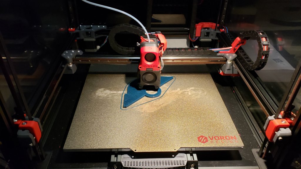

I added some feet. I cut four pieces of 2.5 inches of a 7/16" threaded rod. I threaded the MDF directly. Seems like strong enough to hold the weight of the sub (which turns out to be 96 pounds). I designed and 3D printed some cap to hide the screw (thread).
That's it for now.
I have been listening to it for few hours now. The integration with the X-LS Encore was fairly easy. I'll describe how I did it in a separate thread (it is more about setup then construction).
My next construction project will be to build descent stands of the X-LS Encore. Stay tuned.
