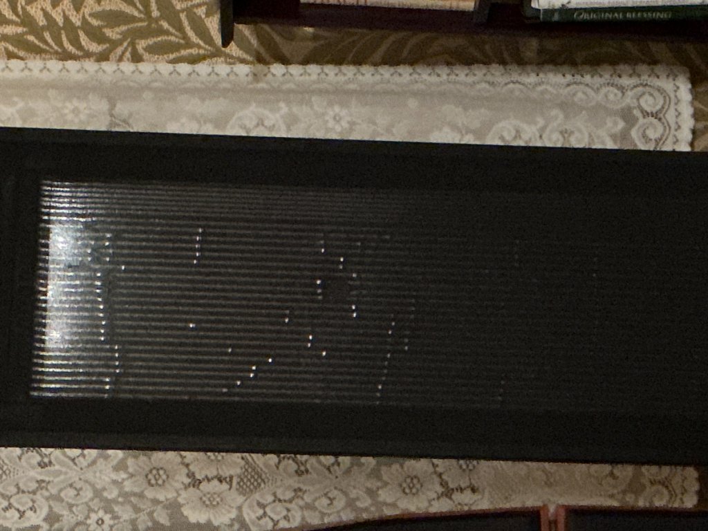

I’ve heard a lot about Magnepans over the years, but never owned any. I recently got a good deal on a used pair of LRS+, including a set of MagnaRisers.  I did a lot of research before making this purchase and learned a great deal, but I’m left with a few questions.
What is with those binding posts? My other speakers all have had quality posts that don’t require me to keep track of a tiny Allen wrench. There may have been a good reason for this decades ago, but now?
My speakers have what look like small humps or ridges in the foil strips. The guy I bought these from is mostly into jazz, not metal. I did read in the manual the section titled “for those about to rock.“ Is this what they are talking about? (This was the best photo I could get.) I don’t think my speakers are damaged because they sound so excellent, but would appreciate any enlightenment.

I've had mine cranked as loud as I can stand it in a small room, no bumps.

I’ve never noticed any ridges/bumps in the foil conductors on my LRS despite playing them loud periodically.  I also don’t remember it being mentioned in the LRS manual, but do see it mentioned in the LRS+ manual.

Thanks to both of you.  I may contact Magnepan to see what they have to say about those bumps in the foil strips since they don't seem to be normal.  But, as I said, I don't think my LRS+ are damaged since I am hearing new details on familiar recordings, better reproduction of upper harmonics on guitars, etc.

The bumps are common.  It is the foil delaminating from the mylar.  Magnepan usually says that they're normal and don't impact function or sound, but personally, I would not be happy with them if I bought them new.  Since you bought them used, there is not really anything you can do about them now.
My first pair of 1.6's, you could easily see the bumps.  I contacted Magnepan and they replaced the speakers.  Lucky that I live 30 minutes from the Magnepan home base and factory.  They were very apologetic.

The bumps are common.  It is the foil delaminating from the mylar.  Magnepan usually says that they're normal and don't impact function or sound . . . .
Thanks, this is helpful to know.  You're right of course about buying used.

I thought that Magnepan solved the delaminating problems years ago. As for subs I picked up a pair of Sony subs for $50 each on CL, they fit in perfectly if you keep the sub volume low to avoid boom. I think they recommend tweeters out on the LRS. With Maggie’s it’s a lot of trial and error with placement,

how old are your LRS+?
I bought them used so I'm not certain, but the LRS+ have only been out for 2 or 3 years, right?
How far are they away from the front wall and do you have any absorption or diffusion on the wall?
They sit in front of a bay window.  They are about 3' out, with the distance becoming less as the window angles in.  No treatment except curtains and shades in front of the glass.
Tweeters inside or outside?  Toed in or firing straight?
Tweeters outside, as the LRS+ manual suggests.  (I know that some people run them the other way and I will try that at some point.)  They are very slightly toed in.

That is not delamination.  Delamination can occur when they get old and make a rattling sound with bass.  The wrinkles you see are benign.
Magnepan calls it "tenting," but it's actually the definition of delamination. The bumps are where the foil has separated from the mylar.
The rattling sound on bass notes is cause by the same thing (the wire or foil separating from the mylar).
