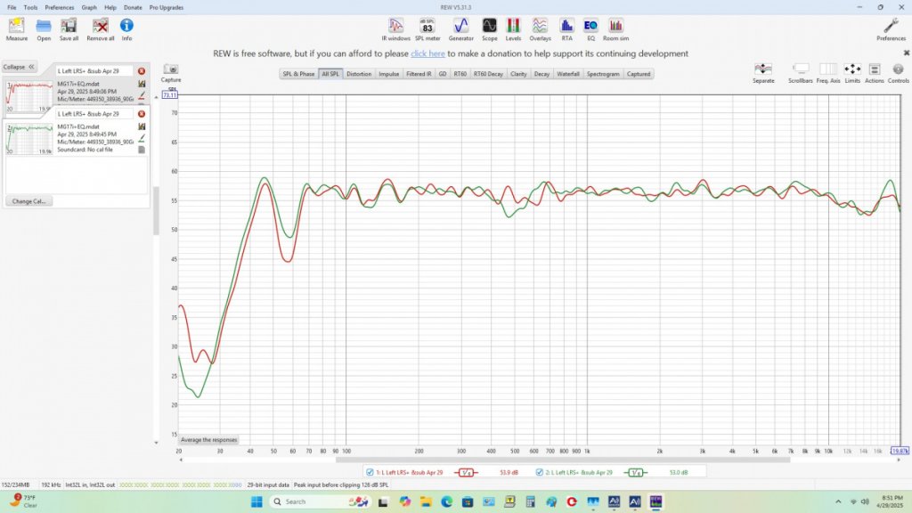

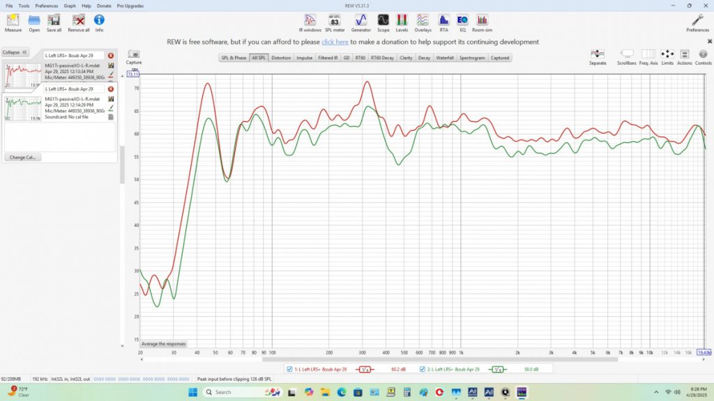

Have a pair of used stock Magnepan 1.7i's in for testing for dspNexus 2/8 use in my room.  This is with the original passive crossover in use.  Here is what the measurements show and what is possible with the system using REW for the measurements and frequency response corrections.
The 58Hz dip in response is the ceiling to floor cancellation at my seat with the placement of the speakers.  Both speaker channels are frequency corrected independently.
This is what correcting your speakers, in your room, in your listening seat can do.  And yes, they sound much better. 🙂
Stock passive crossover as setup:
Applied REW frequency response correction to the same speakers:

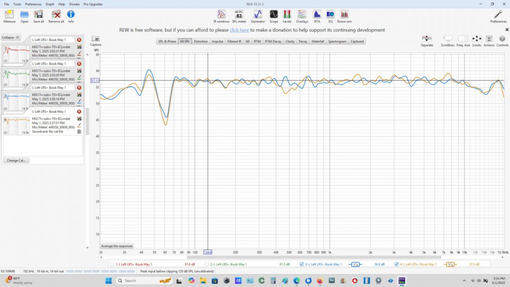

Decided to add my two open baffle 1x12 H-Frame subs to the 1.7i's and chose 125Hz as a crossover point.  I did time delay measurements from the 1.7i's and each sub and added the delay to each 1.7i.
The sub are near the 1.7i's with a similar ceiling to floor dip in response.
This is the REW response plot of both speakers at my listening chair with the MM-1 measurement mic setup at ear height, pointing at the ceiling with the 90deg calibration data.
