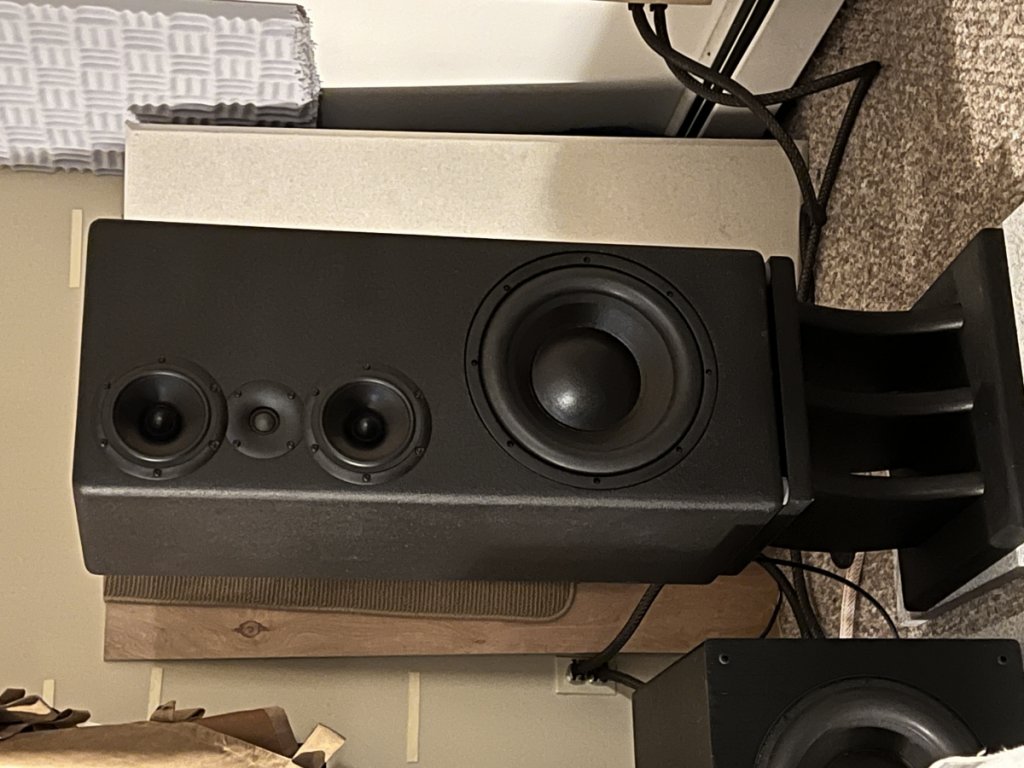

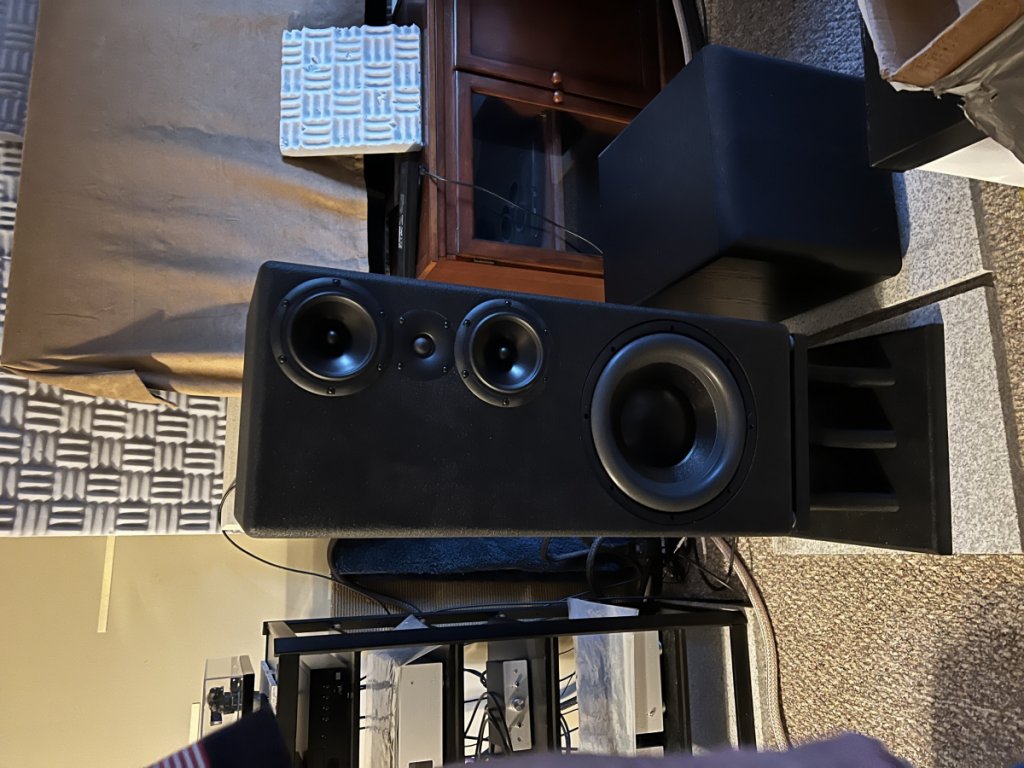

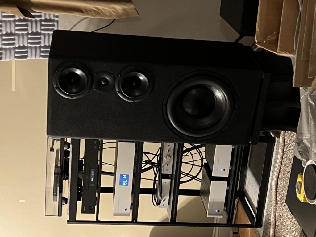

Rob,
The pictures of the bullies on the GR website may be a 1st prototype. The edges on mine are more rounded. I notice that the bullies tend to warp and distort in photos. I’ ll load some photos of mine that hopefully look more realistic.
I hope these help.
GentleBender
Re: Bully - Rounded corners
« Reply #5 on: 1 Mar 2025, 09:37 am »
I flipped these to protect your necks. :lol:

....I would still like to know how critical this action is on the music produced. I don't have the hearing I used to have as a teenager. I'm not sure if I would be able to tell the difference. If the difference can only be measured by equipment, I'll give this extra detail work a pass.
The main reason the Dayton Audio speaker linked has diffraction issues is the tweeter is equidistant from 3 sides of the cabinet edges, thus compounding the reflection.  It appears the Bully has the mids/tweeter moved to one side intentionally to reduce that issue. I think it's unlikely you would see a significant difference in measurements or hear one between a cabinet with a 3/8" roundover and a square edged one, as it takes something like a 2.5" radius (maybe more? I'd have to look) to eliminate the diffraction.
