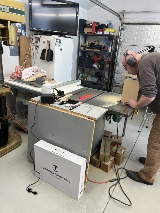

A friend of mine has a router table so he did the roundovers on the front and back of the speaker.  Thanks Mike!
Beautiful rounded edges:
