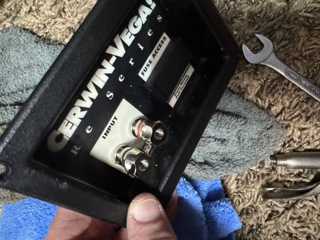

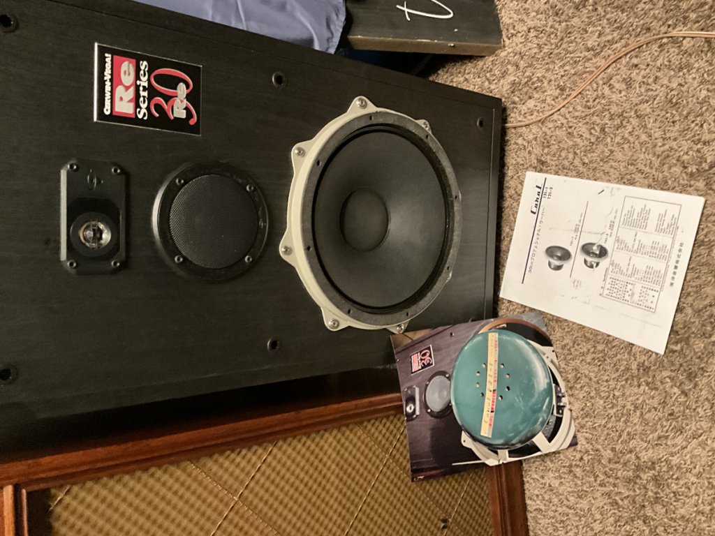

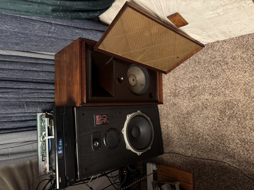

The YL speakers from 1965 are 16 ohms and the sensitivities are high over 100.
  Versus 1 or 2 ohms speakers with 70's sensitivities.

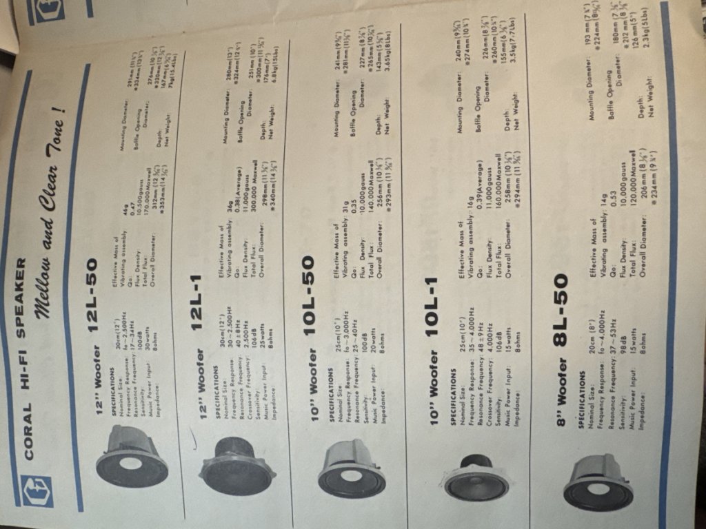

The Cerwin Vegas have a Coral 12L-1 in place of the stock 30 cm driver. 106 db 24 watts 8 ohms.
I can run 6 W per channel and they have a smooth creamy sound or I can use the 32 wpc amp with el34's and the soundstage broadens and deepens, the sound is rich but also no less detailed than the smaller amp.
Of course these are true hifi speakers not mass merch. So that does make a difference. But I just don't seem to enjoy the sound quality from my classical as much on the purely a/b and d class platforms.

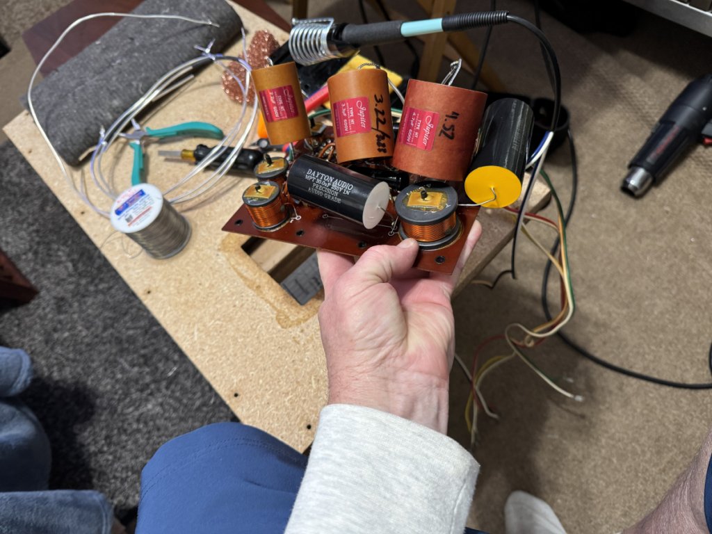

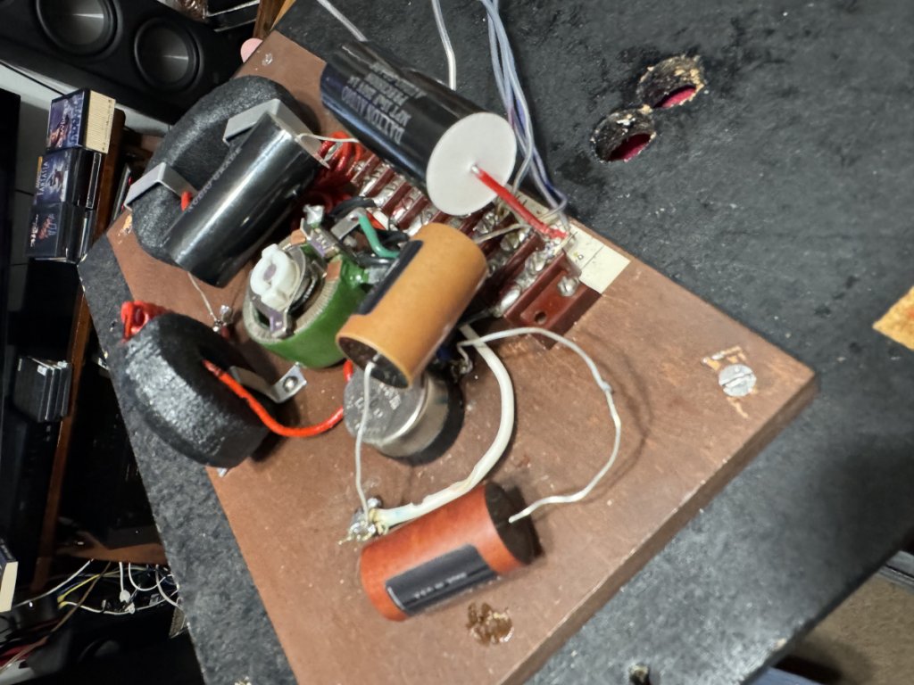

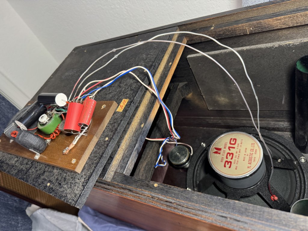

The YL's (16ohm)
sound so natural to my ears when listening. Even with my Industrial music. I can tell large differences from the 1960's to the 1990's and now my 2023 set. Even switching between the pure class A 6w amp at 8 ohms which may produce a watt. To the 17w Prima Luna at 16 ohm tap, both tube amps change the dynamic. Then wow, you put the Denon 40w/8ohm and it is completely different with that classic digital
 a/b sound modulation. I barely turn up the volume and yet any of these will clear my sinuses. I also follow Danny's advice. I used the leftover good nickel parts from the Polks for these RE30's. Plus I now carry a magnet when thrifting. Thanks for the tip!

You go on with that copper, Soonerbass!!!  :thumb: :thumb: :thumb:
