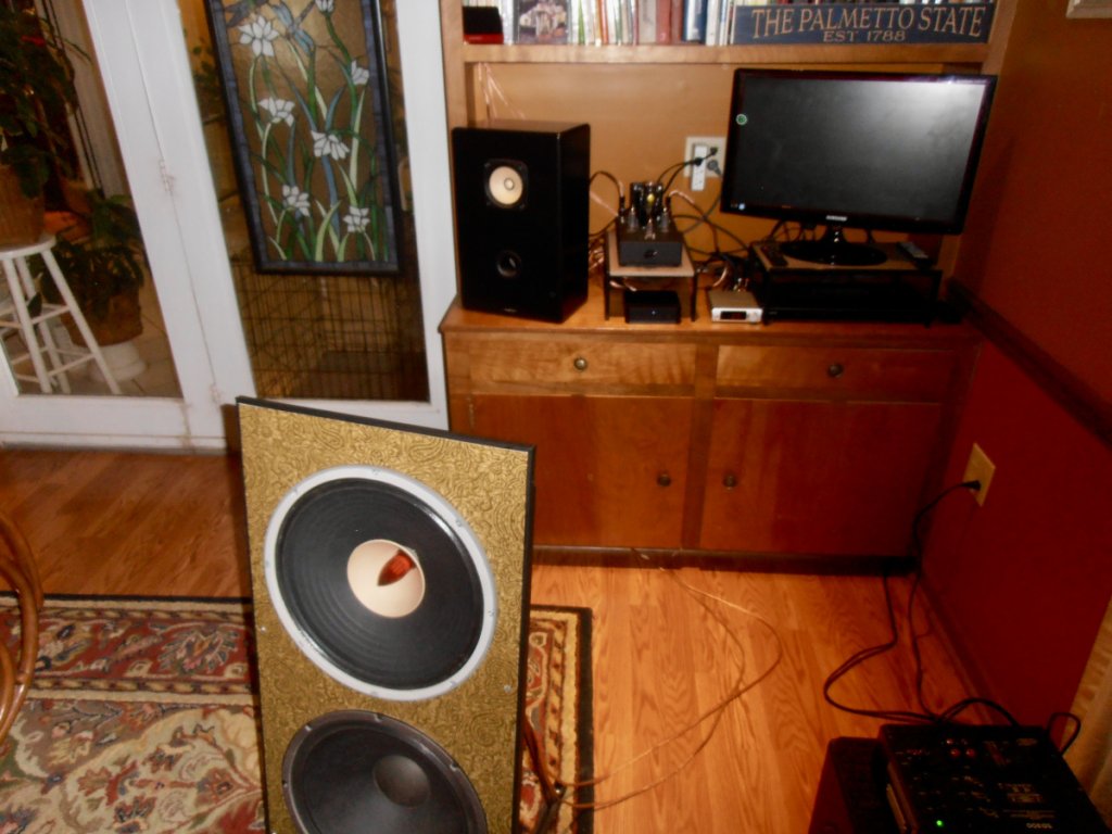

Here's a new picture I don't think you've seen. The F-15's sound lovely with a 2 watt Decware. Why do you not want to share pictures of your OB's? I'm especially interested in your line array featuring 8 Visaton B200's.

I decided I would order a W-15 Lii Audio bass woofer before the price went up and today I took delivery. It arrived in double boxes and my first impression is it's hellaciously heavy!!! I ordered a single because my friend Randle of Caintuck fame says one can/may be enough. To be honest it's so darn heavy I'm not sure I could handle two. A baffle to hold this monster could be a challenge but I may double up the unused  3/4" F-15 flat baffles after I cut them down to size. Stay tuned as this is not a project for the faint of heart.

I finally mounted the beast in it's own baffle. To get a decent amount of support I went with two 3/4" plywood panels glued together. It's so difficult to lift and move around, it rides on a moving dolly from Harbor freight.

One is all I need. I would guess my two Alphas might reach 40hz but the W-15 nicely fills out the lower octaves. A kick drum never sounded or "felt" like this before. I listen to mostly jazz but what the W-15 adds to Tool's "Chocolate Chip Trip" is down right amazing.

I front mounted the W-15 as it provides more material to support the weight. Flush or recessed mounting would reduce the thickness of the baffle thereby increasing weighted stress. It's common practice I know but I don't see how it would be ideal.

I prefer front mounted also, no sound diference from flush.
