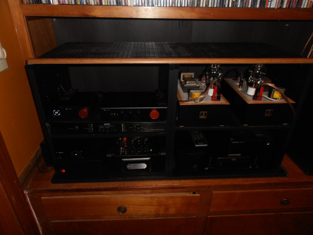

I'm currently using my Bottle Head preamp in an other system so I switched to the new Fosi ZP3 preamp and it works so well it may stay indefinitely. With its two pair of outputs the Fosi allows bi-amping driving the 2a3 SET mono blocks amps for the F-15 and an Aiyima A07 ( via Fmods X-over ) amp for the Alphas. The sub out on the ZP3 sends the signal to a 300 watt Yung plate amp powering the W-15. My two sources are a Wiim streaming to a Fosi ZD3 DAC with Sparkos op amps and a Marantz SACD player.
