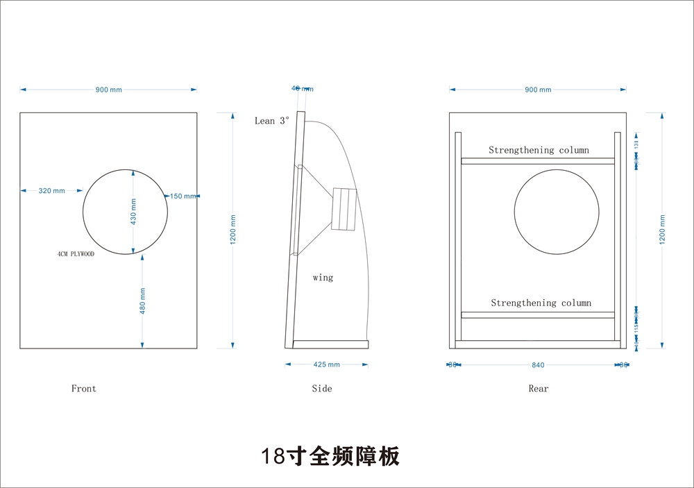

The Lii Audio F15 or 18 page show other Square OB plan.

If you dont want the Barrel circular sound dispersion check the Lii Audio F18 square Baffle.

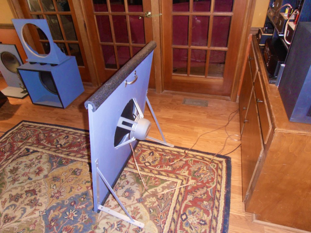

I have the Lii Audio version that Viggen linked to, not the Lii Song version. But they may use the same frame supplier, the (inner) cut out size appears to be the same as what FullRangeMan posted. On my test baffles I cut a 14-1/8" inner cutout and a 15-1/2' outer frame cutout, with chamfers on the opposite side. That allowed me to test the drivers both front and rear mounted, using diy speaker cleats.

It appears they do not list an F-15 OB plan on the Lii Song webpage. The plans for the F12 are 700 mm wide, the F18s are 900mm. Other wise they are similar. So maybe a test baffle of 800mm (31") wide. I would email them for conformation.

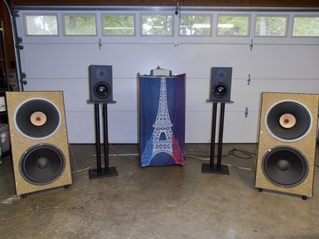

I first tried the F-15's in 36"H x 30"W baffles and while it was ok I felt like some of the back wave was missing. When I placed the F-15's in the smaller baffle in the back ground I noticed a big improvement. It wasn't because of the H-frame woofers as they weren't powered at the time.
« Last Edit: 17 Feb 2025, 11:27 am by Poultrygeist »
Poultrygeist
Re: Lii 15 open baffle
« Reply #12 on: 16 Feb 2025, 07:58 pm »

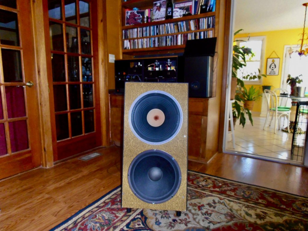

I finally decided on these baffles which are 36" H x 18.5" wide. I think for best results the F-15's need to be closer to ear level. Too wide of a baffle and you can lose some of that reverb magic.

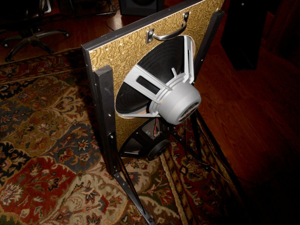

Poultrygeist
« Reply #16 on: 17 Feb 2025, 10:09 am »
They are shelf supports from Lowes. They come in different sizes but these are the largest I could find. I've tried wings on one side and both sides which had no audible effect.
How high up you mount the shelf supports on the baffle determines the tilt. I use 1 1/2" rubber feet on the front of the baffle and felt pads on the rear shelf support. The drawer handles are needed as these OB's are very heavy and I have to move them around in order to vacuum.
