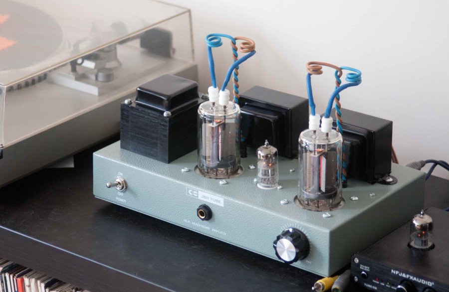

I am exactly on the same mood. Living in China since 2 years an half I spent less than 500$ for the whole system with the Lii Fast-15, audio player, little DAC and little amp. The most expensive part was the wood for the panels. I was very impressed by the result.
Few months ago I learned we will stay two more years in China, so I decided to buy again a turntable. Then I told myself I would like to listen the panels with a tube amp.
Except the turntable, everything is ultra cheap equipment and the results are so nice.

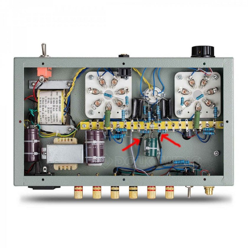

I also ordered one of these and some additional tubes to try (at that price why not?) and reading a bit about it, I'm pretty sure I will want to rewire the leads to those anodes with something perhaps safer.  Does anyone know a good source for the caps for those pins?

Tyson, I am not saying anything is unsafe, just that I will feel better with some rated wire on the leads going to the anodes. On another forum I saw this modification that seemed reasonable.

Yeah, it probably is a good idea to change that external anode cap wire to something else.  I still can't believe I haven't even opened this amp or try to modify it, but it definitely is a case of "don't fix it if it ain't broke" for me.  Let me wait to see what more people say about the A300 version with silver case.  Heck, I might buy myself a third one  :thumb:

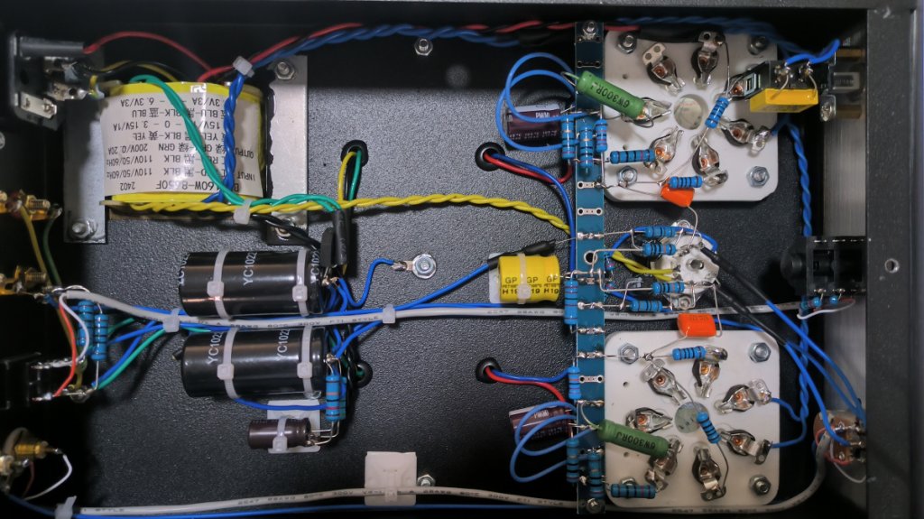

I have an extremely low knowledge in electronic. I can more or less read a schematic but I cannot understand it, I can identify some components and see vaguely the signal path.
So I've done 2 things:
1 - change the FU 19 tubes from left to right and right to left. No change, this is on the right channel
2 - opened the amp to see if something was loose, bad soldering or smell a burnt component: nothing on, this side.
The next easy step I can do is to buy the preamp tube and try a swap.
If you suggest some things to test with a simple multimeter, I will receive your information with great pleasure and enthusiasm (but I usually do some arduino things under 5V, the tube amps are dangerous in my point of view).

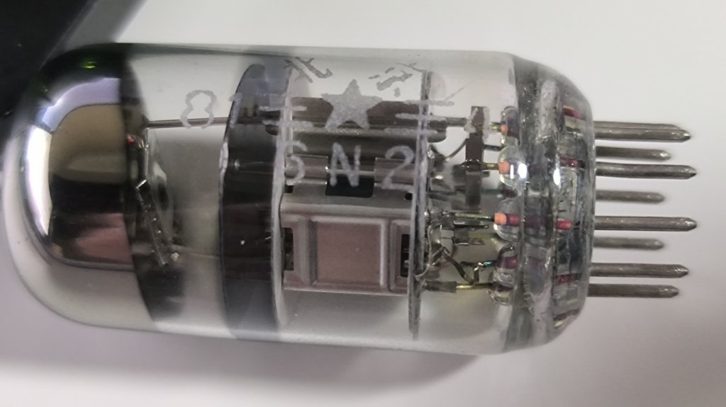

I've just ordered 2x6n2-EB, will receive in 2 or 3 days.

The current one:
Do you think it is a stupide idea to switch the amp on without the pre tube to test if the hum is still here?

Ok, the seller is sending another 6n2!
Will give you some information in 2 or 3 days!

I received the tube(s) yesterday, changed it and now the amp is alive and kicking.
I ordered immediately after the fail 2 new tubes and a friend of mine called the seller: he sent immediately a new tube. So now I have some spare.
