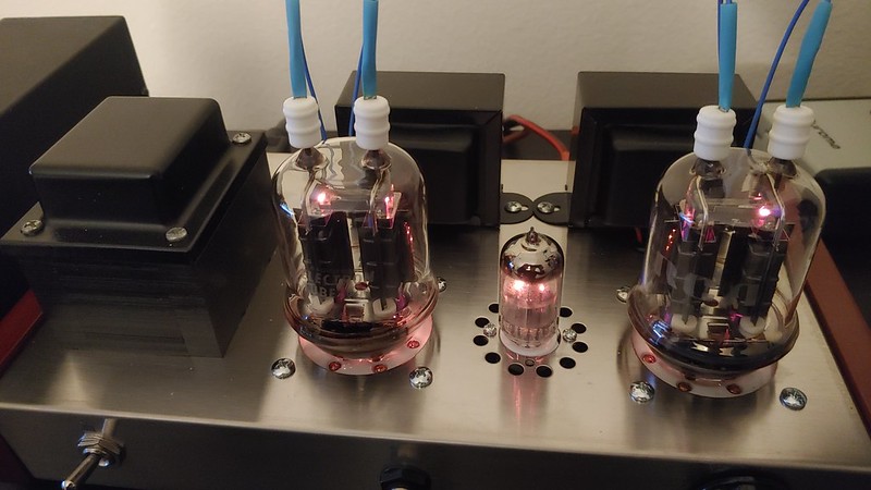

I'm almost embarrassed to mention the low price involved but thought some may want to buy it before the tariffs.  If shopping carefully on Ali, one can find the FU-19 version for something like $130 with $80-100 shipping (tubes included). Below is photo of FU-19 amp I bought with RCA 829B tube rolled in.
I have just confirmed the amp body is the same, so one can tube-roll FU-19, FM30, 829B, and other tubes.  They quote anywhere between 4 wpc to 6 wpc, but it definitely seems to have more power than my 2A3 SET and have no problem driving desktop speakers of 84.5dB/8 Ohm sensitivity to loud levels with great clarity and tube magic  :thumb:

1123241949 by drjlo2, on Flickr

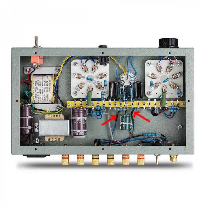

The amps that have choke inside (side-long chassis) look the same inside.  Note how easy it would be to swap out the coupling caps (the black boxy ones) and to cut/desolder negative feedback wires (marked with red arrow in this photo from the 'net).  Driving headphoens and my desktop bookshelf speakers, I actually have no desire to change anything right now, but when I power Altec 511b horns later, I probably will do both mods.
FYI.  I bought the one with wood side panels because it was a bit cheaper after shipping and the wood side panels make the amp look larger (a good thing) compared to the compact grey one in photo below. However, my amp did NOT have any markings on the toggle swiches and speaker taps, so I had to look at the grey amp photos on Ali  to see the markings.

Re: FU-19 (FM30, 829B) Single-Ended Tube Amp!
« Reply #12 on: 2 Dec 2024, 04:54 pm »
Thanks for posting this image. :thumb:
This is a few connections amp, simple circuit, hence the good sound.
