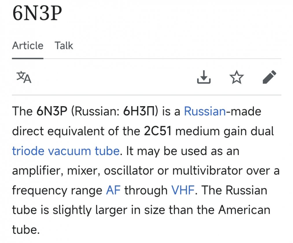

So this is this one?
https://en.m.wikipedia.org/wiki/6N3P
Yes, I "think" the Russian 6N3P and my 6H3P are interchangeable.

Can you run a 2C51 in these amps?  I have a few of these in my tube stash.

2C51 can directly replace 6N3, so the amp Mick has ("10 watt amp") can use 2C51 instead of 6N3  :)
AI answer:
"The 2C51 tube is a direct replacement for the 6N3, not the 6N2.
The 2C51 is equivalent to several other tube designations, including:
5670
396A
6N3P (Russian designation)
6H3П (Cyrillic designation)27
These tubes are all drop-in compatible despite their different names2. The 6N3P is actually a Russian copy of the American 5670 tube, which is the high-reliability version of the 2C51."

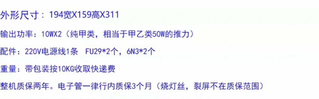

A300
I ask because it mentions the 6N2 in the description in the ad, not the 6N3.

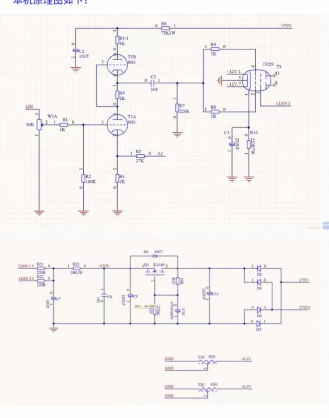

Schematic says 6N3.

Mick, is this the amp you have?
A300
Tyson.... The amp I bought is an FU29 A300. ( 10 watter) There is also a 30-40 watt version. All claim to use 6N2's as the small signal tube included. In fact still another version claims 6N3. All I can say is don't count on it. For all I know, I may have the only 6H3N version on the planet, but I doubt it. The only word to the wise I offer is verify what small signal tube that is actually in the amp before going on a tube rolling adventure.
