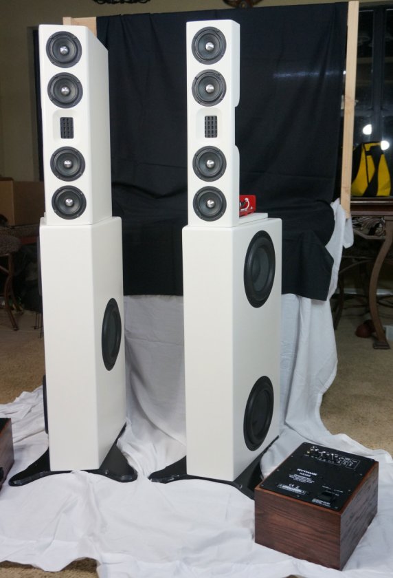

Does anyone have an image of the MTM's?  I'm trying to picture what this would look like.

you can see them here:
https://www.audiocircle.com/index.php?topic=164355.msg1747479#msg1747479
Thanks, I know what you guys mean now when you say wedgie.

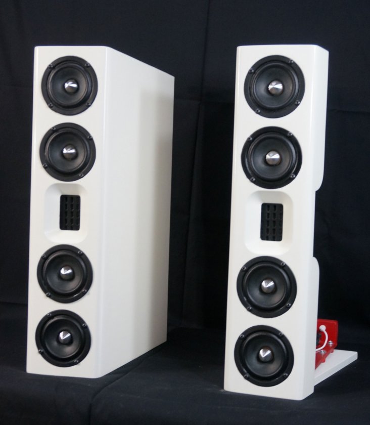

The "Wedgie" was an even more narrow model using 4 of the old 3" LGK 1.0 drivers instead of the NQ woofers.
https://www.audiocircle.com/index.php?topic=173363.0

Actually, these are the Wedgies. They use the LGK 1.0 instead of the M165NQ for the midrange drivers with the Neo3 tweeter in a much shallower waveguide. This was Danny's first wedge shaped open baffle speaker.
Here they are on their wedge shaped base with triple 8" servo subs
The Wedgies actually image better than the 'Otica MTM due to the narrower baffle. However, the larger 'Otica MTM has a more robust and full bodied sound, especially in the midrange.  Also, two 12" servo sub drivers outperform three 8" in bass response. That said, for a small untreated room, the Wedgies are killer. I had them in an untreated room that was 11'x10'x8'. While most people I've been around who have heard both, prefer the presentation of the 'Otica MTM over the Wedgie, some have preferred the laser like imaging of the Wedgies and the Wedgies will work in rooms that are too small for the 'Otica MTMs.
