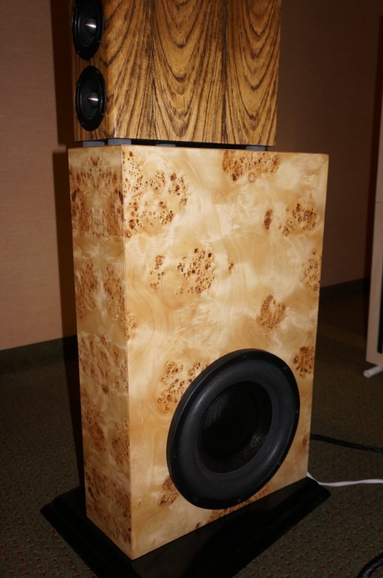

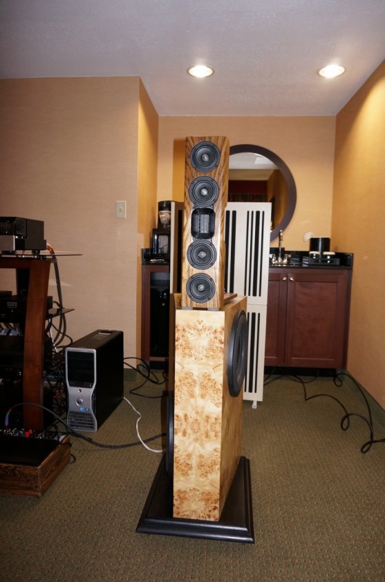

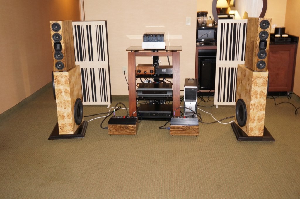

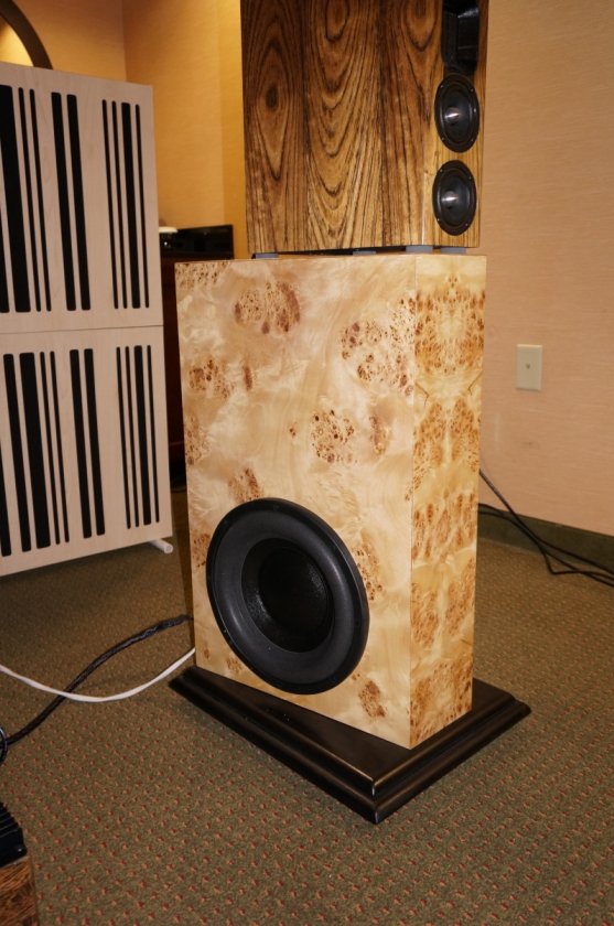

You could build wedge shaped cabinets with dual 12" woofers. I've done that a couple times for Wedgies.
  • Posts: 11644
Re: Wedgie with NX-treme
« Reply #6 on: 13 Nov 2020, 05:36 pm »
Damn Mike, those are beautiful!!
Those are beautiful.
How is their output compared to the standard H-Frame configuration (spl and frequency extension) ?
Have you done any measurements ?
mlundy57
  • Posts: 3643
« Reply #9 on: 15 Nov 2020, 10:08 pm »
I don’t have any comparative measurements. From listening I would say the output is close but the H-Frames have more. The only reason I’d build a wedge shaped base with 12” drivers is to match ascetically with the Wedgies. For the wider NX-Otica MTM monitors I prefer the H-Frame.
