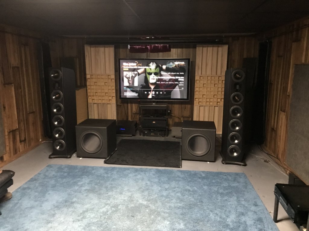

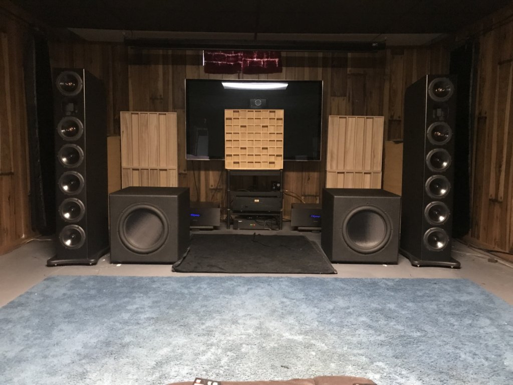

 Here’s what my setup looks like now. Of course I move the middle diffuser when I watch tv.  :icon_lol: An unexpected result from moving the subs out of the corners and putting the bass traps on the floor increased the perceived bass response from the speakers. The bass is strong and powerful enough without turning on the subs. For music they are not really needed. The diffusers improved the imaging and sense of soundstage width and depth.
 I have another 2QRD like the one in middle and tried those stacked in between the panels behind the speakers like this, but prefer the sound the way it’s setup in the top photo.
  Since this is my basement, The ceiling is low at only 6' 6" high after installing the drop cieling. Years ago I installed ceiling tiles designed for  home theater which are basically 1 inch thick fiberglass insulation board with a black facing. Also I stuffed insulation between the rafters. So I guess the ceiling doesn't cause much ssues.

 After further listening, I decided the one diffuser in front of the tv doesn't really improve anything. Putting a blanket over the tv and the other two 2QRD panels behind the speakers works better. You not only need to tinker with speaker placement but also room treatment placement.  :duh:
 So I ordered two more diffusers and will try an absorption panel for in front of the tv.
 I'm experiencing "frisson" so all this tinkering is working.  :thumb:

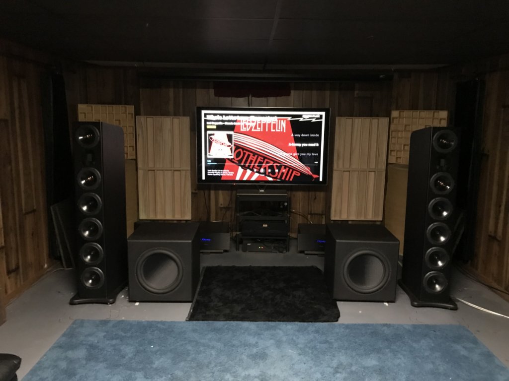

« Reply #74 on: 2 Sep 2023, 12:54 am »
 Here’s after I mounted the diffusers on the wall. I put 2QRD panels across the corners above the bass traps. To my surprise made a nice enhancement to the overall sound, the sound quality is more consistent throughout the listening space.
 Also, if you move your subs, don’t forget to measure and EQ them again. I believe I managed to get the subs to blend well with speakers.

2D diffusers need more space to work compared to the 1D ones, or at least that's what I've been told by GIK, so they may be too close to the speakers.
Glady86
  • Posts: 281
Re: Nx Otica in Room Response
« Reply #79 on: 4 Sep 2023, 12:02 am »
 Thanks, I have two more 1D panels, so I made two triple stacks of them. They now cover most of the space from floor to cieling between the tv and bass traps.  I could try the 2d ones at the second reflection point, but I kinda think I wouldn't hear any difference. The room is 40 feet long so I don't think treatments on the back wall would change anything?
