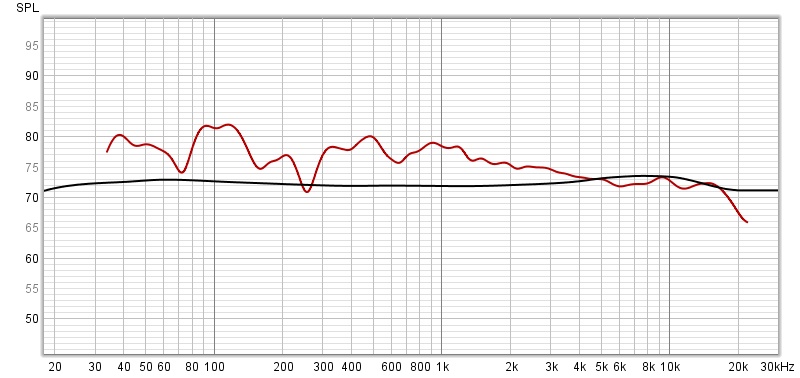

 I've just found a seller on ebay offering basically the same thing fot a bit cheaper though there not finished like the GIK. For fun, didn't place the order, I put four items in my cart at GIK. Just two bass traps and two diffusers, and the price was getting close to a double trouble subwoofer kit.  :icon_surprised:
 For now I have a room lens at each side of the tv.
 I did a couple more measurments just moving the mic closser and the response is flatter about two feet closer. But it sounds better to me back to where it measures worse. The soundstage opens up at my original seating positioning. Also walking around the room the sound is pretty consistent to my ears. The mic hears better than I do.  :icon_lol:
 I think REW measurments are a good tool for finding major problem areas but to me, trying for some ideal looking response would be a waste of time and drive me nuts, plus eat in to the time I could be listening to music instead.

You’ve learned a valuable lesson - getting the best measurements does not always mean getting the best sound.

  I know measurements didn't help me find better positioning for imaging and soundstaging quality. I guess for me "By ear" is the only way for that. I admit, I don't know much about reading all those different graphs and the technical stuff, so maybe it helps others with a better understanding.
 Also the free upgrade of throwing a blanket over the tv plus adding my DIY room lenses to the sides of it, gave me an idea of how good these speakers can portray a 3d image in the center sound field. To truly get the best out of them, I'd need to move the tv from the center and add some diffusers and treatments. Or just stick some type room treatment panel in front of the tv when listening to music, maybe get me close to maximizing performance.

My general guidelines are to get the speakers away from the front wall, 3 feet is good, 5 feet is better.  Use absorption on the side walls at the first reflection point, diffusion on the front wall, corner bass traps of you can fit them (but bass traps are less needed with OB speakers and OB subs), remove everything from between the speakers (or use a low and wide rack if that is not possible).  And last but not least cover any windows with a combo of wooden slats and heavy Roman shades.  If you have a TV, get a lightweight absorber panel you can put over it when listening.
After all that, take measurements and use the EQ built in to the subs to EQ out whatever is the biggest peak in the bass.  Only EQ 100hz and below, otherwise the life gets sucked out of the music.  And get OB subs as soon as possible if you don’t have them already.
These are the rules of thumb I’ve come up with after 30 years in the hobby.

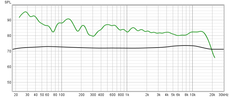

  The green one is the latest measurement I took with subs on, after the diffusers and some small changes in placement. The new measurements don't look much different. Though sound quality, especially the soundstage and imaging improved significantly. The improvements in soundstage and imaging came from adjusting position of absorption panels, moving the curtains on side wall back out of the way of the open panel on the midrange and tweeter drivers, blanket over the TV, and the front wall diffusion panels. The diffusion panels really shored up the sound staging, it's better than anything I've experienced. Like I said the speakers now disappear and I'm left with just the music.  :D
 Guess I'm done posting in this thread and I hope it helps others try to dial in their Nx Oticas.

Be sure to measure only one speaker at a time when taking room response measurements.
