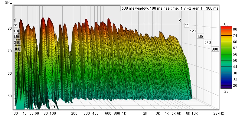

Frequency response is only part of the equation. What does the impulse response, spectrogram, ft60, look like?
Here is some work I've done in my room with nx-studios and 3 rythmic subs. The room is highly treated. And I do some eq in the bass region.

Here's these, not sure what it all means though. I have a hole at 250hz looks like the biggest flaw.
Watch this video first.
https://youtu.be/CuEwoeN7ZJk?si=o_TIUUBWsVDMXSDT
