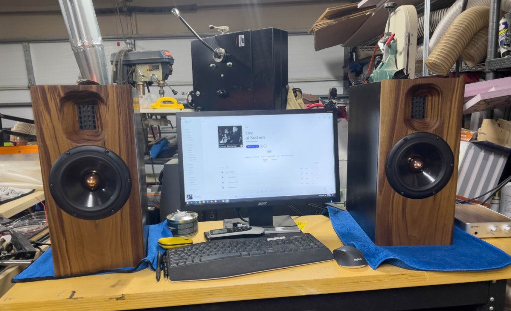

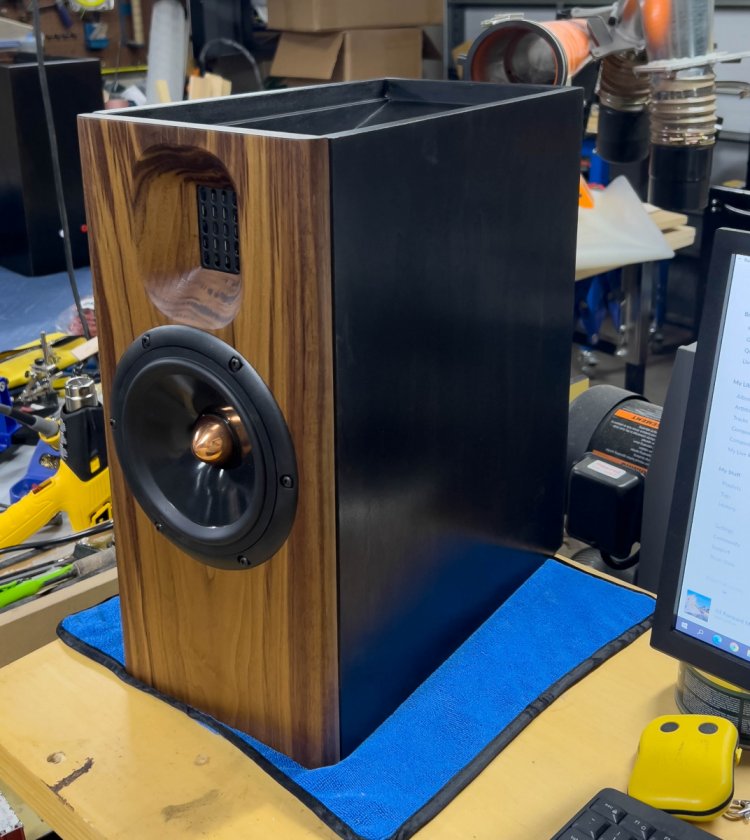

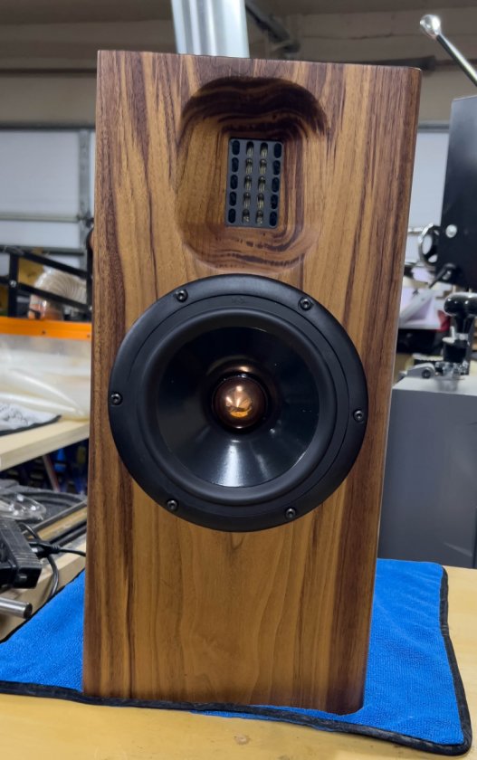

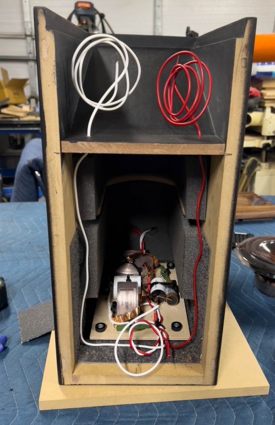

Here are some pics of a pair of NX-Studio monitors I am finishing up. They are up and playing for break in but still have to make the grills and add the No-Rez to the top ramp. This pair has walnut baffles, the sides and back have ash veneer that has been dyed black with Rudio Pre-Color Easy intense black, and black Dura-Tex on the bottoms. The sides and back have two coats of Rubio Monocoat 2C black and the baffles have two coats of Rubio Monocoar 2C Pure. Once the Rubio Monocoat 2C fully cured, the sides, back, top, and baffle got two coats of Black Forest Wood Company's Platinum ceramic coating and one coat to their ceramic top coat. I used a small chamfer bit on the sides and bottom to create a reveal between the baffle and sides.

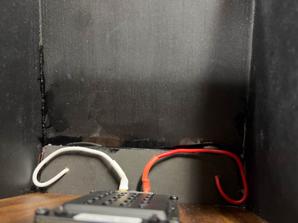

When installing the tweeters, I left the hook up wire long enough to easily remove and reinstall the tweeters if there is ever a need.
I installed the crossovers before installing the baffles.
I have more pics of the build process if anyone is interested.
Mike

Mike that looks really nice.  I have a few questions.  Did you get the baffle with a flat pack or did you make it yourself and  did you use a brush to put all the product on or a sprayer?  Again that looks sharp.  I have imagined an NX studio pair with the dark walnut baffle like that and the rest painted black or a black baffle with the sides veneered in a dark walnut.  I noticed in a previous build you used a black milk paint.  Do you prefer paint over some sort of varnish and is the milk paint your brand of choice?
The solid wood baffles are not part of a flatpack. The solid wood baffles are ordered from GR while the flatpacks come from Jay and Don. They are not compatible with each other. If you want a solid wood baffle, you have to build the rest of the cabinet. If you want a complete flatpack, an MDF baffle is the only option.
Rubio Pre-Color Easy can be applied with a cloth, brush, or pad, though a brush would be very wasteful. I used a white scotch-bright type pad for applying both the Pre-Color Easy and the 2C hard wax/oil. I used hand application for the Pre-Color and a buffer for the 2C. If you don't want the sheen any higher than it is on this pair, this is my preferred finish method. It's pretty simple, durable, and repairable.
With paint, I prefer a sprayed finish over brushing or rolling. It comes out smoother. Milk paint is one option though I have used others as well. Anymore I have to outsource any spraying because I don't have a usable place to do it. There are a number of finishes that can give a gloss finish. Some, like Arm-R-Seal (varnish) are wipe on while others, like lacquer are best sprayed. If you want a high or mirror gloss finish you will need a sprayed topcoat designed for that. The topcoat can be applied over paint or veneer.
