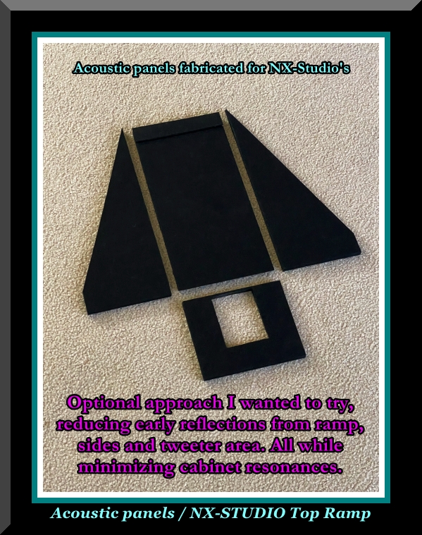

I did a experiment with these panels and really liked the result. For me personally, I liked it better than the NoRez on the top ramp of my NX-Studio's. Others evidently like the results, and have used the panels too. It's a cheap project to do, and I found the results meeting my needs.
IMPORTANT NOTE:

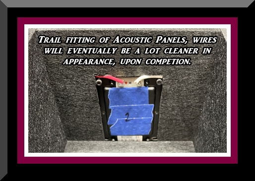

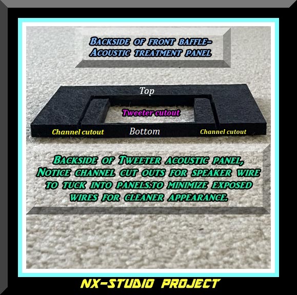

If you plan on using BXI panels on your NX-STUDIO'S, It will be a lot easier to make the templates for the front, sides and bottoms of speaker cabinet, with it unassembled. With each separate panel, you can tape tracing paper to each panel and transfer the angled lines accordingly, to the tracing paper. Now remove the tracing paper, and either tape it to cardboard, and cut to size. Making a cardboard template to layout onto the BXI Panels. I used tape to outline the overall parameter of cardboard template, attaching it to the BXI Panel itself. Then I simply removed the cardboard template from the BXI Panels. Now, you have a outline of the panel to the exact size you need, for cutting the BXI panels. You could tape the tracing paper outline directly to the BXI Panels, and cut out, however the tape doesn't stick very well onto the BXI Panels though.
I personally ran the sidewall panels the full length. The front panel will be not as wide though, because you have to subtract the thickness of each sidewall panel, then factor in your final front panel width dimension. The reason for this, is you insert the side panels first, then slide in the front panel afterwards for a snug fit. I do remember running the front panel the full height. Having the bottom ramp panel butting up against the front panel. The bottom panel will require a kerf cut on the underside of it, toward the front of speaker cabinet. The area that returns to being flat near the tweeter. The kerf cut allows the panel to bend / flex better in this area. Just be careful not to cut all the through. The other option is to cut two separate panels for the ramp bottom at the front, you'll just have to figure out the angles for butting up snug though. It's been too many years now, I don't remember the exact angles for my NX-Studio build.
Here is the link to the BXI Panels I used for my build.
https://www.amazon.com/dp/B077Q2HYMW?ref=nb_sb_ss_w_as-reorder-t1_k0_1_4&amp=&crid=3ET9AKC8VHPPC&amp=&sprefix=bxi+
If I ever decide to build one of the OB Speaker kits, excluding the Subs, I will attach the BXI Panels to the Backside of the front baffles. I'll machine the cut out's, for the drivers, and intergrate it to align up with cabinet sides and NoRez, for a professional appearance. I figure I have nothing to loose but time, and everything to gain if it improves upon the ottica's or my dream speaker, "The Extremes."

When Drummer messaged me with the Amazon link and the acoustic material was only $20 or so I thought it was worth the try to see what it could do. I never made the screen for the open baffle on top and I was thinking of painting the sides and even the ramp a flat black so I never peeled and stuck the NoRez and instead just laid it there so no painful removal for me.
The acoustic material is fairly dense and I just used a utility knife to cut the sections out and was able to get a tight enough tolerance where I don’t feel the need to glue or stick them in place. Took me about an hour to cut and place everything and let my amp warm up. I could tell right away the sound was cleaned up and detail retrieval was improved, especially with vocals but also with the pluck of stringed instruments.

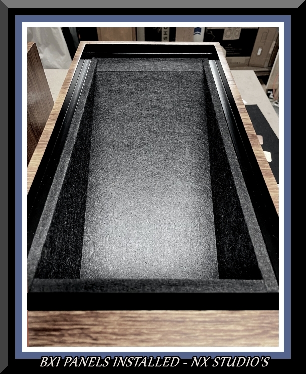

Hondurous Rosewood Veneer finish Note:
The removable knob on top of grill has a magnet in it. The grill frame does as well, for easy removal.
Top ramp shown (below) with BXI Panels installed

Just curious, is the backside of the front baffle necessary or did you do it just for being thorough?
A friend had his NoRez on the sides and ramp but nothing around the tweeter and so he decided to try and apply some felt there and noticed an uptick in detail so I think it must benefit.
The section around the tweeter was pretty easy to cut so I say why not, plus there is plenty of material to work with.

Yes nlitworld, I do suggest adding the BXI panel to the Backside of baffle. You'll need to cut out the panel for the tweeter though.
