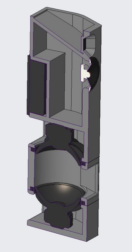

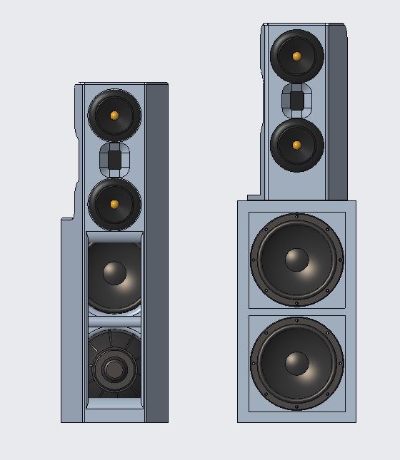

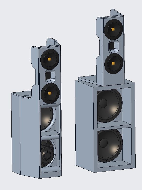

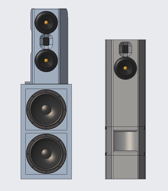

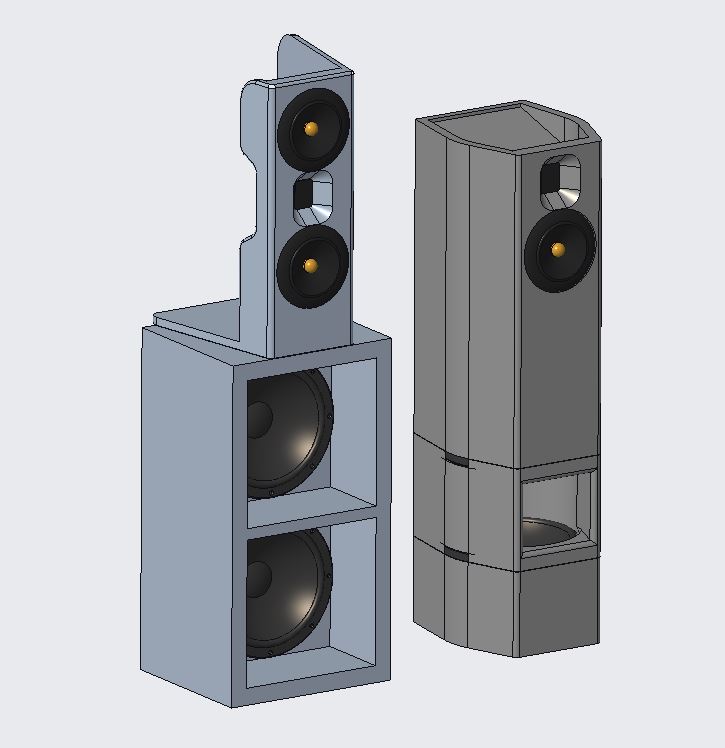

Ok, 2 more thought experiments.
- First, using the Studio as the basis for the top
- Second, trying to make them as skinny as physically possible
The study below is 44" tall, 13" wide and has the identical baffle width and about the same volume as the Studio for the upper part.  So the upper part is basically a slightly differently shaped Studio with the servo amp on its back.  Without the amp cavity it could of course be shorter.  I just remembered the amp is sealed, so I could ditch that wall.  Anyway... call it a brace.  :)
The lower section is basically the width of the driver plus a layer of veneer or laminate over it.  If the veneer/laminate were done as whole sheets rather than segments, it would look seamless (I deliberately showed the segmented nature to make it easier to understand).  Or its gaps could be filled and then primed/painted.
The sub driver frames become part of the structure of the tower.  3 screws front and back are accessible enough to drive externally, while the extreme sides would use 1/4" threaded rod epoxied in the top part and backer plates/nuts on the bottom.  I'd probably stick thin rubber gaskets between the parts for sealing and vibration.
I'm assuming that these GR drivers almost never fail, so that after an initial run-in of 30 hours attached to a scrap of plywood, that the odds would be solid that disassembly would be a moot point (a bonus if the whole sheet veneer/laminate approach were used, otherwise...  :evil:).
The open cross-section concern around the frame on the back side is made worse, but maybe it's fine as-is?
I think this could look pretty trim finished in white.

To be fair, you could also have the double servo subs with the Studios on top, with the Studios resting on isoacoustic pucks and it'd only be about 47" tall. I know this is all an attempt to make a more polished look to the speakers (and they do look like freakin cool concepts). With regard to function over fashion, that would be the easy way, but with any DIY stuff it's sometimes just fun to go crazy over the top. And a cabinet that curvy and complex needs a color much better than solid white or regular veneer.

OK, I'll be the one to say it -- there's no reasonable option for a "compact" Otica. Bigger is better, especially with open baffle. Don't waste any more time trying to design your own speaker. The work has already been done for you. Keep it simple. Order a flatpack and get started on that build thread.
Danny and Hobbs are working on a "compact" Otica on a single footprint using the 8" drivers, so maybe I'm not following you here.
In any case, as I've stated earlier in the thread, my goal isn't to improve on the NX line, or pretend I'm a speaker designer.  Other people (e.g. Danny, Linkwitz, Ridthaler) came up with the elements.  The point is, can I reconfigure those elements to get pretty good OB performance in a factor that would be acceptable in my space?  Tall speakers and multiple speaker footprints per side don't work.  Hence no flatpack order.
Also, weren't you interested in how well a ripole-based servo sub could perform vs the H-frames?  If they came close it would obviously open up a lot of design space that could in theory lead to more GR business.
P.S. -- for your 17x20 room size, you'll want a pair of triple OB servo subs.
In a different thread I believe Danny stated that a pair of dual driver H-frames can drive 20 Hz to way over 100 db in a decent-sized room, which is more capability than I actually need.  If I did need triples, it would be game over for OB bass.  I think it was the Spatial M3 thread.
Edit:  I hadn't remembered the quote quite right:
FYI, I took peak bass measurements in our old listening room that was 26 feet long, 17 feet wide, had 9 foot ceilings and a large opening to a dinning room in the back corner. I was measuring a pair of dual subs just like yours. They were hitting 115db peaks at 25Hz. They were not being over driven either. That's a lot of output.
Oh, and I was measuring them from 15 feet away.
Thanks for the feedback, and that's definitely a fair point--I'm still digesting the implications of what using the Studio with the OB subs could be.
Let me see what I can come up with a bit closer to the home designs based on that, perhaps with the amp integrated on the footprint.

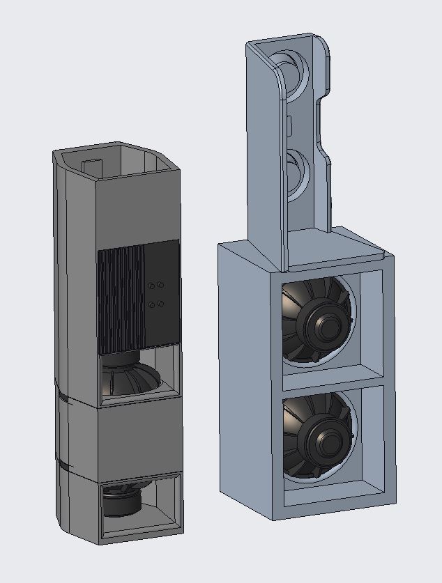

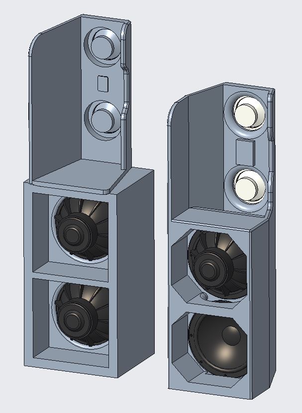

« Reply #72 on: 25 Feb 2023, 04:46 am »
You're an active and frequent contributor here (which I'm not), so I'll assume you're genuinely intending to help me save time and energy.  Thank you for trying!
That said, some people can't be saved.  :wink:   It's not how I'm wired--I tend to push hard to disprove a theory before giving up.  Do you know for a fact that a servo-based ripole can't come within striking distance of the H-frame performance?  I don't.  I've also searched multiple relevant forums and haven't yet found facts either way.

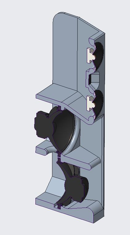

For a moment, let's go ahead and falsely assume the potentially useful ripole-based sub section isn't sufficiently on the money, and continue the thought experiments.
Here's a, for lack of a better expression, "very mildly S.L.O.B.ed" option pairing the basics of the H-frame with the MTM, dimensionally compressed as much as seemed reasonable.  This is 46" tall as shown, 14.5" wide and 15.75" deep.  The effective piston area for each driver on the front side has been marginally reduced from 76 sq in to 67 sq in as a result of aligning to the MTM baffle of 8.5" and trying to shorten the overall height a tiny bit.  On the back side, more than the 76 sq in Sd is open, with lots of heavy bracing.
Unfortunately, this option loses the volume for the amp, which would add at least 4" to the height. Here we see the potential penalty... an earlier ripole sub version was 43-44" tall while also including the amp on the same footprint.

Personally I think this one looks badass and is the most likely to give you top flight performance:

It seems counter-intuitive to get good sound from drivers driving into one another. Have you contacted Brian at Rythmik Audio to inquire about using servo subs in a ripole configuration?
I'm not the right person to attempt to explain how it works, but two drivers moving toward each other and squooshing air out through an opening about a 1/3 of their combined piston size seems reasonable enough to me.  The rest creates the dipole-like front to back separation, as I understand it, but with less energy out the back.
I do find the inherent force cancellation of the opposed drivers very appealing, especially since my living room is suspended over air space (vs a concrete slab).
I asked Brian and he didn't signal any problems with the servo system working.  Basically, he confirmed that it's an OB kind of construction, then confirmed that the servo would both work as designed and work regardless of driver orientation (up/down would be ok).  However, he didn't say whether he knew or otherwise thought that the acoustic results would be good, just that the parts would function (the drivers would go where they're told to go).
