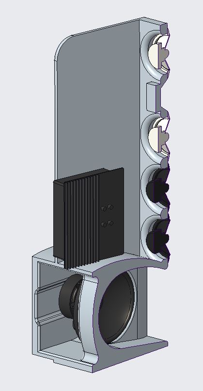

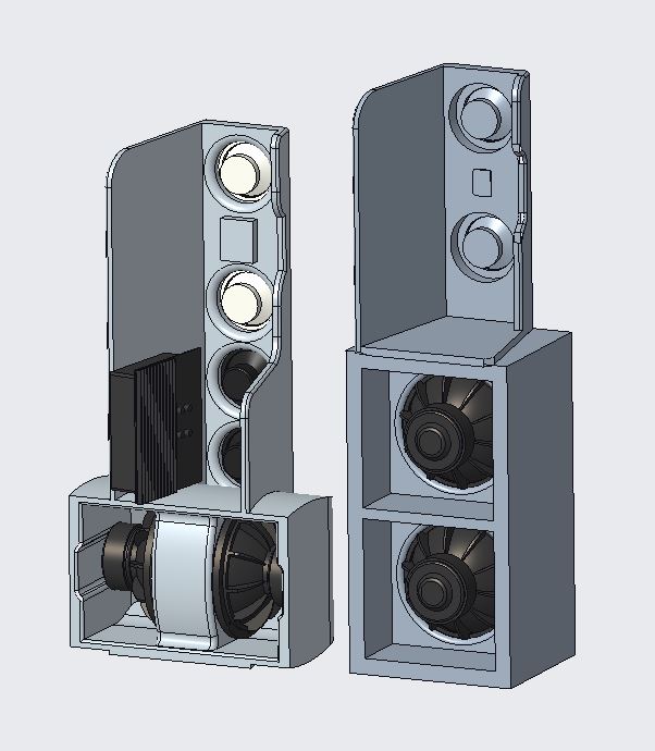

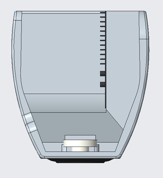

Here's a slightly different formal study to continue the exploration.  In the vertical orientation like this, I'm not sure I'm liking the effect of the big gulp sub opening.  It might work on its side, though.
Since I didn't change the back, but reduced the depth of the front zone, the amp would need a little shaved off the front corners to avoid having it stick out past the sidewalls (or ditch the amp, like Ed suggested). It also needed to grow an inch or two in height.
The other consequence of the front to back compression is that I lost some of the "wing" zone.  The other versions I've shown so far have the far corner of the wing at a 10 degree angle to the baffle and about 15-16" wide.  First, is that the right dimension range for the wing?
How much would be compromised if it were reduced to around 12.5", which is what this one has?  I'm leaning against reducing it, but it could help make the speaker smaller.

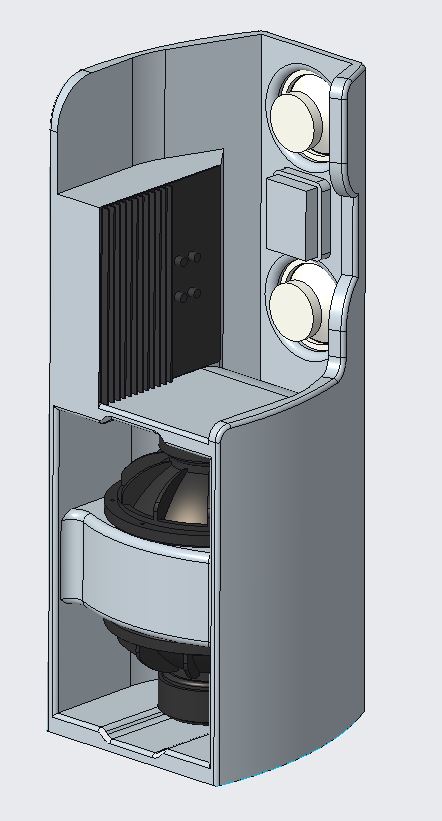

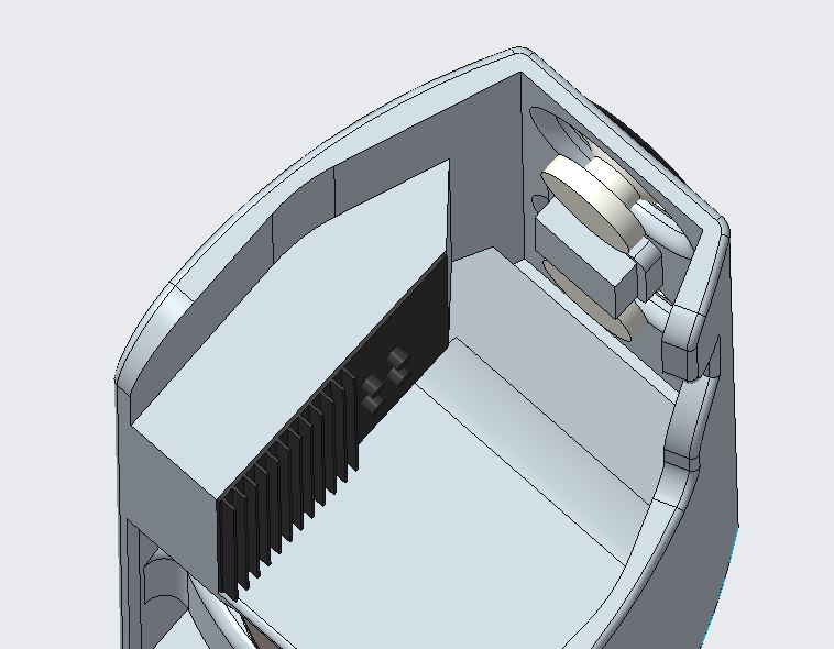

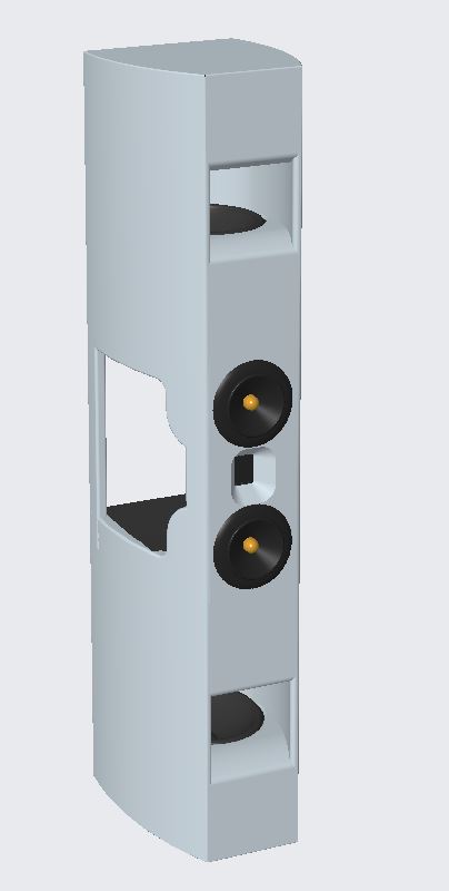

What would the acoustic impact be of having the amp on the inside of the wing?
This could also bring the overall height down to the 41-42" range (which it also would be with the amps externally).

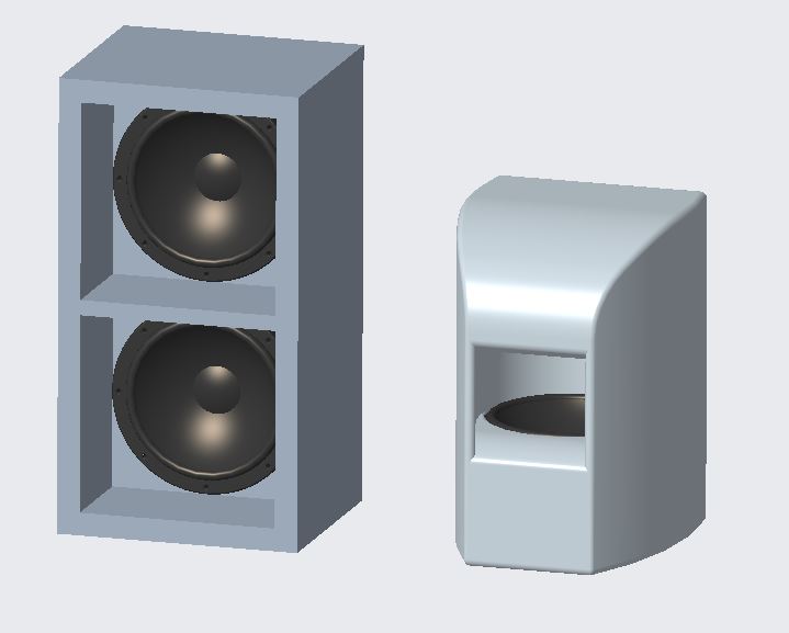

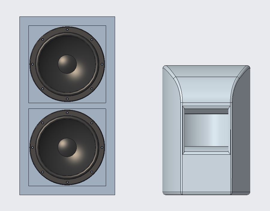

Standalone subs aren't my current design intent, but in case someone finds it interesting to visualize--on the CAD journey to explore Tyson's suggestion of putting the sub part on its side I tried out what the ripole section could look like on its own.
This is 21.8" high as shown.  Most of the exterior curvy stuff could be replaced with flat panels, of course.

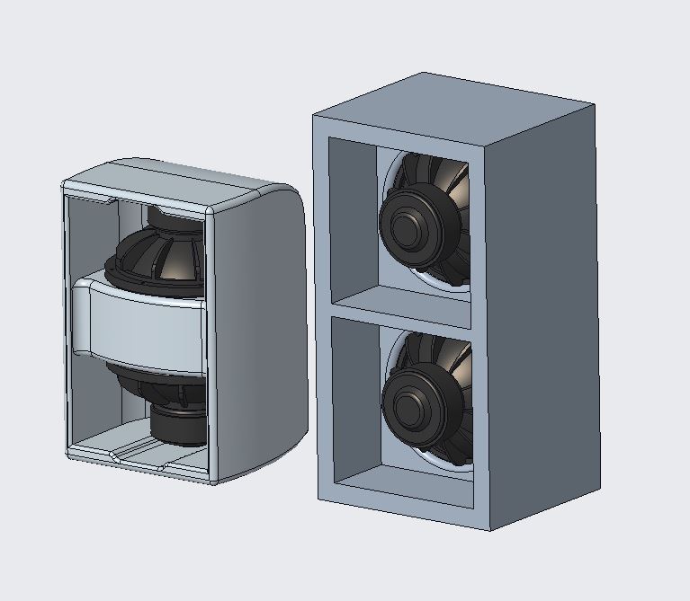

Here's another thought experiment where the ripole sub section is placed on its side (what I thought you'd meant earlier).  While the whole thing would get rather wide at 21-22" at the bottom, the speaker could be a chunky runt at like 30" high... presumably too short.  I trimmed the upper part to typical Otica flat panel proportions (at least as far as I understand them), which makes getting the amp in there a bit challenging.  Maybe it could be tucked in on the side sort of as illustrated.  For kicks, I then added 2 of the Otica woofers down low, which would put this at approximately 47" tall.  Or they could be deleted and the amp and crossover could live below the MTM section.
Definitely a little funky, but there are probably (hopefully) weirder things out there.   :wink:

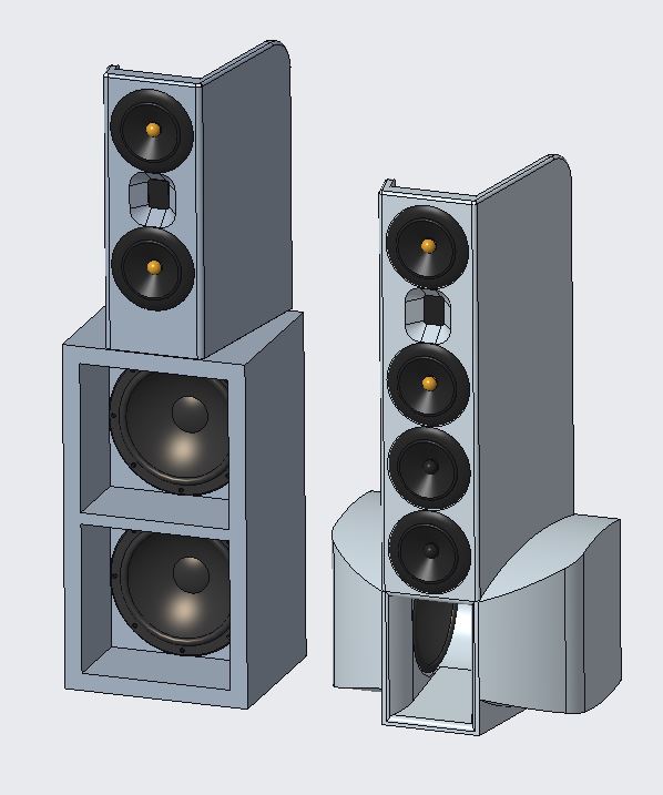

In your honor... introducing the Tyson Tower.  A 66" tall stack of OB goodness.  2 amps, 4x 12" drivers.  Who needs those wimpy little midwoofers when you can double down?   :)
In theory the upper set could also be the 8" servo drivers.  Too tall (and $) for my main room, but fun to dream about anyway.

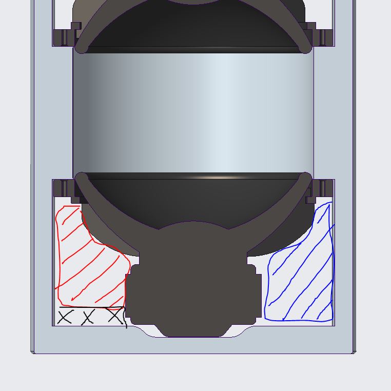

I've been wondering how much open area to the sides of the baskets needs to be retained?
With these high excursion drivers I was concerned that if I reduced the cross-section too much by sinking in the magnets and/or trimming the angle down, that there would be noise--whistling, chuffing, whatever--past the basket and other driver features.
Here's an image showing what I was describing... what's the limit to how much the area can be reduced?
Are people using some sealant around the magnets in the ripoles like in the photo?
