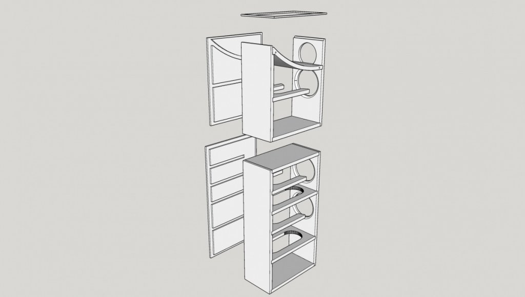

Here's a concept drawing of an idea I half explored a few years ago. I think Danny still has the prototype.
Sure do, they're currently upstairs in the shop.
I love this modular concept so much.  :thumb: Might it be possible for current Studio owners to get the bottom as a "floor-standing expansion kit?" I have some Studios and would totally build these bottom portions boxes, especially if it took minimal (or no) crossover modification to the original Studio.

The original concept was centered around a modular waveguide for the Neo-3 and the bass cabinet to be powered by a plate amp with adjustability similar to open baffle amps. It seemed like a natural.
Alas, my strengths lie in woodworking and imagination, hence I needed an acoustic design partner to see it through. For a variety of reasons, the project was stillborn but perhaps it will catch some steam in another iteration.

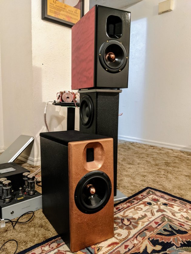

Have a look at the "Best Speaker Stand Ever" that Hobbs and others use.  I think these are actually open in the back.  There is a thread about them with discussion, but the links to the pictures are broken. I would think you can get the plans for this from Danny & Hobbs.

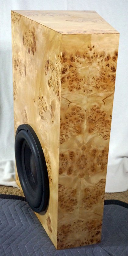

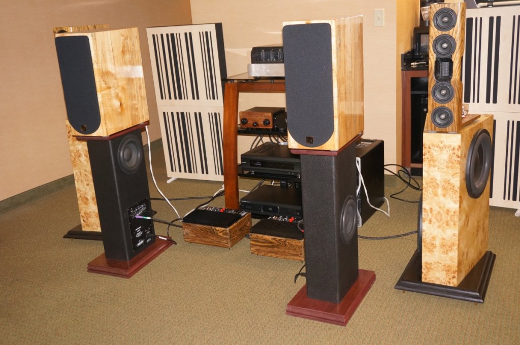

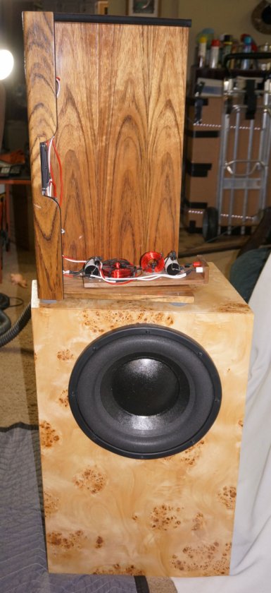

The only problem with these stands at the moment is that they use the 8" open baffle servo subs which are currently unavailable. Another option, which is shown in the top picture,  is to use two 12" open baffle servo subs in the stands like I did with this pair for under the Wedgies
The wedge shape was done to match the footprint of the Wedgie. You would want to widen the front to match the rear for use as stands for the Studio Monitor. This style stand, with the closed front, gives up some performance compared to the H-frame but since it doesn't radiate like a true open baffle, can be placed closer to the wall.
