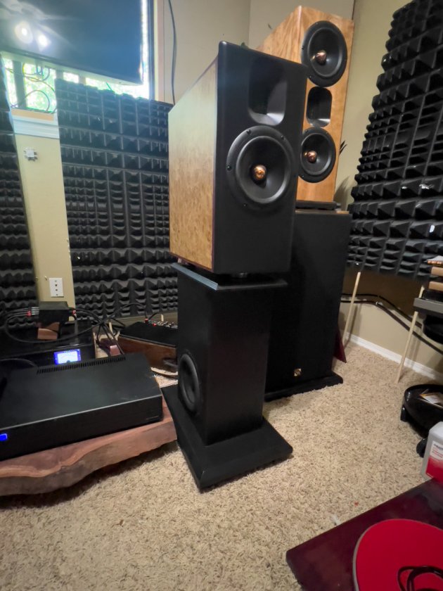

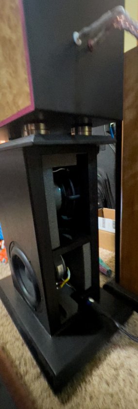

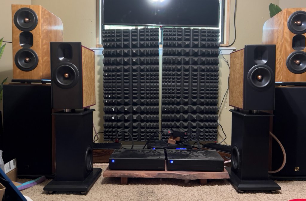

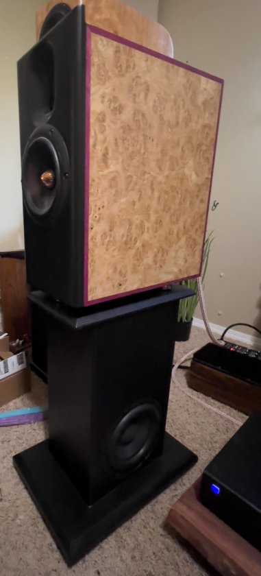

Here are some pics of the dual 8" servo sub speaker stands for the NX-Studio Monitor. what I was after was recessed drivers and a stand height that when combined with 2" isolation footers under the stands (here I'm using Gaia IIIs) and isolation seperators between the stand and Studio Monitor (here using Isoacoustics Orea Bronze pucks which are 1" thick) the center of the tweeter would be 39" from the floor as this is ear height for me on my couch. With the GAIA IIIs and Oreas, the center of the tweeter came in at 38.5" without an amp in the stands. The height can be increased to move the tweeter center up higher but there isn't any room to make the stands shorter.
These stands are stout. The side panels and top are 1.5" thick BB, the base is 2.25" thick BB, and the front panel is 3/4" thick BB across the interior opening. The inside is lined with No-Rez.
While not exactly a floorstander, these sub stands accomplish the goal in fine fashion.
These will be playing at LSAF in Dallas June 7-9. If you are in the area, drop in and have a listen.
Mike

These stands look very cool indeed! And they are just the form factor I was thinking of. How do they sound? From what I read about the earlier version, they would not need to be too far out into the room, correct?
 A couple of questions:
- It looks like you have put quite some effort into isolating the monitors from the stands. Do you feel this is important? I’m imagining a single enclosure with NX studio on top and the 8 inch OB drivers in the bottom.  Any thoughts on how such a design would compare?
- what is the cost of the 8” drivers?
- the Bully is about $2,600.  It looks like what you have put together would be about the same cost (kit parts without cabinets).  Is that about right? Maybe apples and oranges, but how do you think they would compare?
Thanks!
