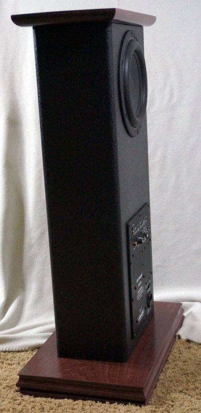

Yes, the sub amps are external and sit on the floor behind the cabinet.

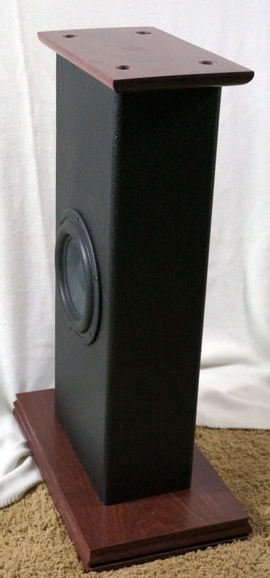

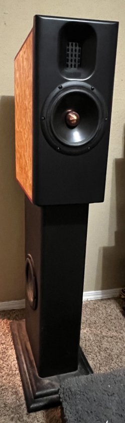

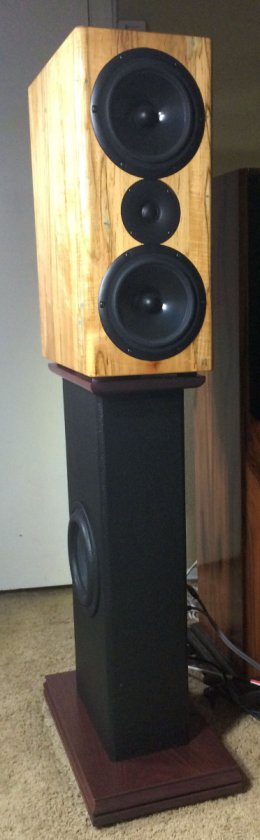

Here are some pics of a couple of the Best Speaker Stand Ever (BSSE) with X-CS Encores and a Studio Monitor
This combination will get solid performance down to 30Hz and the monitors have to be on a stand of some kind anyway. As Hobbs said, these drivers are in stock even though they don't show up on the website.

They are one of Danny's designs. https://www.audiocircle.com/index.php?topic=129161.0
They can be placed close to the wall. This would be a killer combo, especially if the choice of the Studio Monitor is for it's ability to be placed closer to the wall which is lost if the monitors are on top of open baffle H-Frames.
