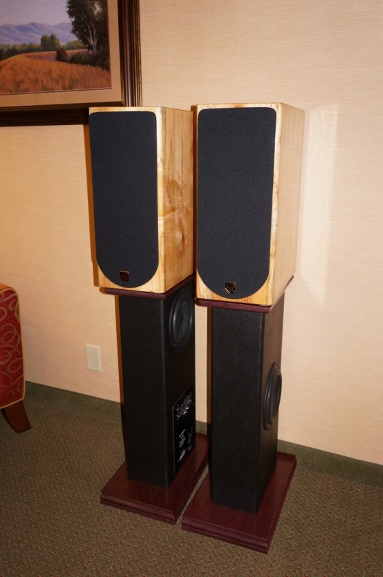

Danny designed a model a few years ago he called the best speaker stands ever. They used the 8" 16 ohm subwoofer drivers and an HX300 amp. Now that Danny is bringing in more 8" drivers, or at least plans to, this model should be available again in the future.
Here are the stands paired with X-CS Encores

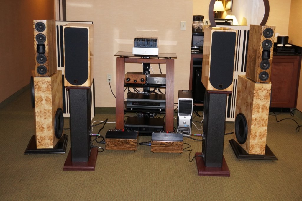

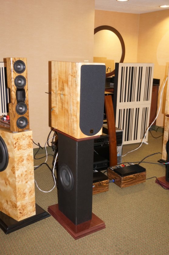

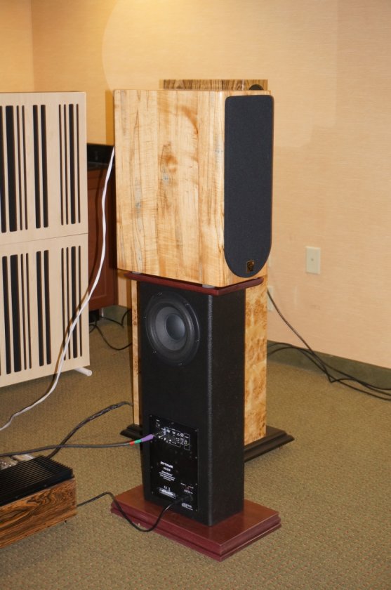

I used the 8” drivers in the stands as mid-bass drivers crossing to a 12” sealed servo sub (sub kit 2) at 30Hz. Having the low bass sub separate from the speakers allowed the sub to be placed for optimum bass response at the listening position.
The 12” sub will easily reach up high enough for the NX-Studios so the 8” drivers aren’t necessary. Letting a 12” servo sub play up to 70Hz and the Studio Monitors play from 70Hz up gives you a three way full range speaker system that is easy to set up.
The addition of the 8” drivers allow rolling off the midrange driver off higher, around 200 Hz like the NX-Otica does. In this configuration the 12” servo sub covers up to 30Hz, the 8” servo sub drivers cover from 30-200 Hz, and the Studio Monitors cover from 200 Hz up. This gives you a four way speaker system that is fuller sounding and more effortless but is more expensive and considerably more complex to set up.
