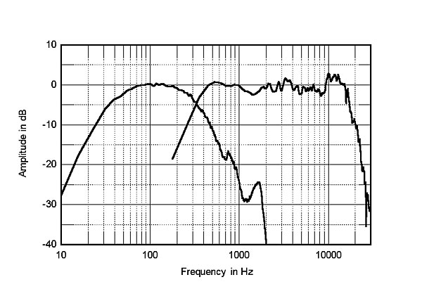

https://www.stereophile.com/content/acoustat-spectra-1100-loudspeaker-measurements
The review from stereophile seems they subjectively do some nice things with a few caveats that are explained in some measurements. Particularly look on this page at Fig.7 and Fig.8 photos of the off axis response and the waterfall. The off axis drops off considerably before returning with a vengeance about 10k. To fix this, do as much toe-in as possible to position them right at the listening position.
On a side note, those things are impedance monsters in that with the treble contour control set to high it drops to 1.1ohm at 20k. Set that control to medium and call it a day. Your Parasound is a good match here.
Start with moving your speakers around and possibly some more room treatments and see where that gets you. Should be some good improvement to be had with $0 investment. Can't beat that. If that doesn't fix things for you, I'd shop other speakers before tearing into your Theta components. Those "should" be way high enough quality to be using good materials inside.

WGH
And the sound has a dip in the vocal midrange followed by a peak in the treble then a roll off in the upper treble.
But that roll off would be the Acoustats, as they naturally roll of at about 16k.
Looking at John Atkinson's measurements, you are hearing exactly what the Acoustat Spectra 1100 speakers were designed to sound like.
Acoustat Spectra 1100 loudspeaker review and measurments
The review says that careful amplifier selection and room size makes a big difference.
By ignoring the sensitivity of these speakers to sloppy setup and indiscriminate selection of power amp and cable, the Class B recommendation will most surely be compromised. These speakers require care and nurturing if they are to sing.
In particular, the woofer region is elevated by 6dB or so compared with the general level of the panel, while this panel's overall smooth response is broken by a degree of presence-region boost and an early top-octave rolloff.
In a larger room, the outputs of the two disparate drivers would integrate better.
Just by chance your homemade speakers probably have the same problem.
As you have found out, no amount of equipment change-ups or cable swaps will compensate for the wrong speaker in the wrong room.
