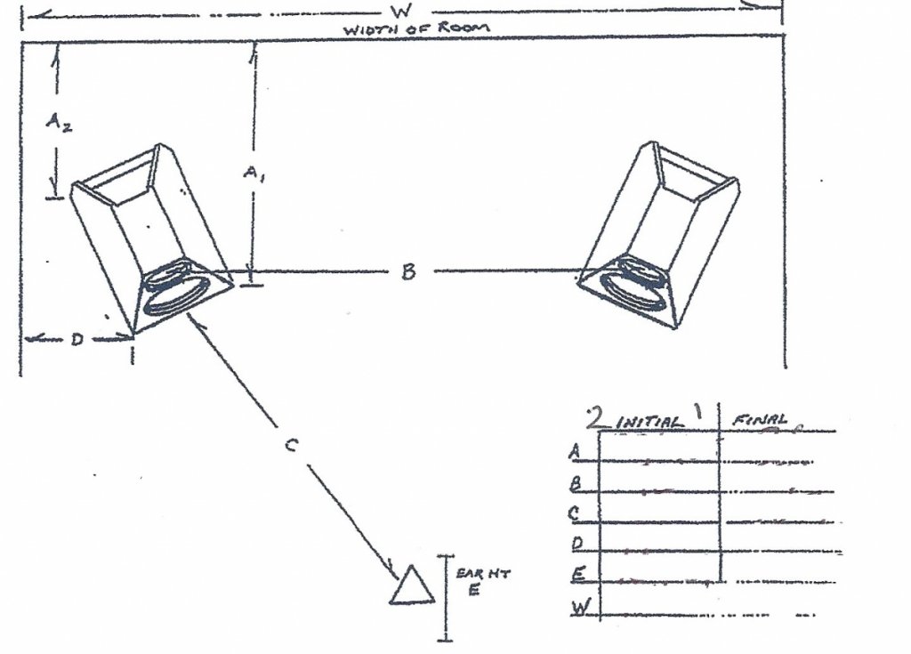

It's the dealer worksheet for the Wilson Audio setup procedure - WASP, that you talked about in your post.

As I posted, it's a dealer worksheet for the Wilson Audio setup procedure, so you're not going to see it unless you're a dealer or a Wilson owner.
I've watch a top Wilson dealer do the WASP two times. Wilson trains their dealers to perform this procedure.
FYI, when you buy Wilson speakers you don't get the extended warranty until a trained* Wilson dealer does the WASP and submits the worksheet.
