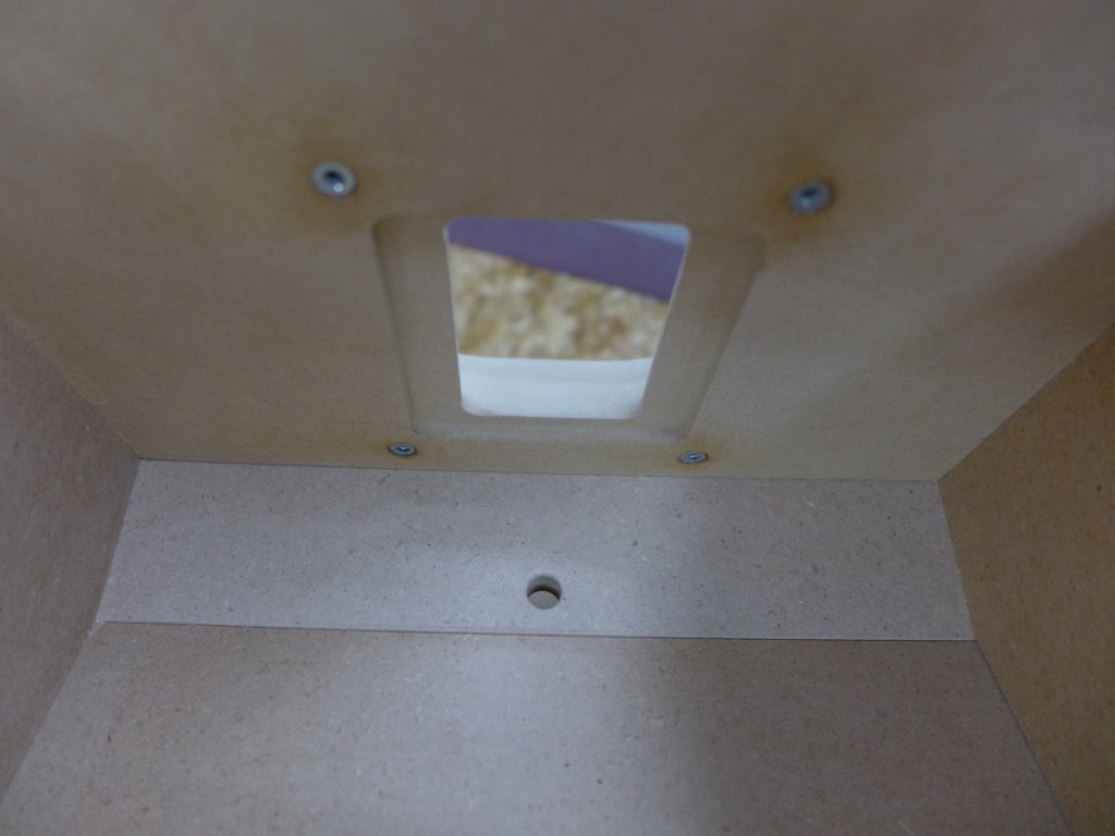

I'm still waiting for my main order with NX-Studio kit, but I have just received a flatpack from Jay and I'm starting to plan my build. I've watched Peter's video on cabinets assembly but still I have a few questions:
  • If I understand correctly, tweeter's and woofer's enclosures are sealed from each other completely. Thus I need to drill 2 holes for a wire between a crossover and a tweeter. Where is the best place for it?
  • If I paint glued cabinets from outside, the inside area will remain uncovered. Sure, woofer's enclosure is sealed but the air may go inside through binding posts. Isn't it bad for wood?
  • Even if I implement something like this https://www.audiocircle.com/index.php?topic=177748.0 for removable crossovers I won't be able to remove them because they will be soldered to binding posts and GR Research's tube connectors are not really removable. Am I right?
  • Maybe it is a good idea to make speaker's bottom removable in order to be able to remove crossover without touching drivers and binding posts. Are screws a bad idea instead of glue?

You'll get lots of help here in forum and others will contribute additional but here's my answers.
1- yes, lower cabinet containing woofer is sealed separately from the tweeter that remains open.  Yes, two small holes to pass the two wires from crossover inside the sealed portion of cabinet to the tweeter above.  Those holes are best placed just below and behind where the tweeter is mounted.  It will feel pretty intuitive as soon as you dry fit the cabinet pieces together to visualize fit and procedure.
2-yes, paint on the outside will seal the exposed mdf from absorbing moisture from the atmosphere. Unsealed inside will allow those surfaces to absorb moisture from atmosphere.  This is normal and wood always seeks equilibrium and tries to match its moisture content to its environment, dry or moist. If you live in a high moisture environment such as coastal air, or high humidity than this will have greater affect than in a milder non-humid climate.
Others may disagree with me and say that sealing inside is absolutely necessary, which is fine, and personally I like to always put in the extra effort.  However reality is that most retail speakers are unsealed or inadequately sealed and they hold up just fine.  Unless you live in a high moisture or highly fluctuating environment, it may not be as critical as you think, but again no harm in the effort. My point is only that this should not be a point of stress. Just do the best you can. Your speakers aren't going to start crumbling or deteriorating if you haven't sealed them inside. They will perform similar to every other unbalanced or unsealed wood surface in your house (dressers, cabinets, bookshelves, tables, etc)
3- yes, if you ever wish to fully remove your crossovers from the cabinet, you will need to either desolder a few connections or install them with enough internal wire slack to pull the crossover out through the woofer opening and place it in front of the cabinet. That means longer wire to tube connectors and to tweeter.  Desolder options are disconnecting at crossover or at the driver end. For the input connections I probably wouldn't desolder the tube connectors as they are a little more difficult of a connection, I would instead desolder the wire connection at the crossover. For driver connections I'd desolder at the driver terminals. Yes, screwing the boards to base will be easier to remove than glue, as long as you can reach the screws.
4- no, you probably don't want to build your cabinet with a screwed in only base, or removable panel.  The driver opening is plenty large for you to remove and insert the crossover board through the driver opening.  Front baffle is 8.5" wide externally, 7" wide internally, minus the thickness of norez on both internal side walls and your probably in the ballpark of 5.25" max width of crossover board and a 5.75" opening for the woofer.  No need for any special trap door.

Elon covered your queries well, but I'll add a few things.
1. I like to bring wires through a single hole located right behind tweeter. 1/4" can accommodate twisted pair. 5/16" is easier to deal with. Before woofer install, I use what I know as dum-dum to smoosh around wires/hole.
2. This is where theory runs down a rabbit hole and contrasts with common practice.  If it were a real liability we'd have thousands of speaker box failures, both commercial and DIY. Balancing a panel is sound practice, but once a structure is assembled, it's value in likely negligible.
3. I typically center a couple of pan or washer head screws front and back. Not drywall screws which are designed and intended for drywall (one of my pet peeves, can you tell?). At some point I may try the grill fasteners, but removal would be harder than screws, methinks.
4. Removable panels have their place, but IMO juice isn't worth the squeeze in this case, and it compromises the cabinet structure somewhat.

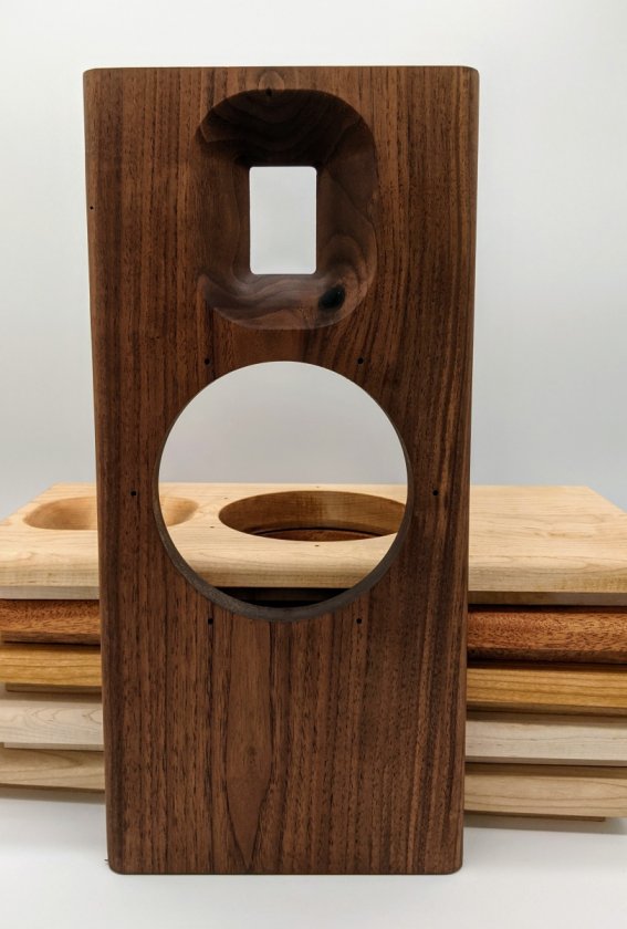

Hardwood?   :o :o :o  Gonna have build another pair!  Gives me a chance to correct my 1st timer errors.  Will these be on the site or by request only?
Here's one made from Walnut, along with a few other varieties like cherry, maple & mahogany lying behind it.
These will be sold as front baffles only, and aren't compatible with Jay's flatpacks.
We are waiting to hear back from Killian on their final costs as they my vary based on wood type

« Reply #11 on: 9 Oct 2021, 03:45 pm »
Excuse me while I drool over that walnut baffle. That would look killer with some well matched walnut veneer on the rest of the box!
Thanks for the cool picture Hobbs!
I think I'll ask a flat +$120 (+$200 total...$80 is built into the cost of the kit) for all species.
That'll be for maple, mahogany, cherry, and walnut.
They will be sold unfinished so that you can pick what finish you'd like and not have to worry about squeeze out or small scrapes during assembly.
We've been using Rubio Monocoat to great success and I'd recommend using it for finishing these baffles!
