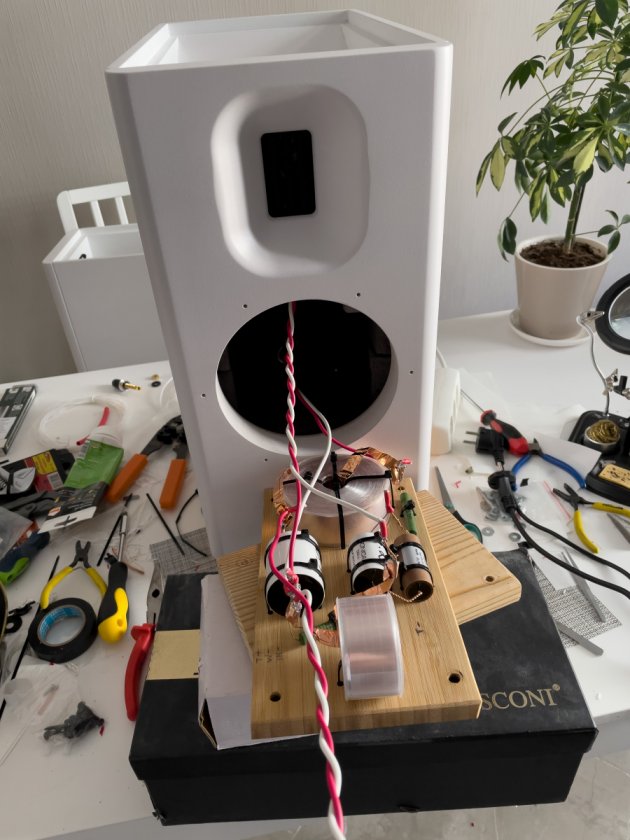

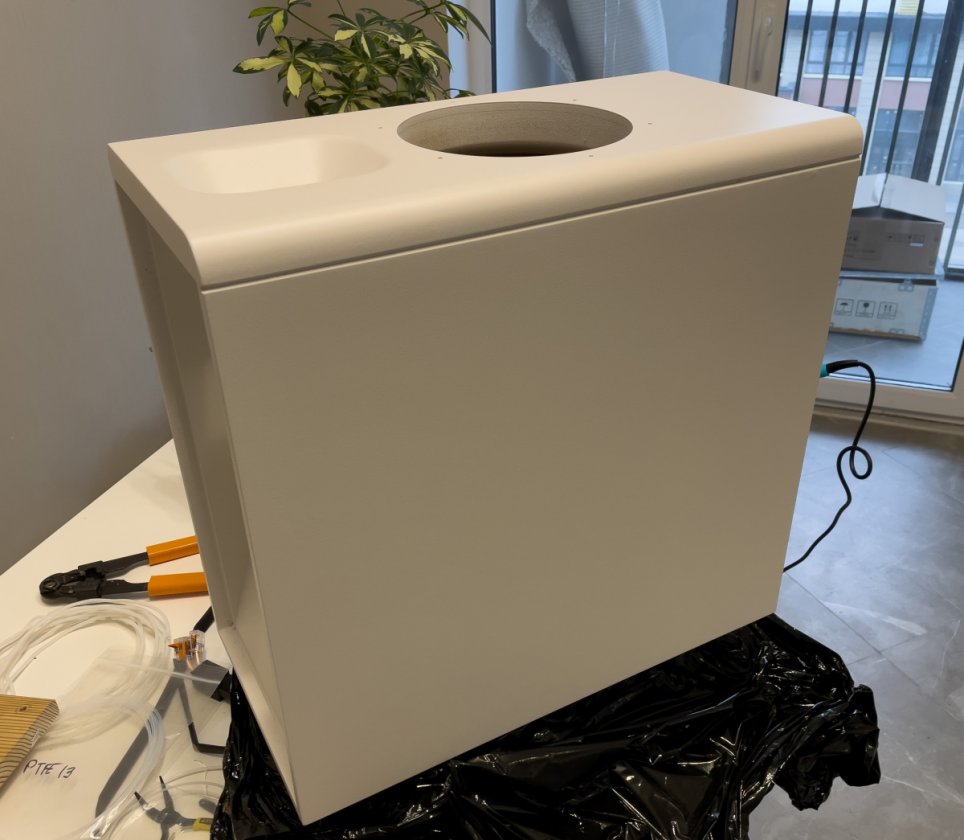

OK, I'm ready to show some progress.
I used Jay's flatpack.
I don't know how you guys do it but cutting No-Rez was NOT an easy task!
I wanted to make crossover replaceable, that's why I drilled 4 holes for bolts at the bottom. I used IKEA's cutting boards for crossover.
Time for gluing!
Not a perfect work but it was my first time.

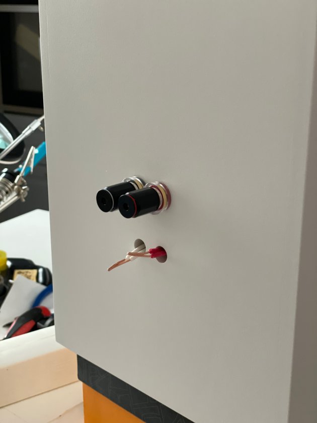

As you can see, I decided to make additional holes for binding posts.
zlib
  • Posts: 38
Re: NX-Studio build
« Reply #32 on: 12 Mar 2022, 04:30 pm »
I didn't have a proper space for painting the cabinets, so I took them to a professional. He pointed at some visual problems.
First one is not a perfect symmetry around the tweeter:
He said that he would try to fix it (without any promises).
Second one is joints of glued MDF parts — it's almost impossible to hide them with painting (and my gluing work is far from perfect). He proposed to make hems in order to hide the flaws.
Here is the result.
Gluing No-Rez is much easier than cutting it.
Top part has some problems with painting. The painter said it was due to my gluing work. Not sure about that but it will be covered with grill anyway.

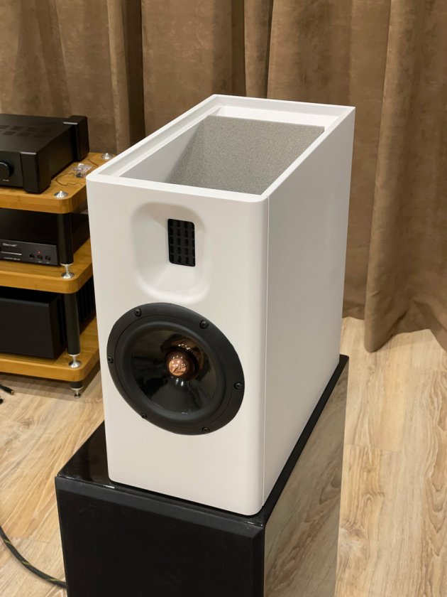

Here is the final assembly:

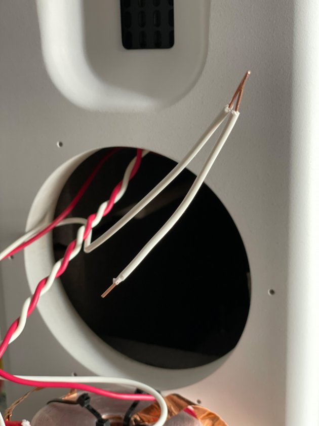

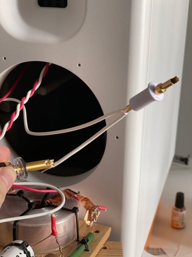

The length of supplied wire is limited to just one pair of tube connectors, but I wanted to use the same wire for normal binding posts too. Here you can see my solution:
And... they are ready for listening! I'm using traditional speaker cable with spades right now. And it sounds pretty good!

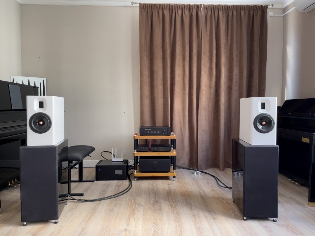

I don't have stands for them, so they are standing on bottom section of Hyperion HPS-938.
The funny thing is I use bi-wire connection for Hyperions and after I connected NX-Studio I forgot to put out speaker cable from bass section of Hyperions. The bass was unexpectedly deep and large but the overall sound was somewhat muddy and veiled. Then I disconnected Hyperions completely and everything started to sound just as I expected.
I'm a picky one, that's why my jaw hasn't dropped. But I must say my NX-Studio produce an impressive sound. You can hear all the details in the recordings and I like that.

Looking great. I love the white color and attention to detail!  :thumb: :thumb: :thumb:
  • Posts: 11647
Re: NX-Studio build
« Reply #39 on: 18 Mar 2022, 04:00 pm »
Very nice!!!!  Those look super cool.  They'll sound ever better when the speakers underneath are taken out of the room.  Why?  Because the drivers in the Hyperions will act as passive radiators and re-radiate any bass from the NX-Studios, making the overall sound less clean.  Proper stands will eliminate this, of course.
Also, the NX-Studios sound good out of the box and you will notice substantial improvements at 50, 100, and 250 hours due to the high quality parts in the crossovers.  Burn in is very real with these guys.
Are you planning on building out some OB servo subs to mate with them?  OB subs (especially the servo ones that Danny offers) mate particularly well in small and/or difficult rooms.  They also make amazing stands for the NX-Studios.
