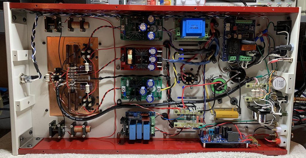

I've been working on my plan for the 300B amps. As I mentioned, I ordered the ANK C-Core Interstage Monoblock kits without the chassis. I am going to use Front Panel Express to make the the panels for the chassis. This will add a fair amount to the cost, but I've been very impressed with their quality and their design tool is easy to use. I'm going to powdercoat the panels using their Gray-White color. This is the color I'm using for my new preamp (almost done) and it's come out really nice.
To the normal kit design, I'm making the following changes:
  • Both balanced and upbalanced inputs with a toggle switch to switch back and forth. The balanced inputs will use a Jensen 1:1 line input transformer. Viborg gold over copper connectors.
  • Dual speaker connections with EIZZ binding posts and GR-Research Tube Connectors.
  • Neurochrome soft-start with front-panel mounted illuminated vandal switch for power on/off.
  • Speaker protection circuit with turn-on delay to allow the voltages to come up to spec before connecting the speakers.
  • Regulated DC power supply for the 6SH7 driver tube heater (standard kit uses an AC heater circuit).
  • Neurochrome 21st Century Maida Regulator for the driver stage B+ (standard kit derives this with a simple RCRC filter from the main B+).
  • Grid resistors on all three tubes upgraded to Audio Note 2W Non-Magnetic Silver Tantalum resistors.
  • Extra-thick chassis panels to improve stiffness - top and bottom panel will be 6mm (standard kit uses 3mm panels).
The chassis size will be a bit bigger than the standard kit to accommodate all the extra PC boards (a couple inches in width and length). This will also allow the transformers to be spread out a bit more which will reduce magnetic flux leakage interaction.
I kind of like the look of the C-Core transformers, but the main power transformer and choke are pretty ugly, so I plan to build a cover as part of the enclosure design - probably powder-coated black, but I'm considering something like red or blue just for fun.
Once they are up and running with the default tubes, I will start thinking about some tube upgrades - particularly the 300Bs (thinking about Takatsuki, new WE reissues, or LinLai Elite).
Here's what the standard kit looks like (one channel shown) - I'm keeping the copper plate  :D

Jaytor
Re: 300B SET for NX speakers
« Reply #15 on: 16 Oct 2021, 02:23 pm »
Jaytor -- go ahead and make another set for me, man. Thanks. 8)
You're gonna invite us to participate vicariously through a build thread, right?
I am posting a build thread on the Steve Hoffman forum for anyone that is interested.
https://forums.stevehoffman.tv/threads/ank-300b-interstage-monoblocks.1112018/

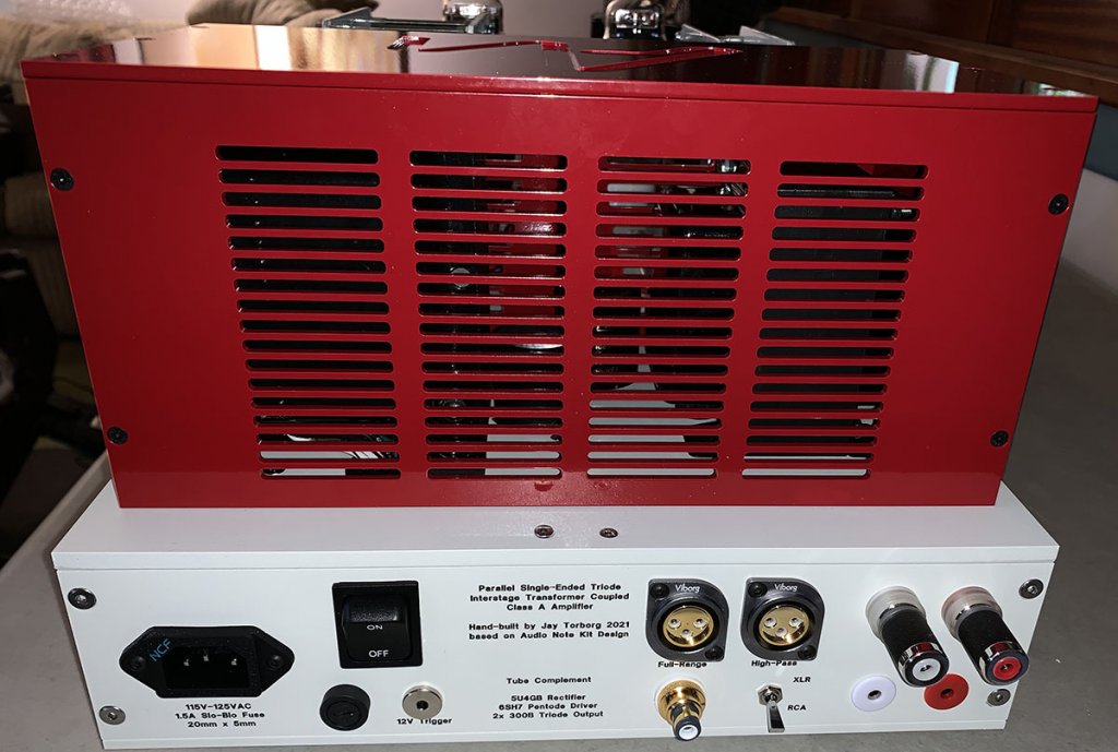

Jaytor
« Reply #16 on: 27 Nov 2021, 08:08 pm »
My first amp is complete. See the previous post for a link to the build thread on SH.
Now on to the second one.
mkrawcz
  • Posts: 662
« Reply #17 on: 27 Nov 2021, 09:18 pm »
Dude! That is some serious business right there.
