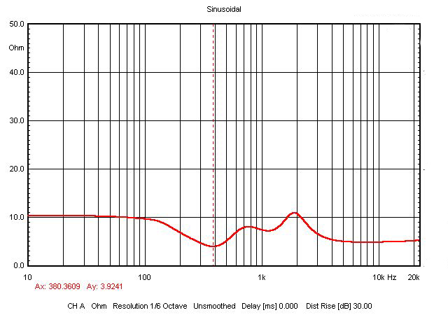

More important often than the sensitivity, with a (typically) highish Rout for an SE amplifier one is typically looking for a flat impedances curve, as this interacts with the highish Rout.
I could only find curves for the NX-Treme. Not particualrily pretty.
I'm really building these to use with my Line Forces once they are done. The impedance curve is more friendly. The below from Danny.
But even the NX-Otica/NX-Tremes have fairly easy impedance curves - only dropping down to 5-6 ohms. And since they are used with active subs to cover the bottom octave or two, I don't see this as a problem for a SET amp.

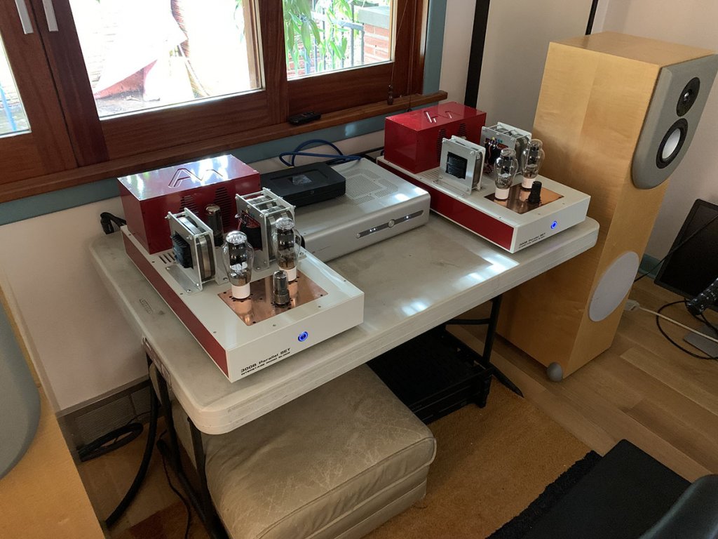

Jaytor
Re: 300B SET for NX speakers
« Reply #35 on: 13 Dec 2021, 06:18 pm »
I finished the second amp this weekend. When I first hooked it up, I wasn't getting any sound despite all the voltages looking fine. After checking everything over, I finally started swapping tubes and discovered the 6SH7 driver tube was bad. Fortunately, I had a small stash of these I bought a couple months back from someone on etsy since they were pretty cheap. So I was able to get both channels working. I've asked ANK to send me a replacement since I think the NOS Raytheon tubes included with the kit are a bit better.
I'm going to burn them in for the rest of the week in my hobby room/workshop and try hooking them up to my NX-Oticas this weekend.
I'm also planning to order a set of nice 300Bs. I was leaning toward the Takatsukis, but I think I'm going to go for the new Western Electric tubes. It's easier to get a matched quad and the five year warranty is reassuring. And the various reviews I've read seem to regard both these tubes at about the same quality level. The WE tubes are also made in the US, which is definitely a plus.
