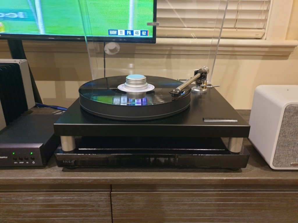

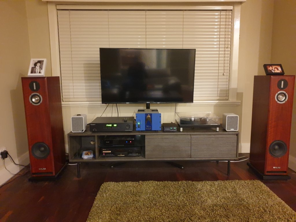

Hi Guys,
I have a problem with an interaction between my Bryston Turntable, wooden entertainment unit and my wooden suspended floorboards. I am having quite a bit of rumble which is just noticeable in my listening position.
I am thinking that I need to isolate the turntable from the entertainment and my wooden floors. I've been looking at this product and I am wondering if anyone has had experience with turntable isolation platforms and whether they work or not. This is a cheaper option as most seem to start at about $600 australian dollars.
https://auralex.com/iso-tone-turntable/
Thanks for your help.  Cheers Rod

I highly recommend anything made by IsoAcoustics and I use their "orea" products under my turntable and motor. BUT, looking at your picture it looks like you would benefit either from getting rid of the cabinet, or using something like the orea's under the cabinet feet as well as the turntable. I have tried the DIY route and then moved to Herbies products which were an improvement, but at some point I think it's better to just spend the money and try some Orea's--you should be able to get them with a return option if not satisfied. Good luck!

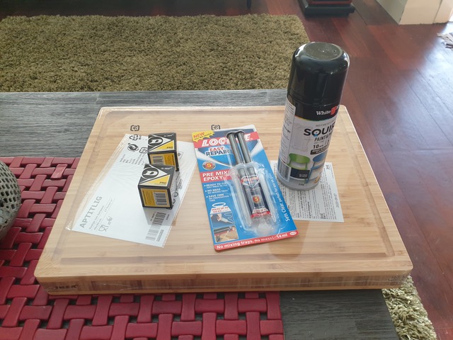

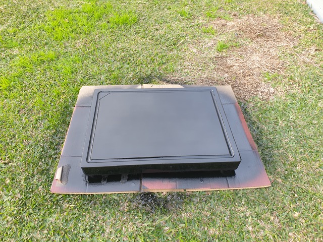

Hi Guys,
Okay, it looks like I've mostly solved the rumble issue as I went diy instead of purchasing a specific hifi turntable isolation platform. These platforms  seem to range from $500 to $1000 australian dollars which is pretty expensive as I can buy a new turntable for that price.  I bought a kitchen cutting block from ikea and I bought 2 squash balls. I cut the squash balls in half and glued them to the bottom of the wooden cutting block.
I sanded the wooden cutting block and painted it in high gloss paint. Tomorrow I'll buy a black flat finish as it will look better imo.
I would say I have reduced the rumble by at least 70% or more. I am totally satisfied now!
Cheers Rod

Hi Mark,
This really came about by necessity as I didn't want to spend a heap of money on a turntable isolation platform. In australia they range from $500 to $1000 australian dollars. Far too much imo.
I'll sand the platform back tomorrow and use a flat or semi gloss as the high gloss really shows up all the faults in painting it.  But it works really well. I think you play racketball in the USA which is a much larger ball but I am sure you would be able to get some squash balls which are about half the size of a racketball.
All I can say is that is has greatly reduced the rumble by about 70% that I was experiencing before. Its a non issue now. Back to listening to music again :).
Cheers Rod
