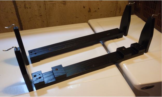

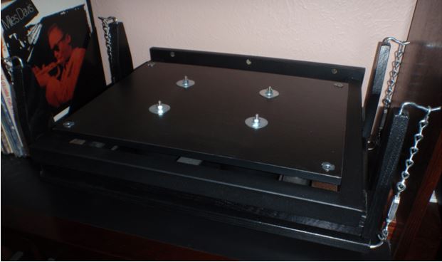

Fig. 1 - Turntable isolation stage - The Overview.  (exploded views in upcoming figs)  In addition to the basic low natural frequency mechanical goal, desires were to come up with an assembly that was:  A) Reasonably compact  B) Appeared to be resting on the cabinet below  C) Still allowed clear access to the turntable above the dustcover bottom edge.
Fixed parts bolt onto the bottom of the TT-1 shelf and extend 4 towers up vertically.  The pendulum chains are approx 9 inches long, giving a natural swing frequency of about 1 Hz.  The chains suspend the lower swing platform.  The upper swing platform is directly coupled to the lower by large tubes reaching up through the shelf bracket internal open spaces.  The upper platform carries the turntable and is free to float approx +/- 0.4 inch in any horiz direction.

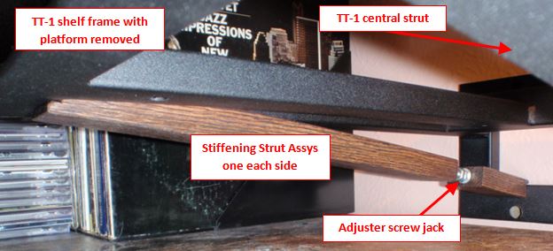

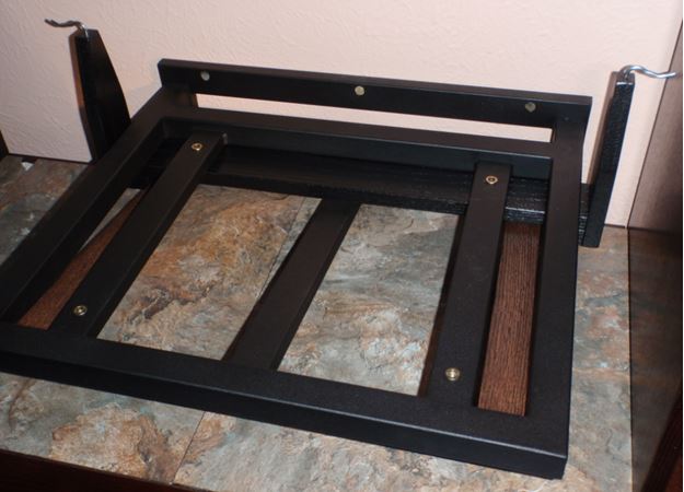

Fig. 2 - TT-1 shelf frame and first mods - underside view - The TT-1 model has only the one slightly diagonal strut in the center to stiffen the horizontal shelf frame.  The mass of all items I was planning to add would push close to the approx 55 lb design load limit.  I constructed 2 additional strut assemblies that could be installed to help carry/stiffen the load.  These strut assembly's positions can be seen more clearly in fig 4)
Fig. 3 - Fixed parts and towers - Lower assemblies needed to be constructed to work around the stiffener struts.  Screwed and glued interfaces in oak.  Top hooks for the pendulum chains are just unbent eye screws.  At this point found that a coat or two each of india ink and polyurethane made for a finish approximating the old HW-19.
Fig. 4 - Stiffening struts and rear tower assembly in place - Lower parts of tower assemblies bolt up to the inserts originally used for TT-1 shelf mounting/leveling.

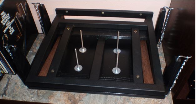

Fig. 5 - Lower swing platform - bottom view.  Inset shows the crude but effective attachment of the pendulum chain lower anchor u-bolts.  U-bolts were bent slightly in the upward direction to make a more localized spot for chain ends to settle.
Fig. 6 - Lower swing platform in place.  Each pendulum chain assy has a small turnbuckle, allowing leveling and relative tension adjustments once the full load is in place.  Coming up from the platform are threaded rods that will be used to help attach the upper platform.

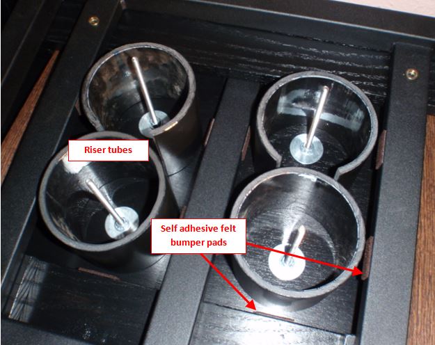

Fig. 7 - Riser tubes and bumpers in place.  ABS plumbing (sewer) pipe was used.  Tubes were cut to uniform length with a miter saw blade clamped on wood blocks at the desired height off of a table top.  Space available meant 2 tubes needed to be cut into C-sections.
Fig. 8 - Completed assembly, minus turntable.   Riser tubes place upper swing platform about 1/4 inch above TT-1 frame.  Threaded rod tops poke up into available space in bottom of turntable.
Fig. 9 - Straight face/plan view of completed stack-up.
If you'll give me some time to catch my breath, I'll write up some notes on how I measure audio feedback levels and talk about what this rig does in that area.  (It is keeping me real happy - and even dancing around once in awhile!)
Cheers,  John
