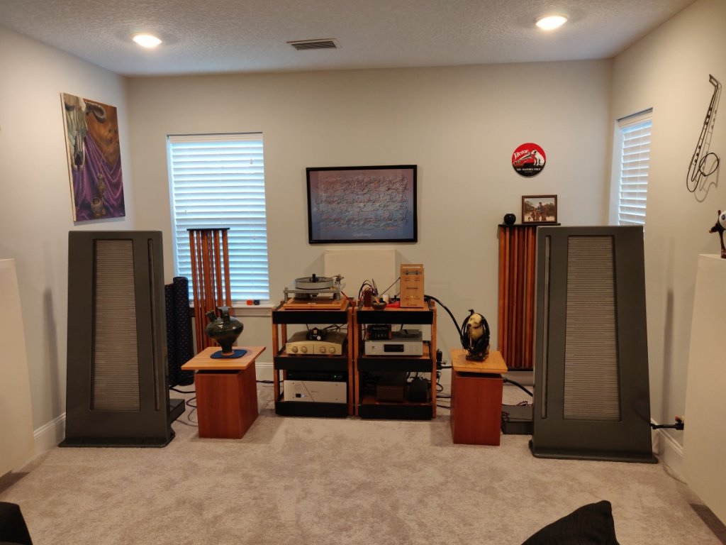

I went with 2 different ideas. I made my shelving unit with 3 boxes, each filled with 50lbs of sand, and floated a maple butcher block on the sand. So my shelves are all seismic sinks. Yes, mass, mass, mass, but this alone did not, I repeat, did not solve a bouncy floor issue. You need some kind of suspension to achieve that.
I then got another butcher block from Ikea and put squash balls under it. Now, my TT is very heavy so I did not cut them in half. I also needed more than one on each corner. I used 9 of them, concentrating more under the motor pod where much of the weight sits. Over time the balls crunched down and now look like flattened pucks but still do the job admirably.
Zoom in and you will see what I am talking about.

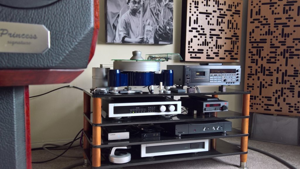

My motor is a separate unit, attached is a pic i had on my phone you can just see what i am talking about.
mick wolfe
  • Posts: 1381
Re: Turntable Isolation Platform
« Reply #28 on: 29 Jul 2021, 04:12 pm »
Beautiful turntable and set-up. Very tight but doable I think  :scratch: This in regard to a turntable base or separate turntable and motor base platforms.

Thanks mick wolfe I am using short belts, I could also use longer belts. With the short belts I will be able to use a large base instead of multiple bases if i use long belts.
