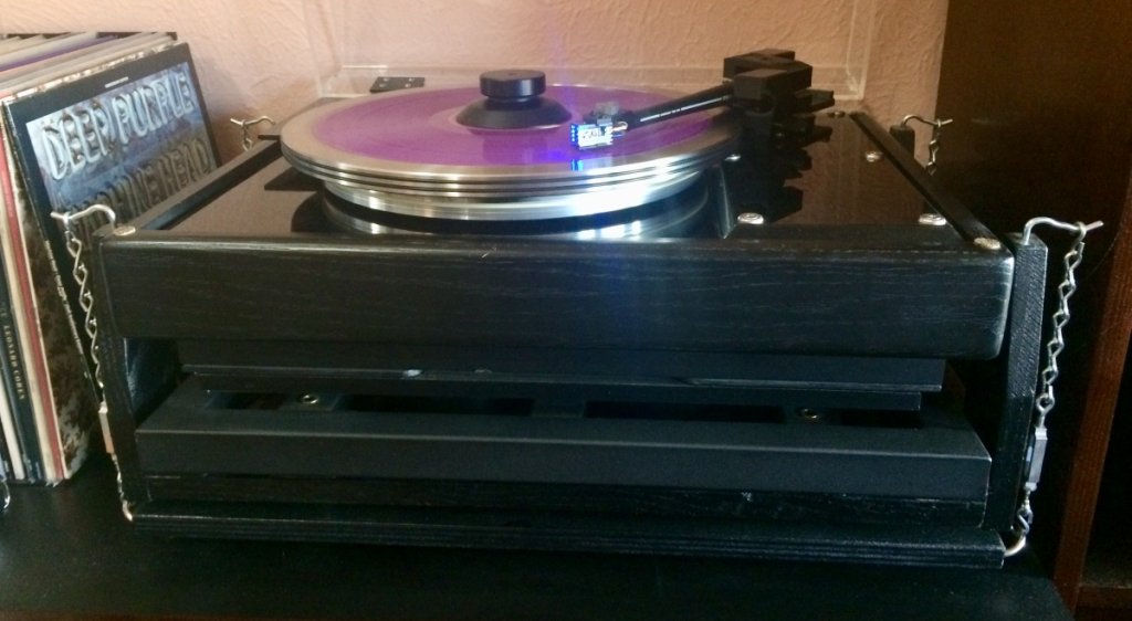

I bought this 10 years ago form the late John Evanthes TheChairGuy. Was a stock HW-19 Mk III. Gradually changed things out, dustcover, Super Platter, JMW 10.5 tonearm with adjustable base, SDS, SAMA, periphery ring, counterweight, CounterIntuitive, Sound Smith Zephyr. But I never dialed it in fully. I did not like the oak base, everything in my system is black, so I bought a donor table HW-19 Jr. I hope to post progress from time to time, chime in if you have suggestions!

The "donor" HW19 Jr is so nice I decided to set it up in my mad scientist audio workroom. I have transferred it to the oak base and the black base from the Jr will go to the big rig HW19 soon. It came with a VPI version Dynavector DV20X2 that had a lot of hours; I sent that cartridge to SoundSmith for retipping. I bought a few AT440MLa a few years back on the advice of Wayner so I installed one and it sounds pretty darn good already.

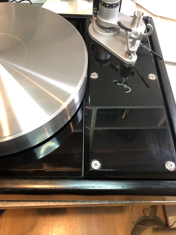

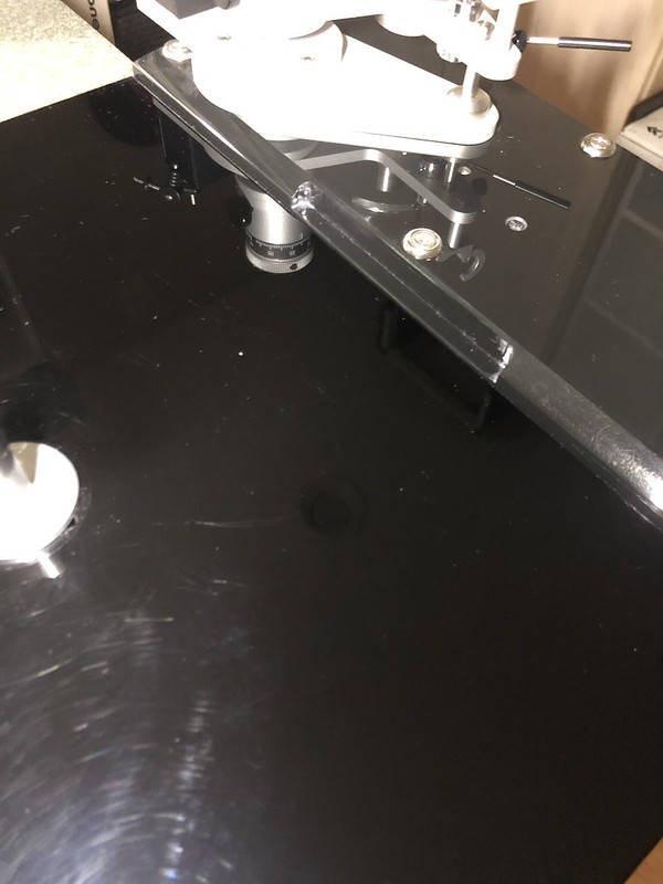

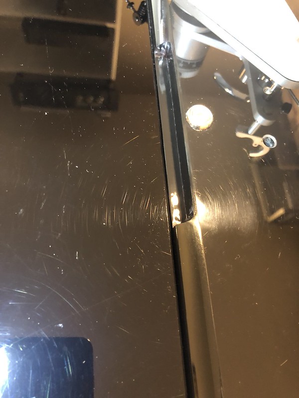

My Super Platter compromise. I used a Super Board, the 2" platter needed a higher mount for the tonearm. BUT the platter would not clear the inner edge of the board. So I used a router to cut a channel in the board.
Paul
