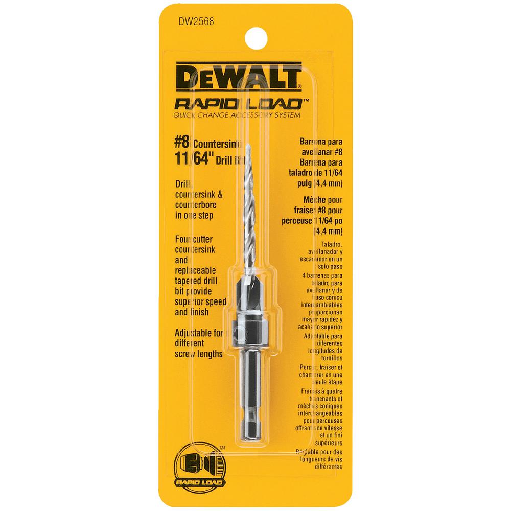

"I want to do a very low-end build, mostly as a fun project over the holidays with my teenager. Going to buy a kit with pre-cut flats. "Ok, you told us what you want to do. Everyone is telling you to pick up some cheap clamps. You want to have it be successful and be a positive experience with your kid. 98% probability the cabinet is MDF, which will likely split when you try to screw into the ends or close to an edge. You'd have a much greater chance of success by hammering in finishing nails into pre drilled holes. Or buy fifteen bucks worth of cheap Harbor Freight clamps as suggested and glue it up in stages. Or not.

If I screw everything together when gluing is that enough?
