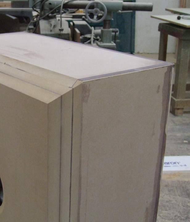

1) First: round all the box corners, even the small ones, with a triangular or L shape profile of wood or MDF. Alternatively can be used that soft massa/dough of caulk, avoid plastic or metal parts here.

Another economic tip:  Use 3 feet(not 4) to support the enclousure on the floor or stand.
  • Posts: 21429
Re: How Treat Passively Peaky Fullrange Drivers
« Reply #18 on: 20 Nov 2011, 11:56 pm »

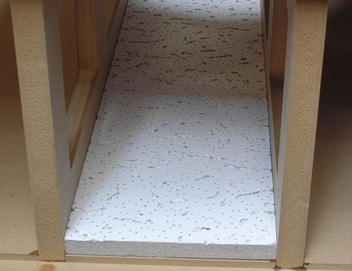

A great tip from ERIKB1971:  Make random craters inside the enclosure as the image below.
Æ
  • Posts: 859
« Reply #19 on: 21 Nov 2011, 01:31 am »
A lot of hard work . . . .
An even easier way would be to install acoustical ceiling tile inside the enclosure.
